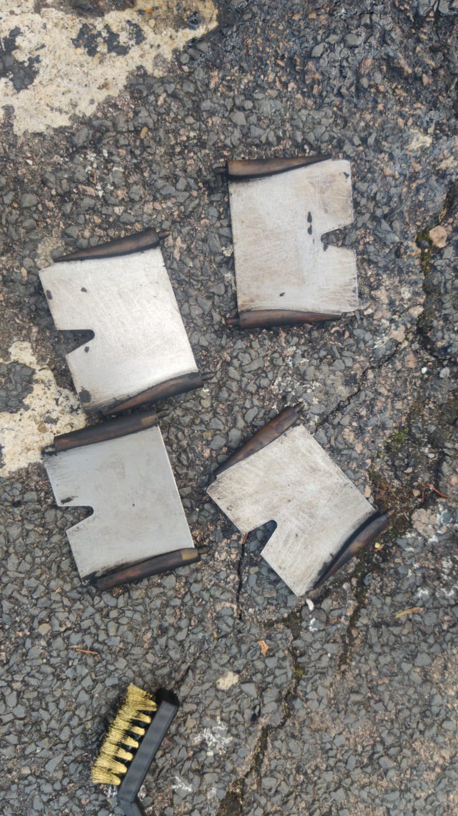

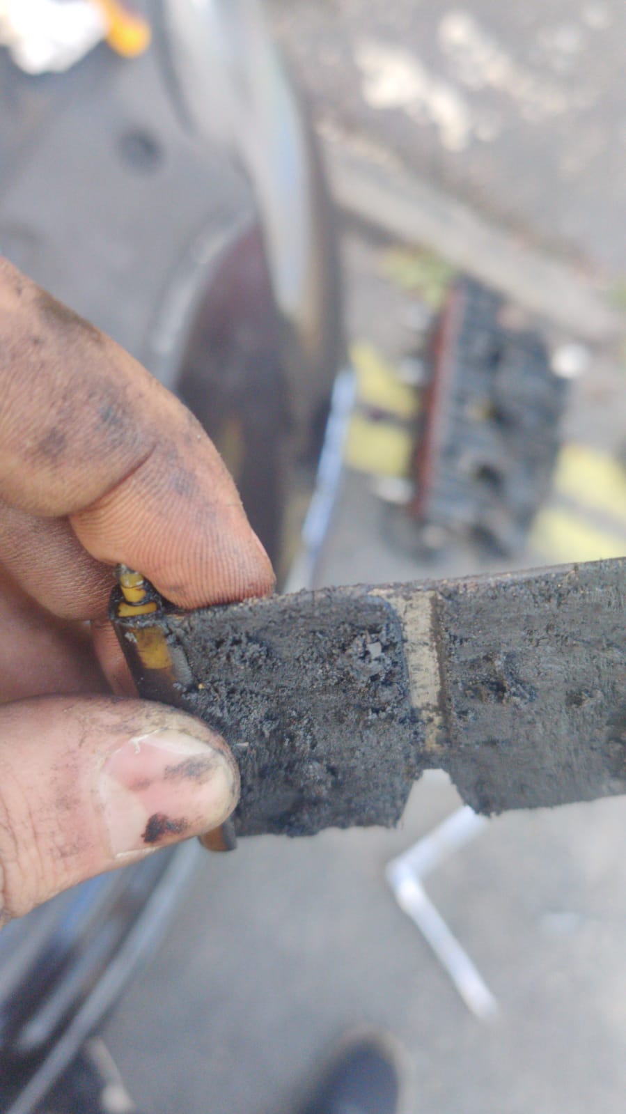

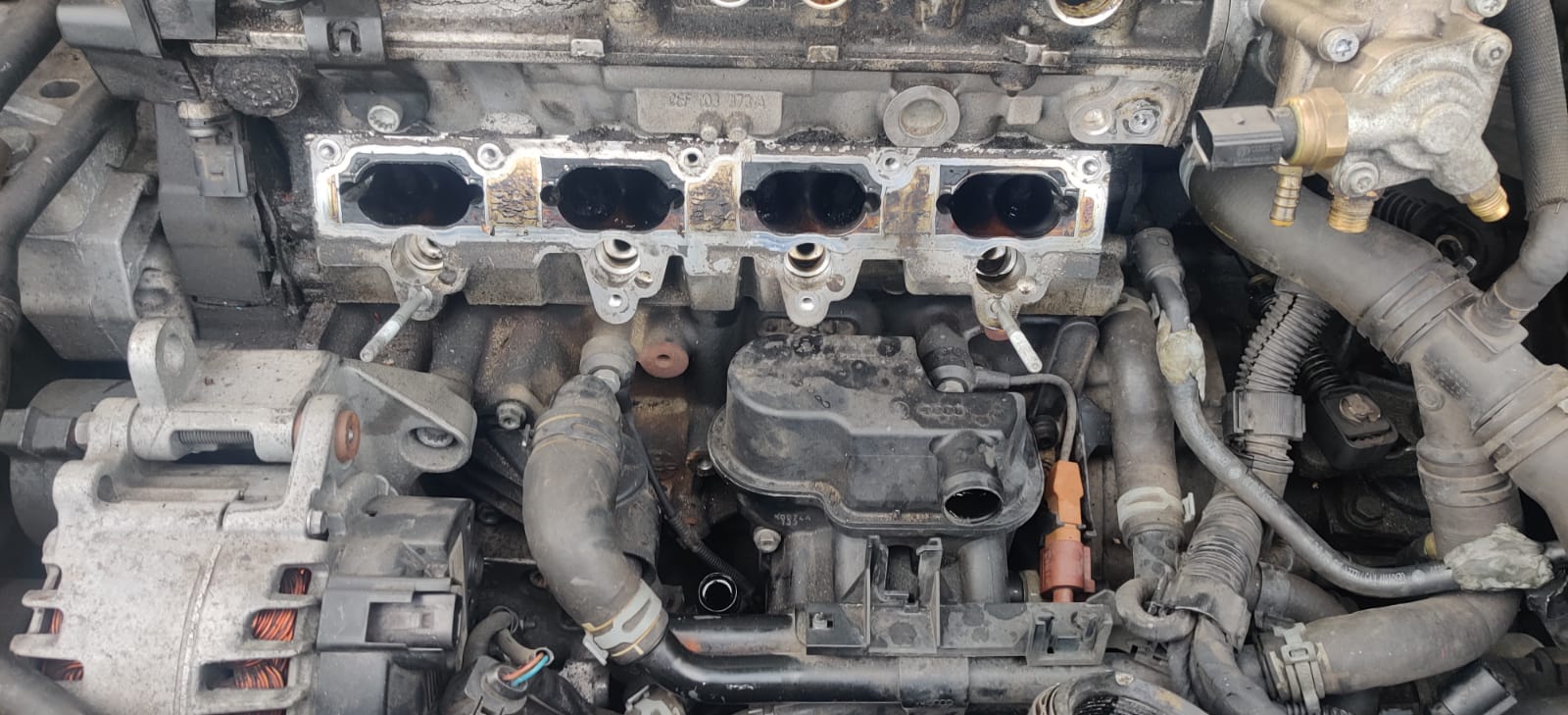

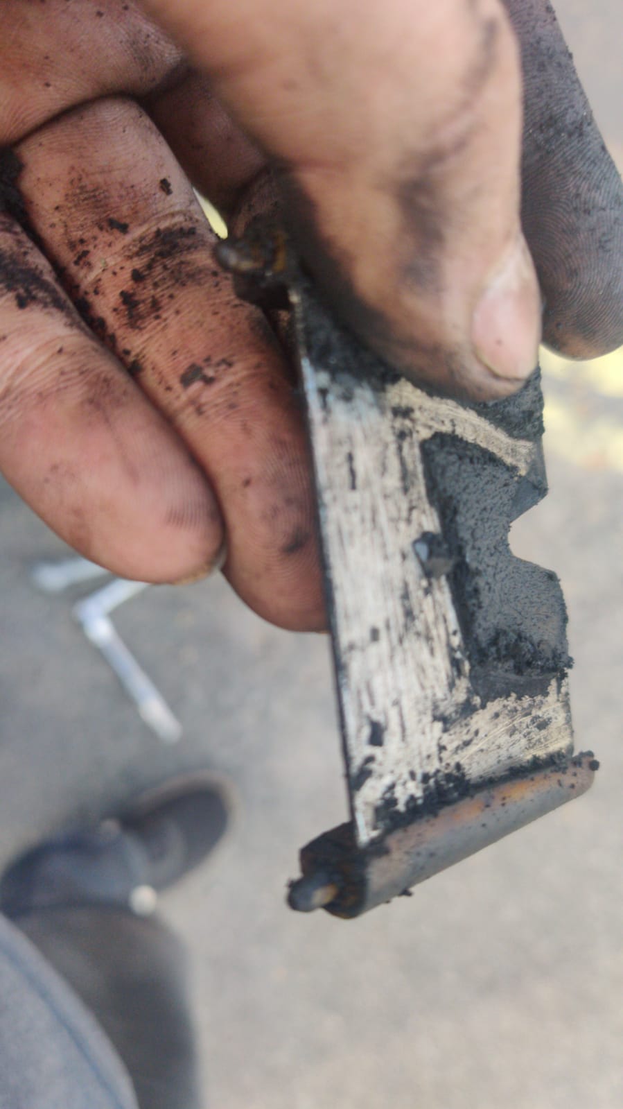

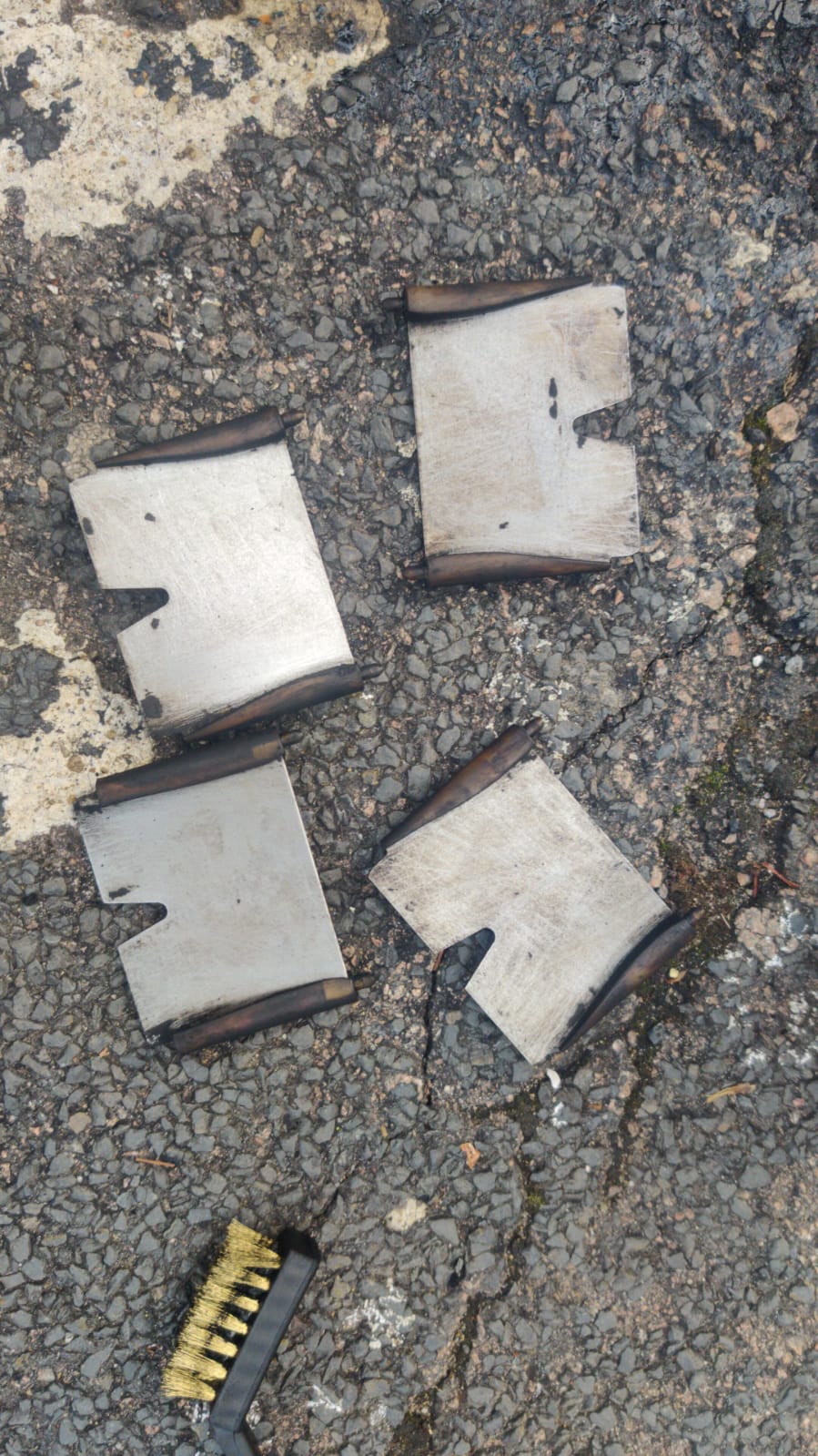

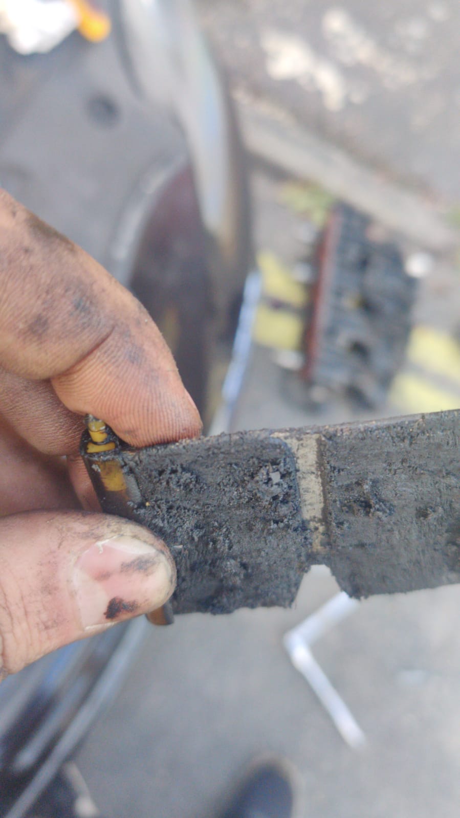

Thought i'd post back in case anyone else is having similar trouble or similar issues, in the end it was a leaky injector and also a mix of carbon buildup
After cleaning the carbon with a pick, wire brush, some carb cleaner and replacing the injector. Car runs good as new, thanks for all the previous replies.
View attachment 18635 View attachment 18636 View attachment 18637 View attachment 18638
PS: Yes I know I need to replace the hose to the vacuum pump
