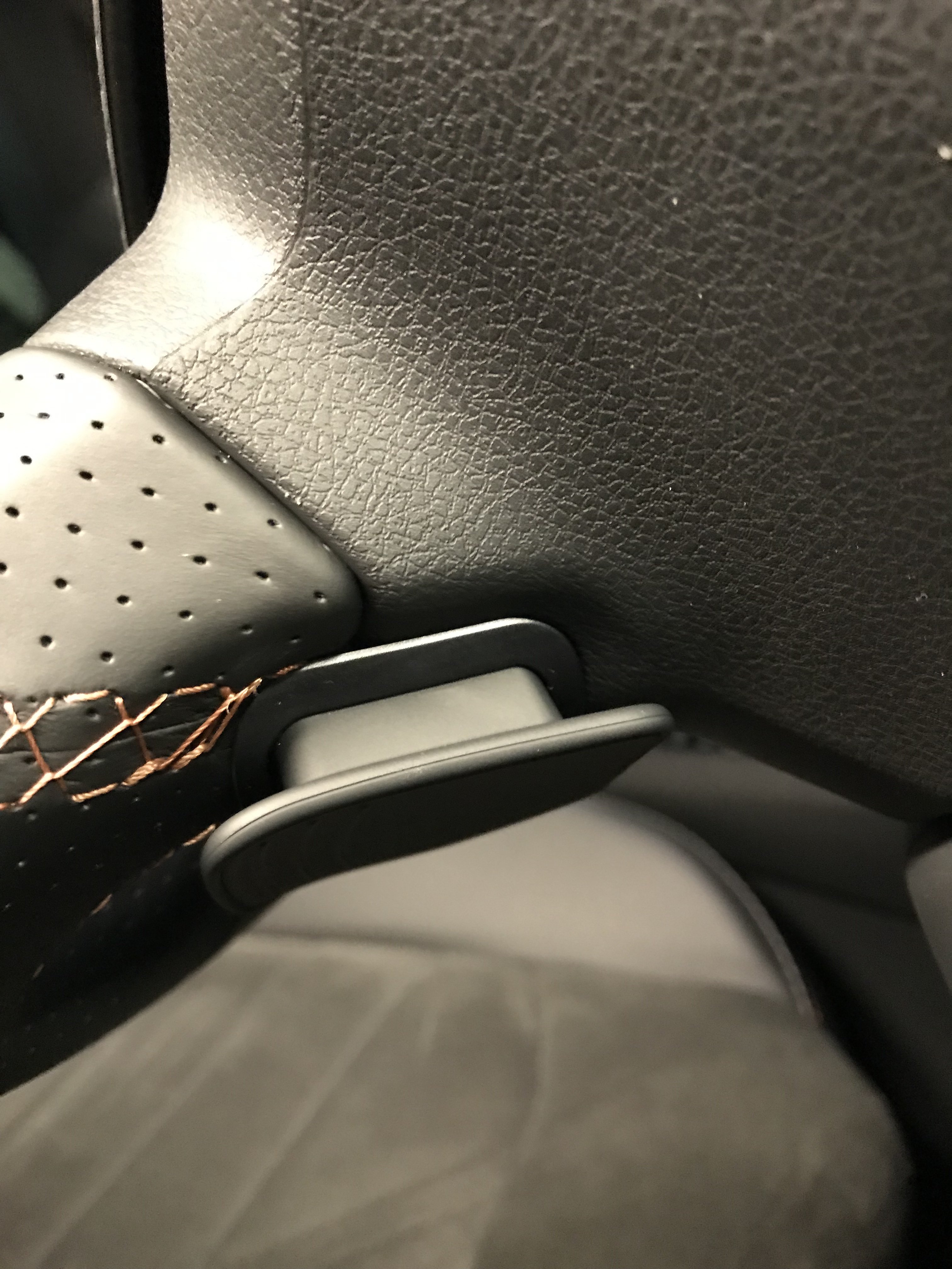

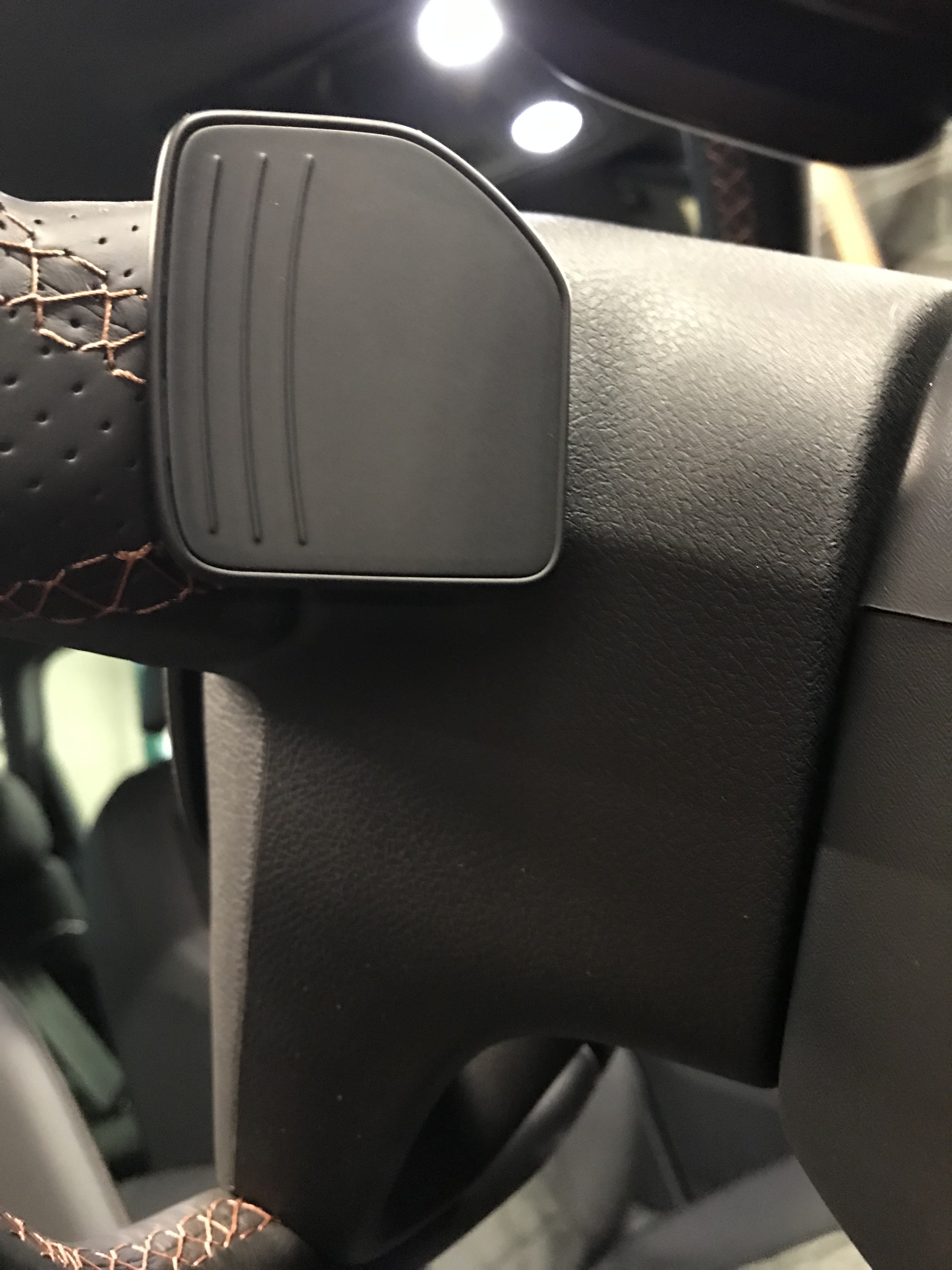

As it’s been a few months you’ve maybe already discovered this but the vwr paddles don’t fit. I changed from a mk7 r today and was hoping I could just move them to the Ateca but the paddles on the Ateca don’t have the plastic pin to disconnect/reconnect like the golf.
Have you got a couple of photos of them?
Are they the same as the ones in the Leon Cupra?
I'm currently working on some replacements (like the VWR ones) for the Leon Cupra, so they may fit the Ateca
1426F1F8-FBE1-4262-A81A-F28FBBE84A08.jpeg 6CAD5B0E-775F-4E59-8644-74AEA74A3675.jpeg
From other pictures I’ve seen I think they’re the same as the Leon. Definitely interested in an equivalent to the vwr paddles, I wasn’t sure about them before I ordered but they massively increased my engagement with the dsg box.
