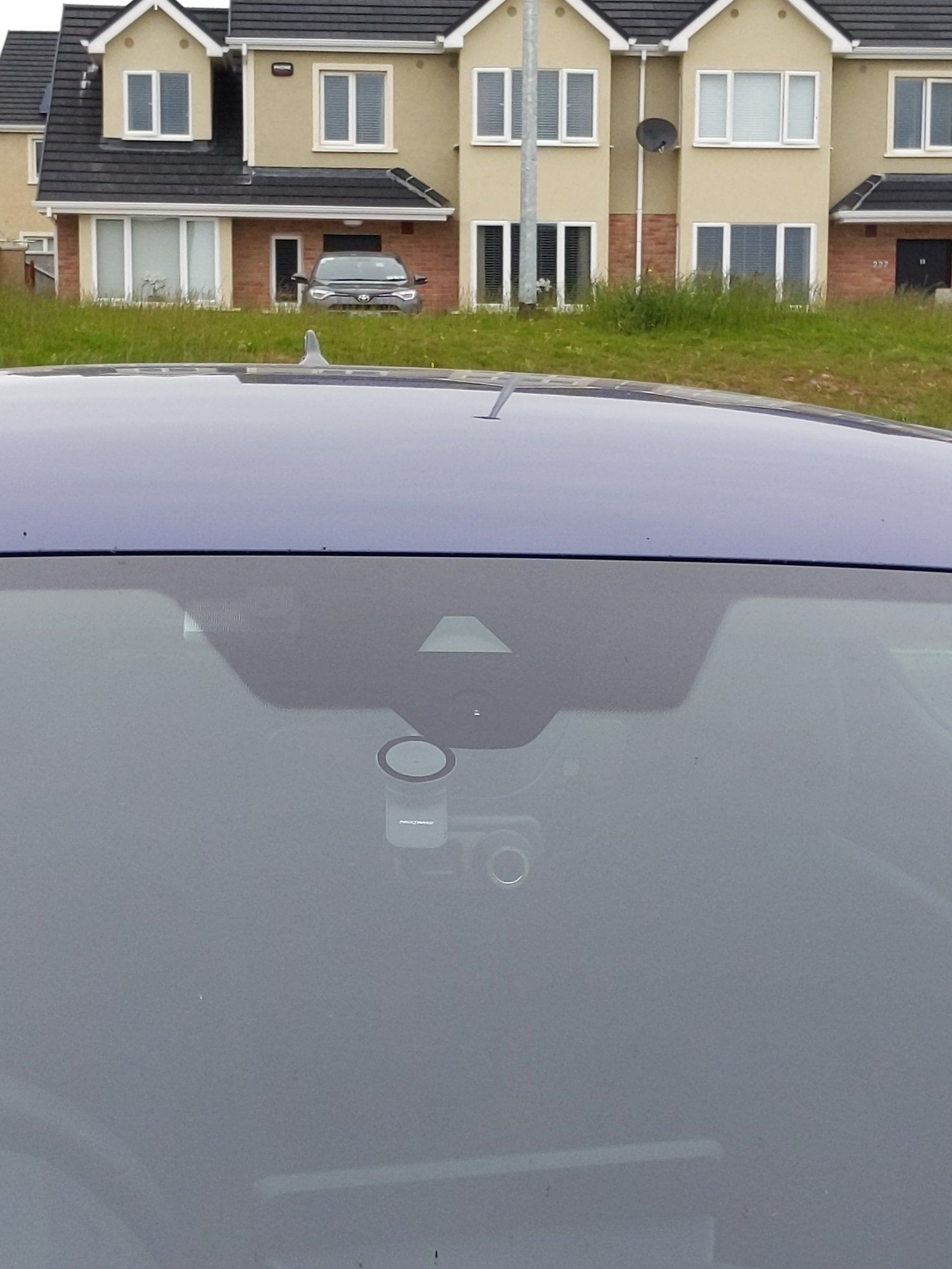

Bit of Obdeleven Pro code from the Tarraco side but non SFD... could be tried out:I just wish you could turn off lane departure as a default, having an invisible hand grab the wheel in the middle of a sharp corner or jerk the wheel toward incoming traffic is very distracting!
