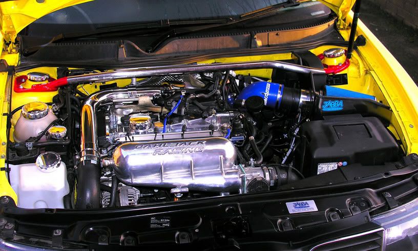

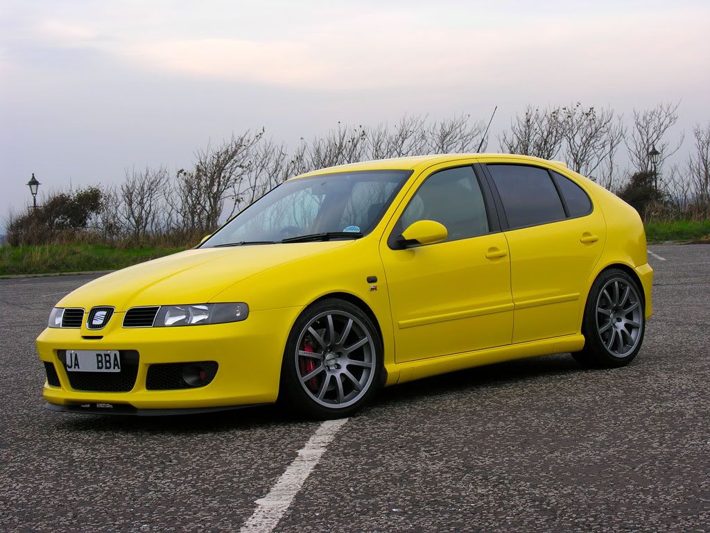

Some Pics as promised of songmans beast. [:@] :p

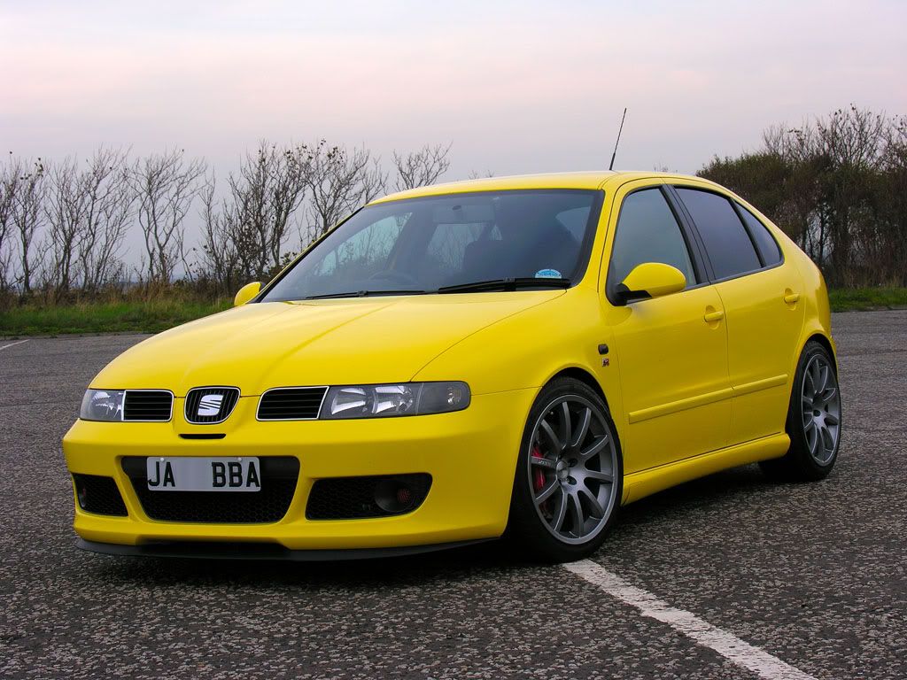

ibizacupra said:
whats with the JA BBA plate....
you a fan now? :)
Ah Ha Bill!! - the plate is a lot older than the car, because I have been waiting
-----Sooooooo lonnnnngggg :whistle: :sleepy:
Did Mike never tell you about the insane dishevelled Scotsman who was living rough out on the flatlands at night :hide: and picketing his doorstep by day :dance: -these last long long years!!
I bough it `in hope` you could say - Just a finishing touch , as it was the first LCR they had done - not the first Leon however, but I don`t think the owner of that car contributes to Cupranet
Anyway, the plate serves to intrigue and impress - err well impress - the locals :-o :scary: as it disappears into the distance :)

Love the polished Dahlback manifold, blue Samco on your intercooler pipe to match the turbo hose would finish it off! Looks great and goes even better - top job by yourself and Jabba, boys know their stuff alright!

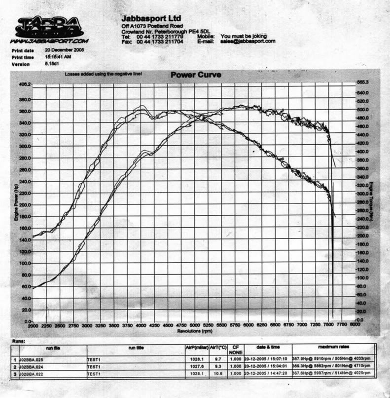

Just read through this thread and looks like a very impressive motor. Glad you also covered all the options as you still hear the odd horror story of things not holding up as well as they should be. Long wait for it all to happen but well worth it in the end and looking the IHI is only a very small part of whats really been done.
Figures are impressive to look at but as already said just wait for dryer conditions and stickier roads so you can maximise the full potential you now have in the car.

Great figures there songman... I saw your car on lifts at Jabba over xmas - when I saw the porsche brakes, I thought there'd be something special under there!

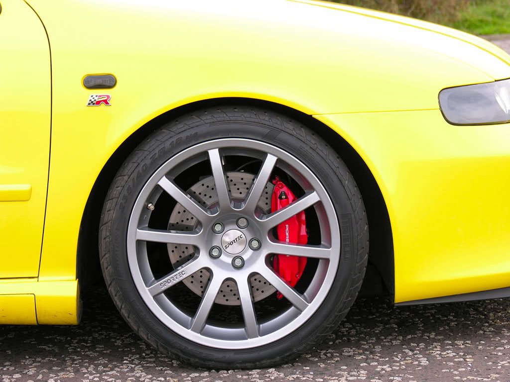

Empi5 said:
Fantastic looking car mate, can i just ask about your suspension set up. More importantly do you have any spacers fitted ?
EDIT: Just looked back through the post, noticed its 6mm integral spacers ! Looks like thats the way forward
We used Eibach Pro-Sport coilovers dropped 20mm from standard - this is about as low as I would like to go for the road - problems getting on dealers ramps etc, the splitter gets a hard time over `humps`and sometimes there`s contact with inner wings at speed on poor surfaces
The setup is quite hard around town at speeds appropriate to that - the Corsas have very stiff sidewalls - but once playtime comes then it all settles down very nicely and feels very much more planted than the standard kit
The handling is pretty neutral - with Eibach rear ARB and Eibach front ARB set to softest setting - the diff is great and a must for BT car as are the suspension changes - of course with so much power things can get - err `mental` - and the greatest traction aid is a sensitive right foot - mind you JABBAS vari - boost is an extremely handy, natty little device, and great fun into the bargin!!
The Sportecs 8.5/18 wil fit over the standard R Brembos without the need for spacers - the Porsche Brembos are much bigger and need ~6mm spacers - Sportec do integral 10mm spacers which attach with 3 countersunk machine screws to the hub face of the wheel - very secure and no wobbles - I had them machined down to 6mm and with the 235/40/18 on 8.5 rims the setup is right on the limit of the standard wheel arches:)
