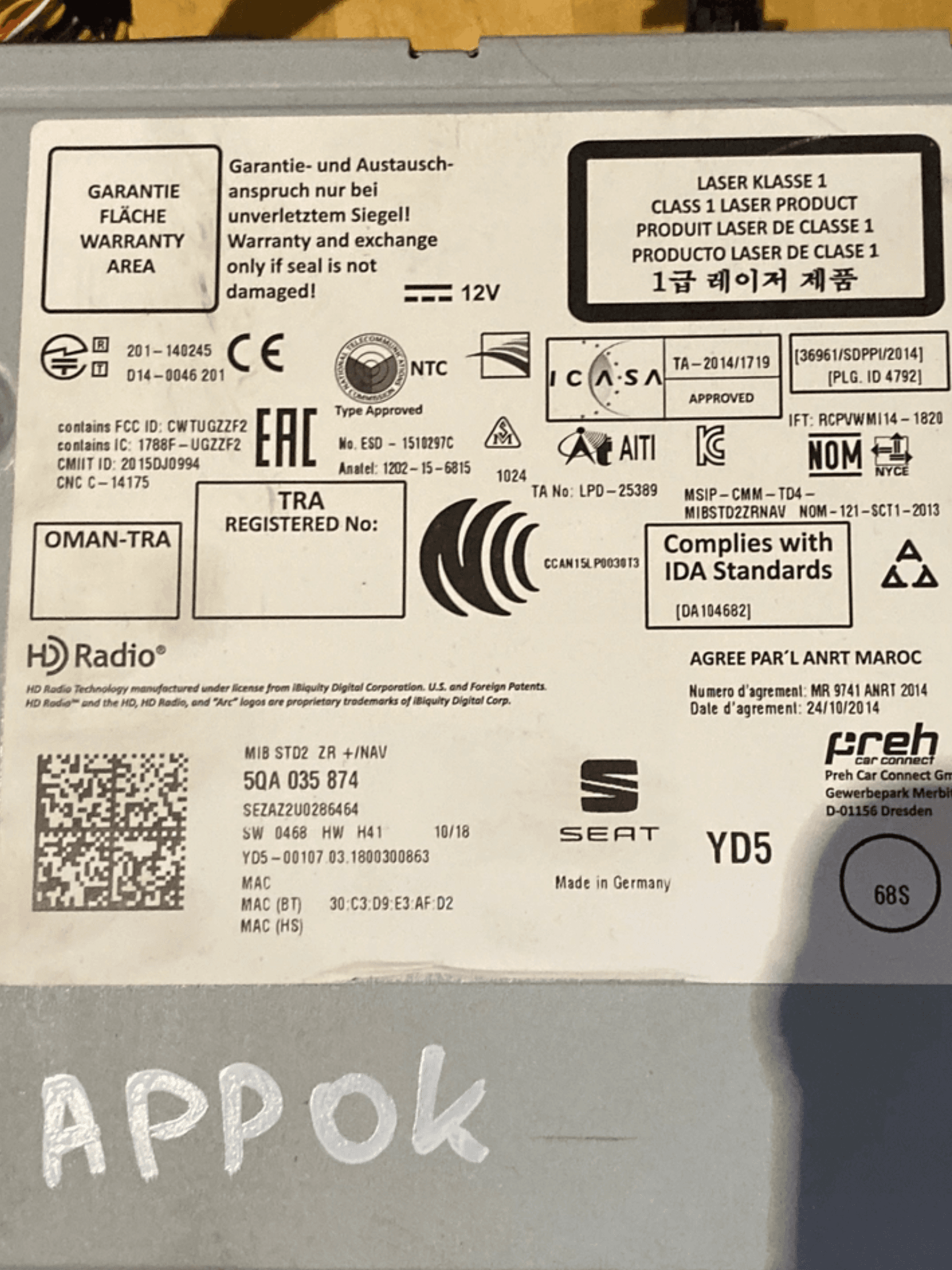

@Tell is this model number really a Seat Navi Plus?
That's where you follow the mib2 standard / High (Seat Plus test) under
How do I know which unit I have ?:
Press the “NAV” Button >
Confirm the “Setup” >
“Version information” selection on the display.
Check the first text line in "Version information".
If the first three digits are 6P0 it's a mib2 standard (serial number is also on the card)
5F with a mapping card in the slot it's mib1 standard
If not it's a mib1 or 2 "Navi System Plus" (no card in the slot)
2018 it's mib2 not mib1.
Alternative test is to press the the media button if not Jukebox is shown as a source its a mib2 standard.

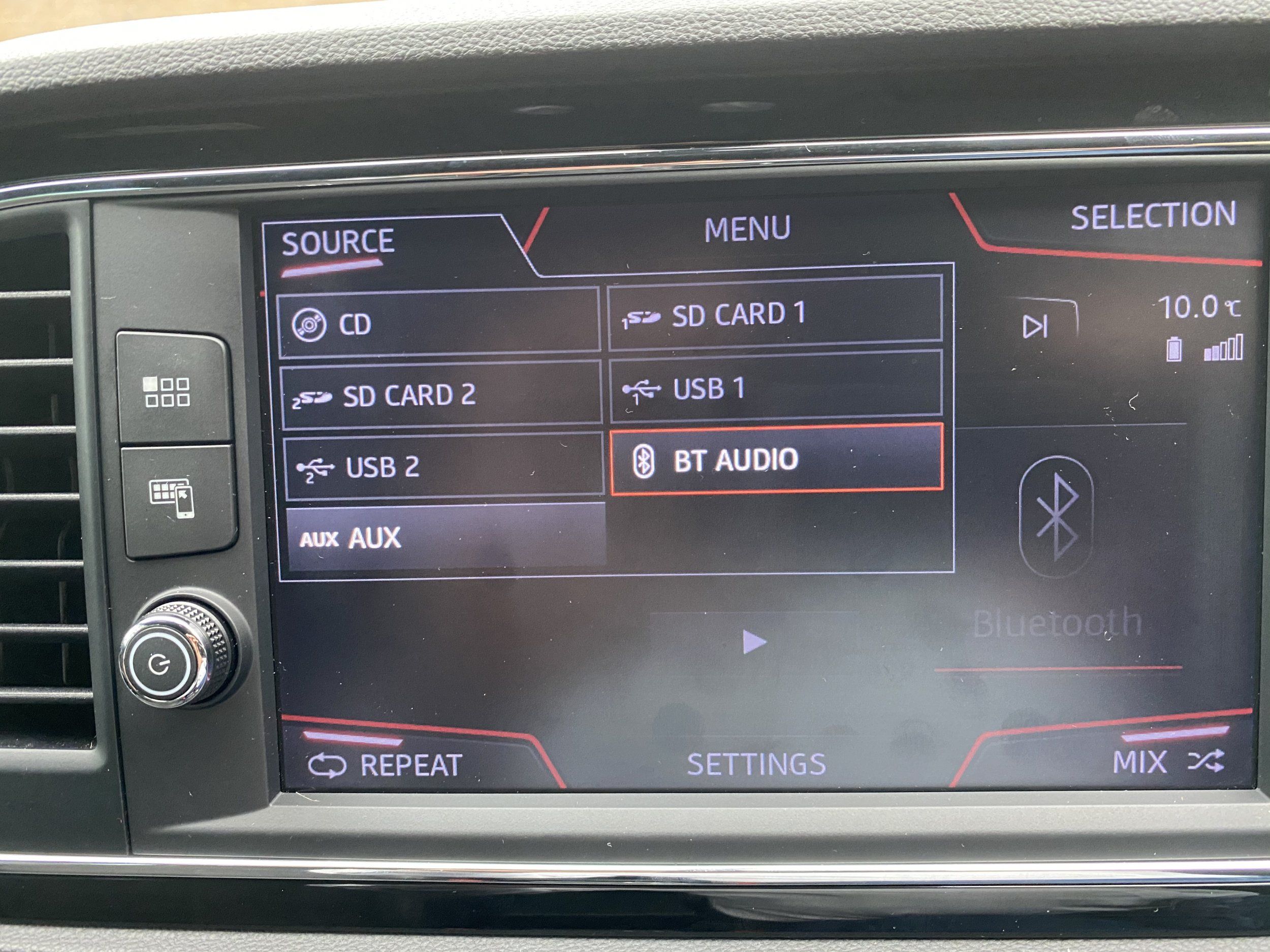

I think I can confirm it’s the std because there is no jukebox option on the media menu.
Definitely a standard.
