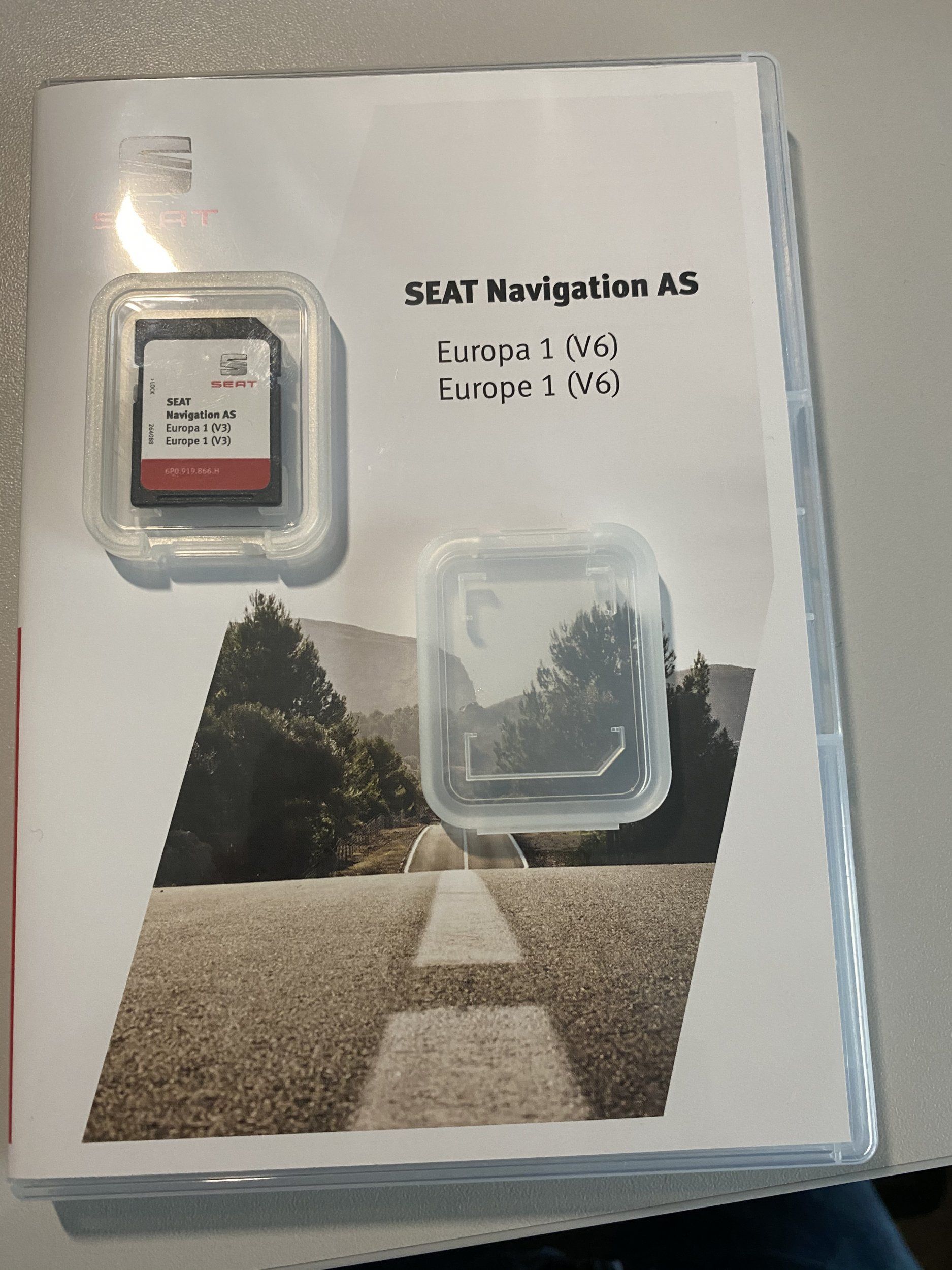

So final and positive update. Turns out the dealer was being honest about sending an SD card a couple of weeks ago. A few days ago I got a note through the letterbox from Royal Mail to say an underpaid item was waiting for me and I need to pay £1.50 to get it. Normally I ignore these as they turn out to be junk but decided to pay up and take a chance. Today an underpaid envelope arrived with a Europa 1(V3) card in it. Funny thing was also in today’s delivery was a brand new boxed Europa 1 (V6) card!
Thought I’d try the older card first and turns out it worked. Then I tried the V6 card and that works straight out of the box also! Not sure why but there does not seem to be any “pairing” with the cards so they were both plug and play which is awesome! Thanks for all the advice but turns out I didn’t need to do anything and will only need to play around if I want more up to date maps.

What it means is the unit was paired with V6 or something above.
Anyhow you take a copy of that V6 card. That's your overall.nds file in that. You can then use the V3 card as the one for your update following the workaround or even the overall.nds file on that card it doesn't matter. Then follow the workaround method to get to the latest update. Lucky you, you got two cards :). It does have it's uses to try out the updates. Just remember to do the long press on the on/off button to put a reboot in between changing cards so it re-reads all the card rather than a hot boot. Think if you left it 20 minutes you would get a cold boot in any case but if you have two cards there is a danger that you would alter the card put it in etc. Good practice to do that reboot.
