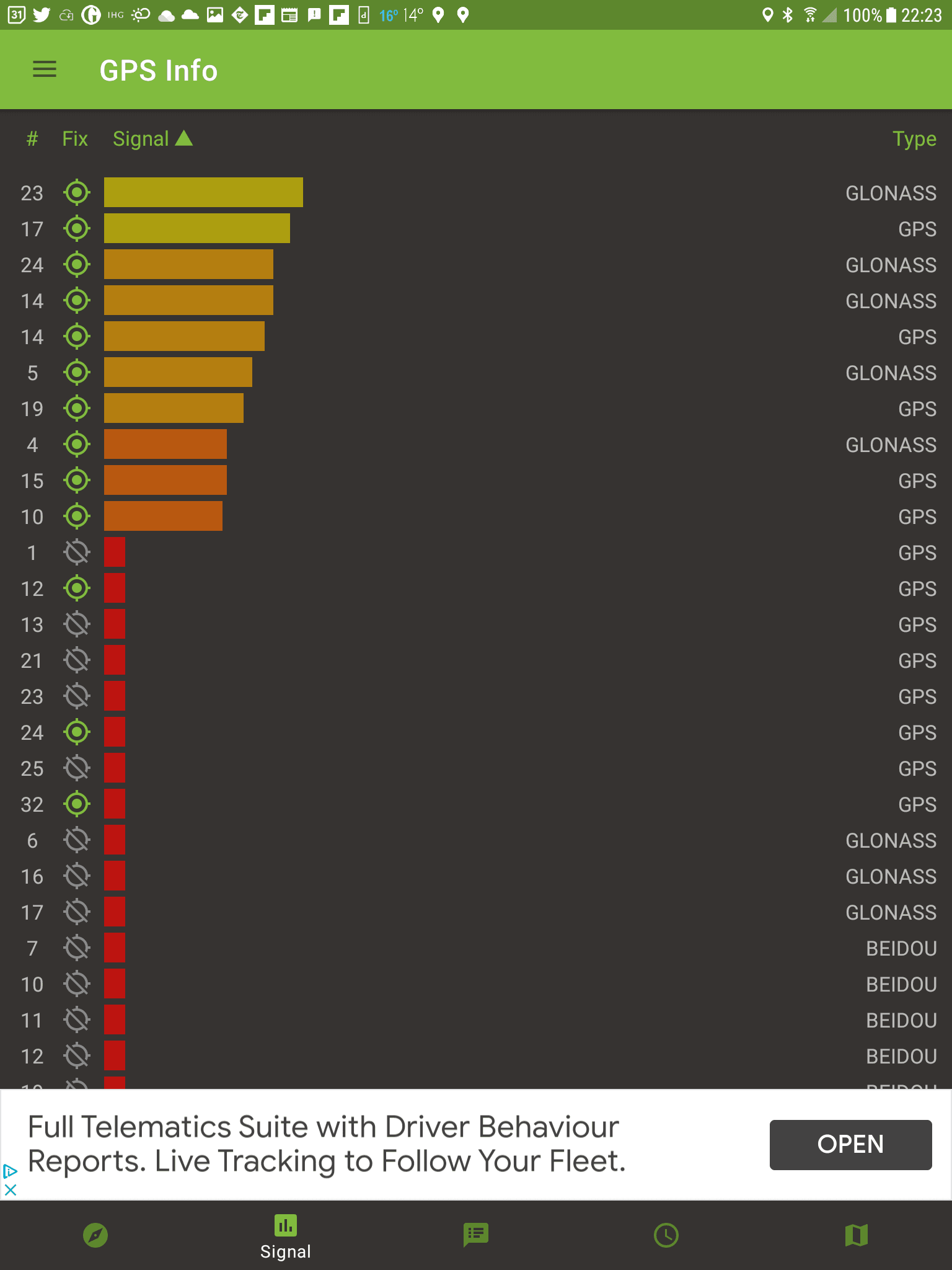

Well there are issues with the Mib3 infotainment so perhaps nothing surprises. Mib2 high is rock solid whilst adjoints to the system just show where the phone thinks it is. Mib2 high goes thru a learning process to match the car to the road. You see that after you have been messing with the software, it resets the calibration, after you take it for a drive it recalibrates itself. Don't think Mib2 standard does that, often tells you to turn off a roundabout after you have done it, although that could be inaccurate TomTom maps on Mib2 standard verses the Here Maps one on Mib2 High.
Pass on why it's plonking your Apple navigation off map whilst connected. Feels like you are loosing some of the navigation signal of the phone whilst connected so you see that error, why I don't like external navigation in towns since the accuracy of GPS bounces about. The internal car ones don't since they are tethered to the road until you hit a bit of undigitised road and they have to relock back via the calibration, least in mib2 high.
If you got one of those apps on your Apple phone like the Android GPS Test and GPS Info... suspect you are looking at less satellites so it pushing you off map... quite a way thou 😉.
Example output indoors with those apps... reckon you need something similar on your Apple to study whether you are getting a signal loss plugged in and not plugged. That would isolate whether the phone is getting a poorer signal in situ when connected v not.

I would not think it's that clever. The privacy setting is to stop the cars details being shared with VAG services. CarPlay uses the phones GPS I'm sure like Android Auto it just projects the screen onto the car's system. Saying that being burried down in the car the signal will be weaker unless it jumps... They do, do that around the cars charger mat on the cellophone signal. Hence why I was saying test the signal strength and number of locked on satellites on the phone. This is the other thread I was being sucked into.
