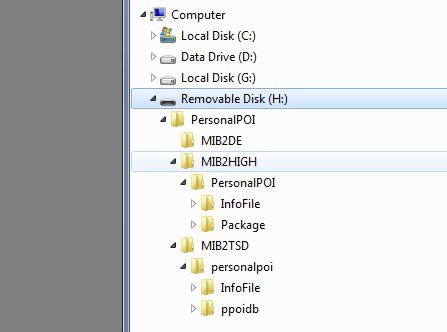

Tell, currently I have a database of POIs in an Excel spreadsheet. If I try the POI import, what format do I need it to be in, and where do I find the destinations folder?

I use Poinspector
Export your sheet as comma separated, txt, I rename to Asc then add anything else using the Notepad editor, don't have the quote marks in. That's how I get my destinations in which I want to use often, the ones I ported from Co-pilot originally when I got the car and stopped using Co-pilot. I list the format of them in that link, those ten records... so that's your starter. If you want them to beep, treat them as speed cameras. That toggle is shown on the link.
Note VAG uses the x,y coordinates in reverse from normal form (mention that in the documentation). Basically Poinspector was written by Radas the programmer when VAG pulled the previous RNS web based poi import. They did that again with mib2 several years back so he modified it to take in mib2, covers mib1 and the old RNS model.
The VAG import file is a cross between hash check file and database file. That was worked out by people as to how to format looking at the ones the VW website created.
In the example in the link I provide some test lines which you can try. You can use Poinspector for free to test upto a 100 POIs. Token charge of 10 Euros or something to unlock the program for life so it's pretty limit less on volumes of POIs, although VAG limit user Poi categories to 10 only that can be shown in mib2. I import my destination POIs as one category and four more as the speed cameras from the Pocket GPS World site. That allows you five others to show on the screen, the inbuilt ones. Petrol stations, car parks etc. The forum post show other people do different things.
Some careful attention has to go into setting up the proforma for Poinspector, sizing your icons etc. Once the proforma is set up you can routinely update the contents as required. Quite a few Seat Cupra people use it from the forum and across the VAG brand. I became Radas' unofficial technical author since the forum is listed as one of the documentation links. Basically it's a package distributed as an executable program. Not totally for the faint hearted but does the job. Once set up easy enough to use.

Hi
I used Poinspector to create a test database file and export it to an SD card but my system doesn't even seem to see the card. It just asks for a suitable source. Maybe I've got the file/directory structure wrong on the card - does this look correct?
