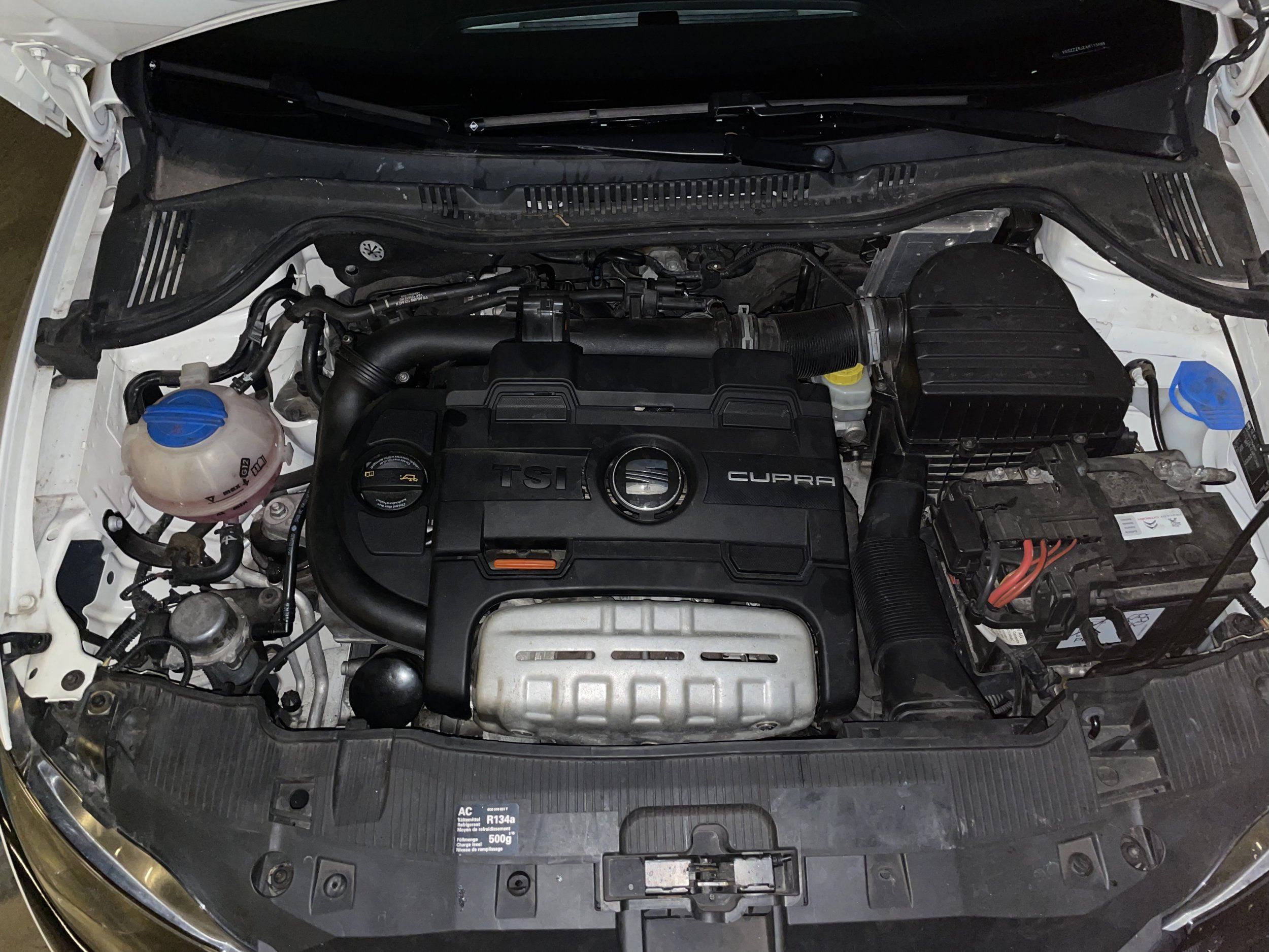

I am having trouble locating the coolant temperature sensor 2 in my bocanegra 2010 1.4tsi. The guy at seat couldn’t point out where it is so I am hoping this community can help me troubleshoot.
Sensor 1 was quite easy to spot on the right side of the engine near the battery.
By the way, the reason for trying to find it is, service engine light is on with code p2185. Unfortunately all other forums with this issue make reference to other engines and the sensor I am looking for is not in any of those locations.
A picture could really help
All your help is much appreciated.
thanks so much.

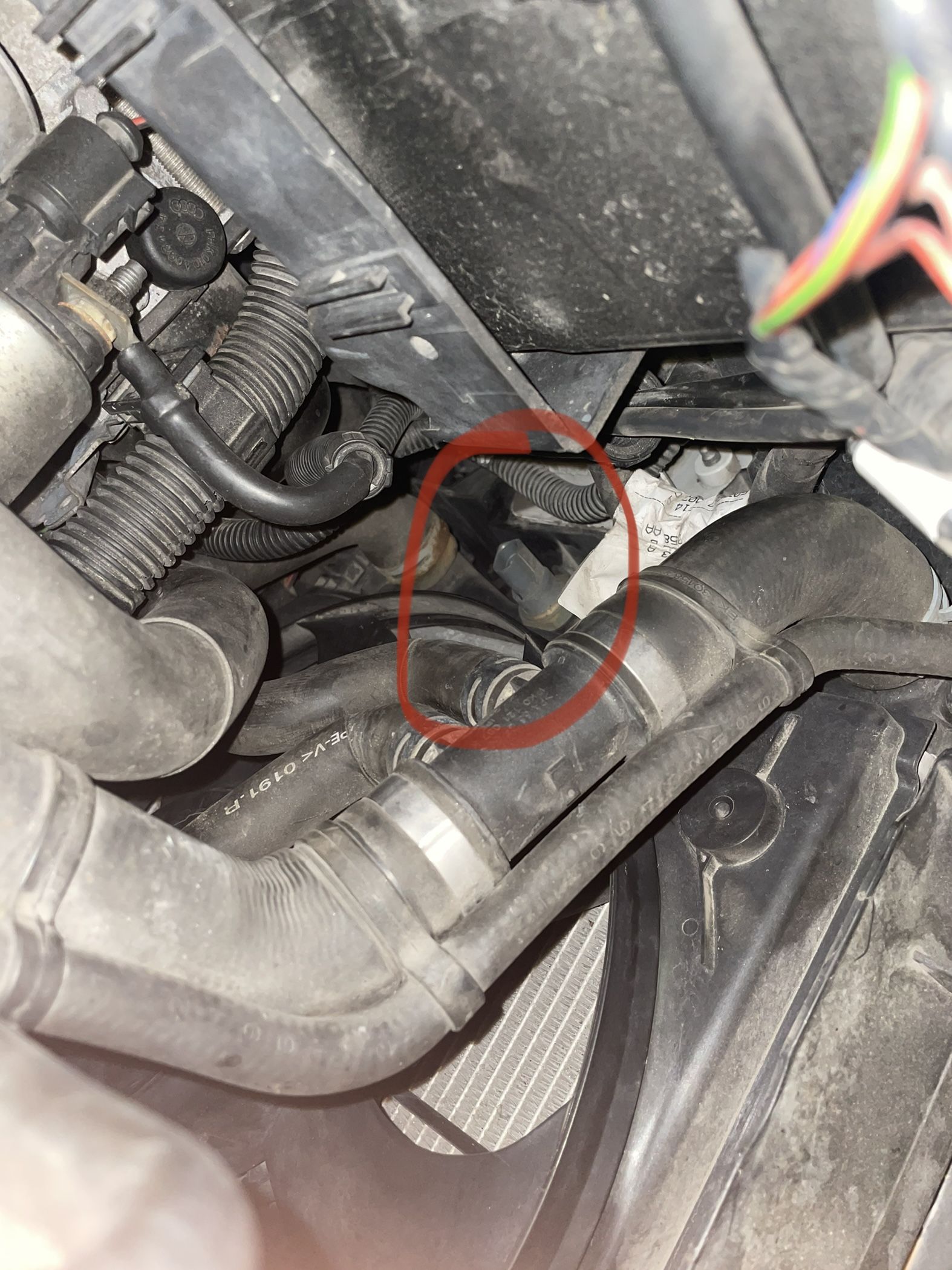

it’s towards the front of the car right next to the fan. I hat to take the manifold to be able to reach it. Hope this helps someone out there. All working fine for me now.
