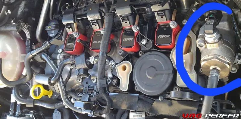

Check ur hpfp for any damage on the sensor any cracks or anything i reckon thats ur issue hpfp is high pressure fuel pump
So much as damge that sensor on top of it ull get ur symptoms ther like chocolate stay well away from them if ur workin on the engine i broke mine pushin my engine cover on glued it back together was fine while it was brike was miss firing epc light on aswell
