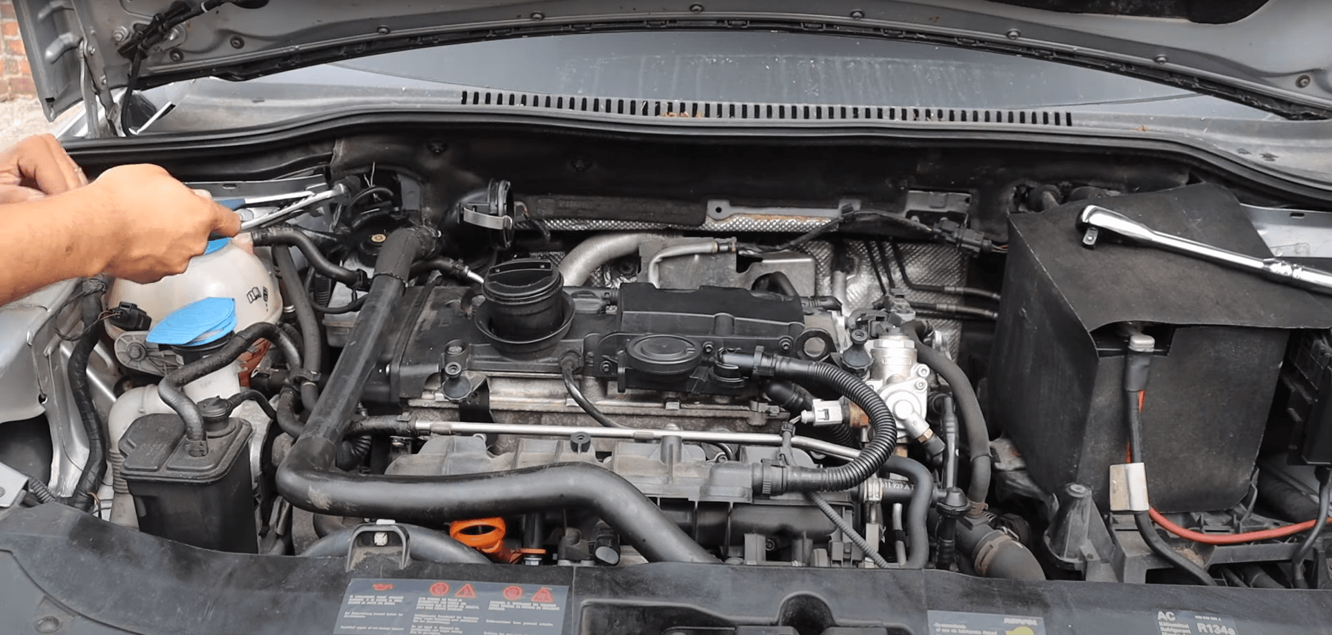

Hello everyone!

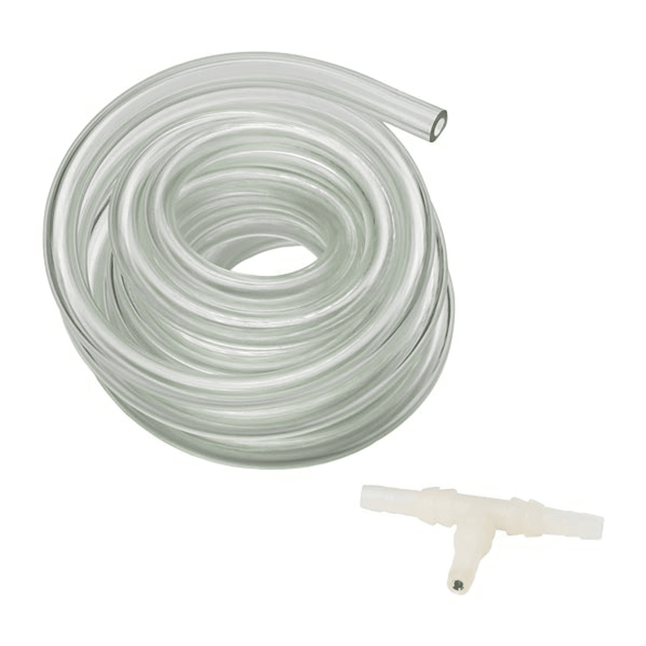

I bought, and wanted to instal a turbo gauge for my vehicle. It's already mounted and wired up. But im not sure where to connect the hose going to the pressure sensor . I wanted to ask where is the safest and the easiest place to connect to get the turbo pressure reading. Or you can tell where you connected it or where you would connect it yourself. I have a T shaped plastic piece and a transparent silicone pipe (picture) going from the sensor so I can cut thru existing hose and connect everything together. Ps. I have a Greddy gauge if somone wants to know.
Can you help me? I would be glad if somone can mark the connection place on photo of the engine bay of Seat Leon Cupra R 1P1. (photo example from the internet).
Apr 25, 2022
8
Pipe that goes to the N75 is probably a good bet
That is very good idea. I hope that I will manage to find it under the hood on this weekend ?. Thank you for advice. If anyone knows some other places you can also write it down here! Thanks in advance
