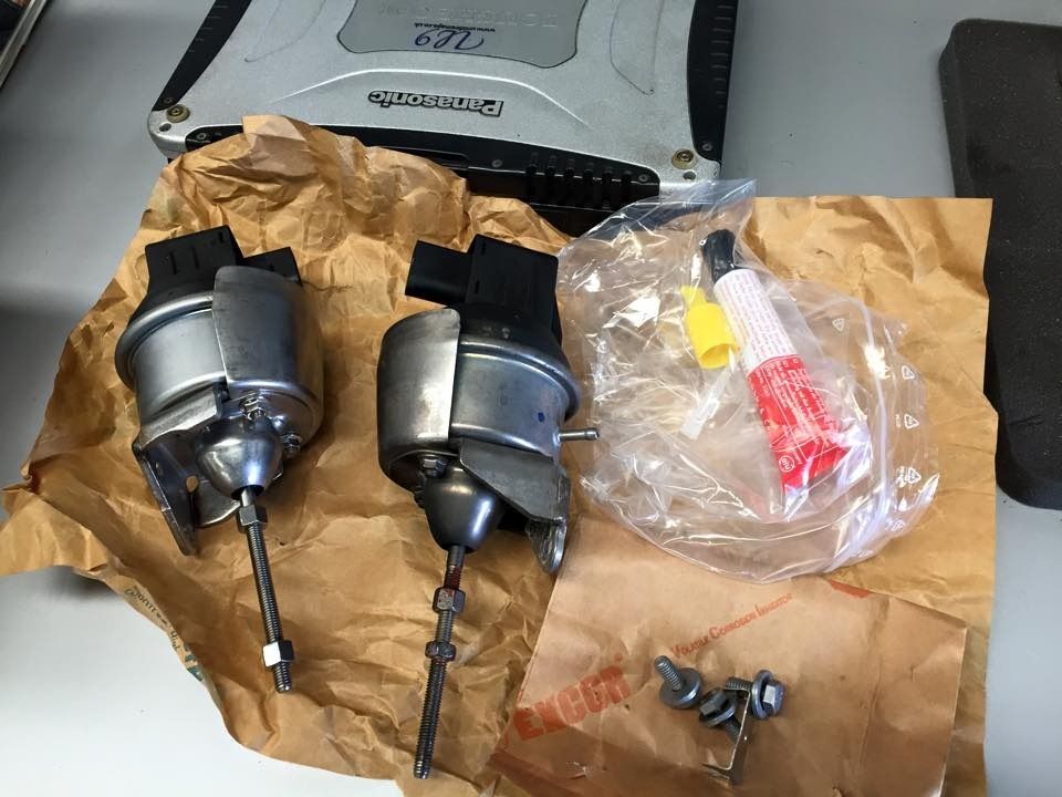

Ordered a new actuator to fit as getting the P0299 code, I've boost leak tested etc and had to be that. Seems as its not opening fast enough, loosing power low down etc.
