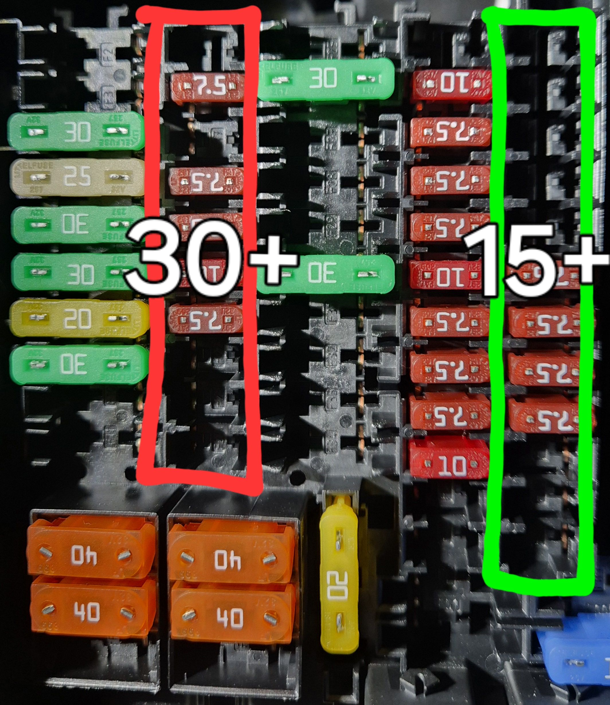

Which fuse box?
And doesn't that need somebody who knows what they are doing with the fuse box?
You'll need to plug your fuse tap into one of the vacant slots marked "15+".
