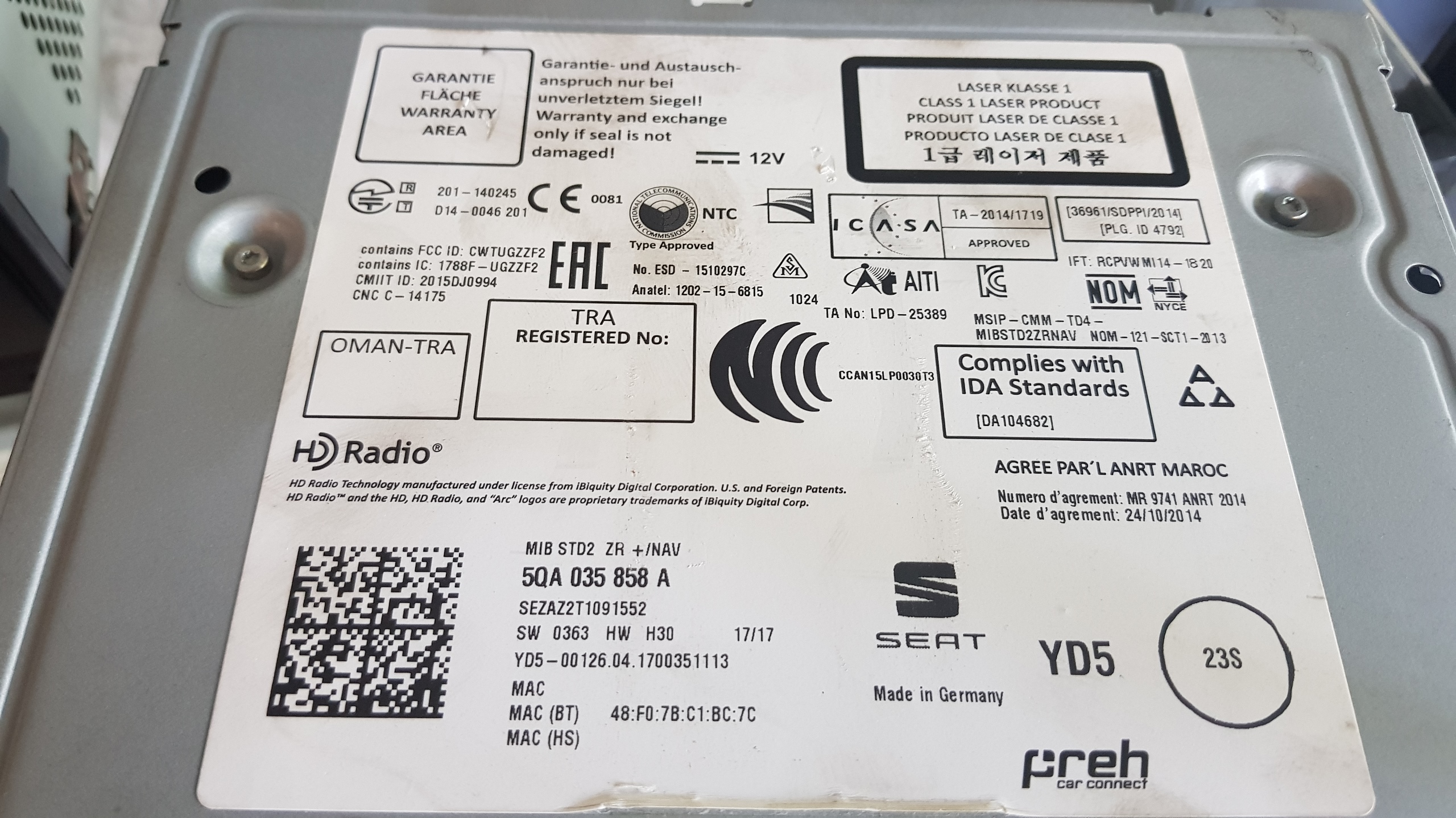

Mib2 came from Ibiza so I doubt it.
Can the AliExpress vcp tools do this ? The coding is definitely in 5f ?
I retrofitted the seat sound system in my Leon. I was told only original vcp can do it.
I don’t know if the ibiza has seat sound supystem as an option.
Check your long coding in 5f- byte 4 on the mib2. If it says ‘FF’ its probably coded for seat sound system.
The uploading of the data to paramatrize the mib2 is something else.
I was looking today. pretty sure it is FF but no sub woofer option. Is there vcds coding to show the sub woofer if FF already in long coding.
The FF coding is a way the STG 5F checks the loudspeaker set up is correct.
If you scan for problems, you get errors in the loudspeaker settings with FF as your unit/car is parametrized for 6/8 loudspeakers and not 9+subwoofer.
Subwoofer menu is only enabled after 9VD coding.
I will check to make sure FF but no errors showing. So how can FF exist on new unit but still need this 9vd coding I assume you are talking about factory build codes ?
To be honest...i dont know. It seems odd, perhaps different on the Ibiza...
How is the sound comming from the speakers?
My knowledge on this topic comes from forums and what i did to get the correct coding and set up for my LEON.

Sound seems ok however no subwoofer option. The mib2 has been worked on but I don't know if hacked or used Odis to setup the unit for mib1 car.
If you are sure FF enables SS maybe the subwoofer option can be enabled somehow

Admap was taken with the old unit but nothing relates to SS so not sure what parameter enables this.
i’m very sorry, but i cant help you any further with this.
Off what i read, the subwoofer can not be simply coded with vcds/obd11.
You should find someone with vag can pro to read out the unit.
Good luck.
Btw, in 2 weeks (first CP removal at Seat dealer) i’m sending my second hand mib2 std unit to Poland (APG) to get it reprogrammed.
The donor car (Leon) did not have Seat Sound (D7 in byte 4) so i already specified that the mib2 needs to be reparametrized.
