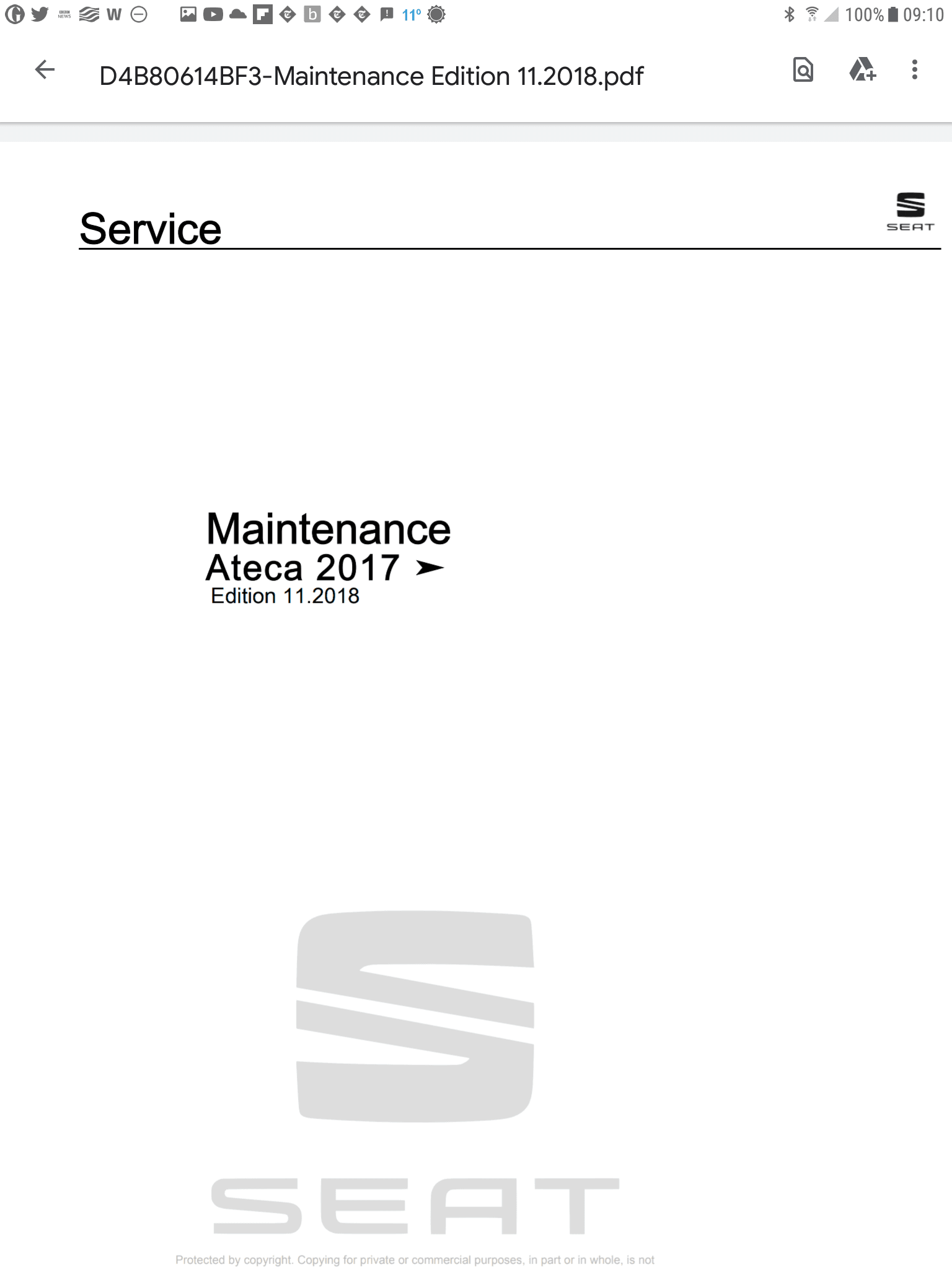

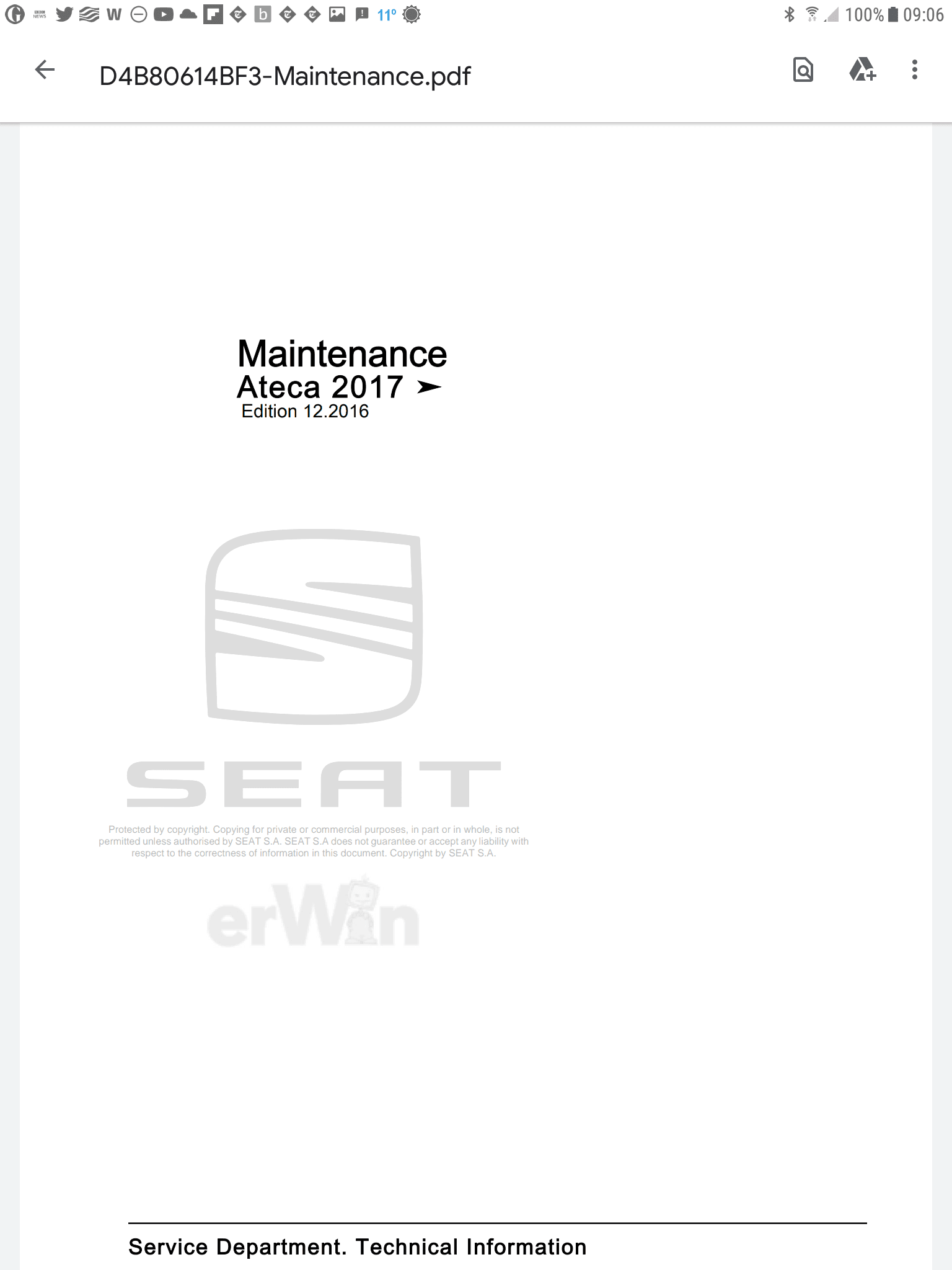

I had a similar issue when it was coming up to 5 years old. I consulted the Ateca Erwin maintenance manual. This is where coughing up for £7-50 for one hours access comes in handy for Erwin, the official workshop VAG site
It's like having the Haynes manuals but much bigger. The ones you always bought when you bought a new car even thou you were not going to get your fingers dirty.
The one you want or anything later
