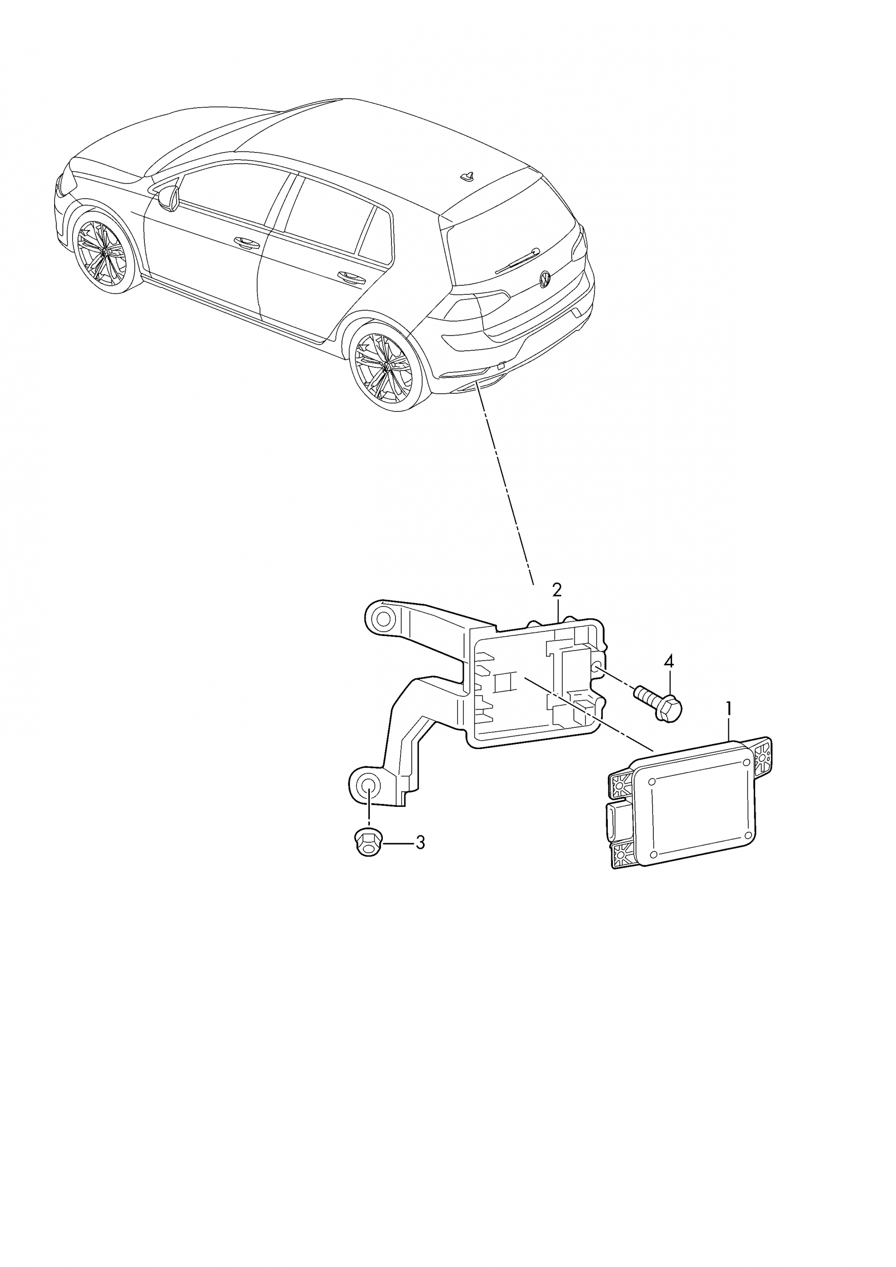

Apparently, VAG cars have some special hardware that you may not have in your car. See the attached image. Maybe some expert can tell us for sure

You're missing all of the hardware & wiring

Blind spot /RCTA is 2 radars, brackets & new door cards (In the case of the Formentor/mk4 Leon). Then the wiring & software. Not a difficult retrofit

I'm on the way to install and configure. I've already bought the primary radar, need the slave one and the support piece for them.
Also have the cabling, easy to find in Ali, not expensive.
The doors already have the lights, it's an Xcellence from November 2020 with ACC, so, only need the rear radars and cabling.
If I replace the steering wheel with one that has the travel assist, I would also enable it, as the components are the same.

The door cards are different for cars with and without blind spot assist, the lights will not be installed. You'll have to install them
