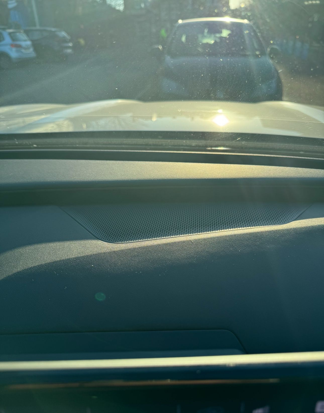

Today is only third day with this nice car, but on my way to work 30 last night there was some strange cracking/banging noise from the dash speaker, and later “emergency call” error. After engine restart this error disappeared. Last night temperature outside went down to -6, and display was frozen for 5 min. Is that normal behaviour for this car when the temperature goes below 0? ? I found some information in Google, that need try to update the software, but I can't understand how to do that. And I have already purchased for Cupra connect. Booked now for Saturday in Cazoo (from where I got this car) for diagnostic. But I am so frustrated now

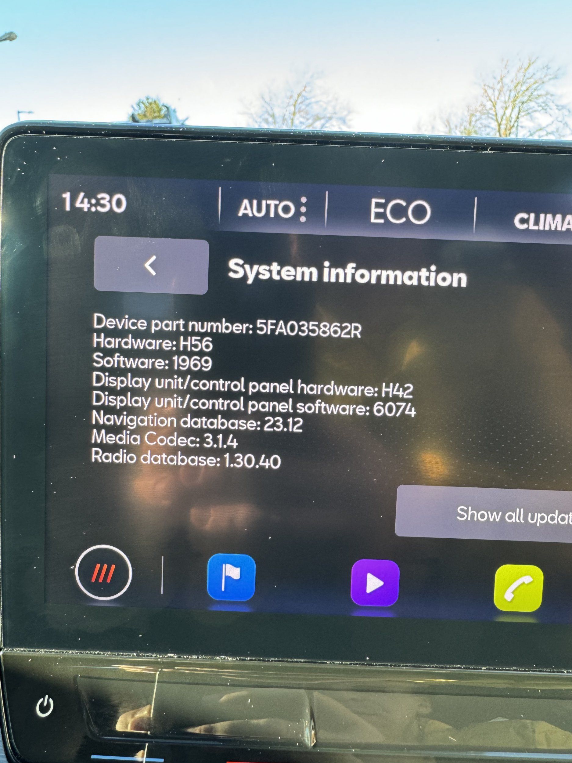

By the looks of your software version (1899), it seems the car is not new - that's what I thought when I read "3rd day with the car".
Indeed, a visit to the dealership should bring you an Infotainment software update to at least version 1940, if not even 1969 which is already available on some cars. Just tell them about the system being unresponsive and sometimes frozen for several minutes. If you had any random Infotainment reboots, that's even more convincing for the dealer to updaye your software - it's a well-known problem.

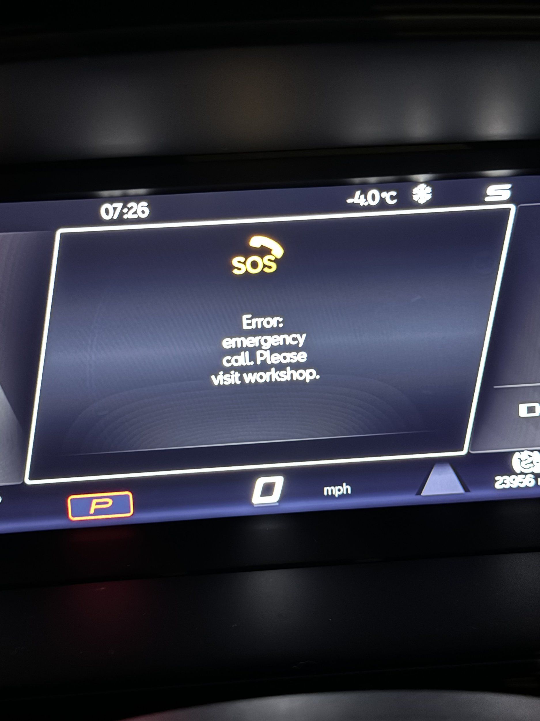

The SOS (or energency call) error is a different story if I remember correctly - AFAIK the software on the SOS module should be also updated, and in the worst case - if it is already up to date - the module should be replaced. That's another known issue over the entire VAG "collection" using identical electronics (Golf, Octavia etc.).
Good luck with the dealership, and if they play dumb just try to find another one, because what you described is really well known on these cars.

Let me guess, does it sound like somebody is knock knocking on your dashboard?
The problems only start when you add a drivers profile, never occurs on the test drive. The good news is the freezing is completely fixed in update 1940 ...the freezing infotainment system, not the freezing weather, unfortunately. The SOS speaker popping is solved by an OTA update (which could be forced by the dealership service)
The problems only start when you add a drivers profile, never occurs on the test drive. The good news is the knocking and the freezing is completely fixed in update 1940 ...the freezing infotainment system, not the freezing weather, unfortunately.
Yes, but what I have noticed, this noise only comes out when car is connected to the Apple Carplay. And I am not sure that dealership from where I bought this car able to update software? Need go straight away to Cupra official dealership?

Yeah just updated mine to 1969 manually. Will check how it works later when I am going to work. Hopefully, everything is fixed.

Good stuff, I'm also waiting (hoping) to get 1969 when I visit the dealer early next month to improve infotainment responsiveness, as well as to discuss the purple ambient lighting.
I wouldn't be surprised if your symptom remains though - speaking as somebody who got 1940 and still had the SOS faults, before an OTA update finally fixed it for good.

The first was updated from 1899 to 1940, and I was disappointed with the laggy touchscreen, he just didn’t want to respond to me I found 1969 in this forum, downloaded and installed. Seems much better, but still waiting for a test drive Fingers crossed no more knocking sound and sos error

Keep your dealership booking in the calendar. I don't know if they open a case with HQ but reporting it could trigger the SOS system OTA update request, which you need.
