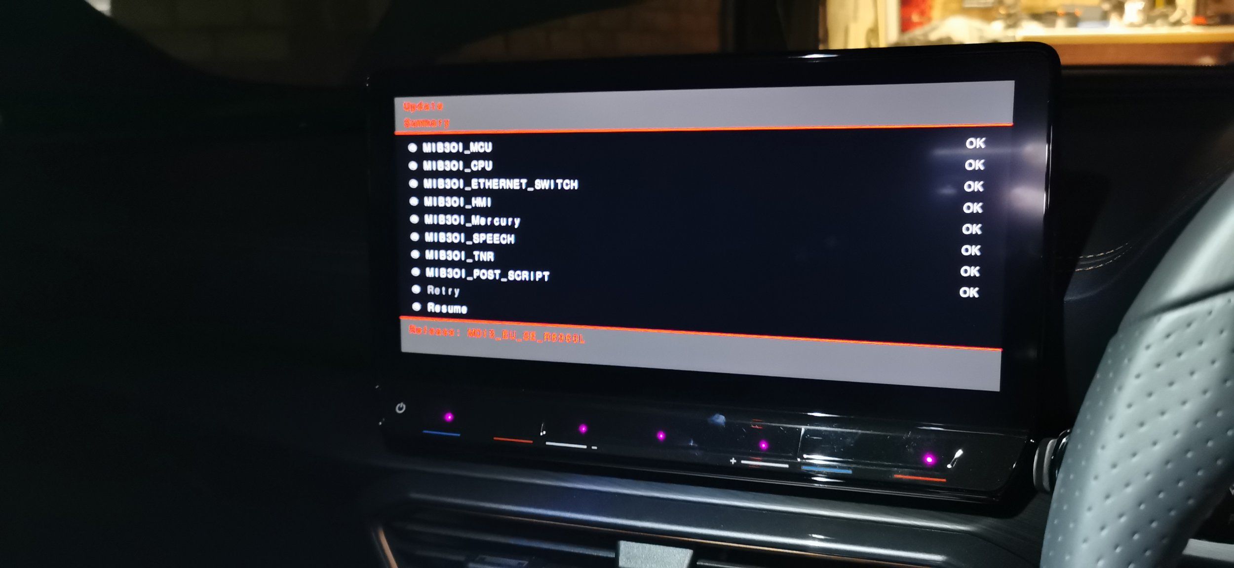

Updated from 1672 to 1896.
Please bare in mind this is only currently possible for cars with the PR code 8AR, NOT 8AW. This means it wasn't officially available for my car but I'm sick of waiting for it
First impressions - mindblown
BTW, can you share
TPI document so that I know which magical words to say for them to apply it?
In other words, unless I complain about specific faults it supposedly fixes, they will not perform the update.
