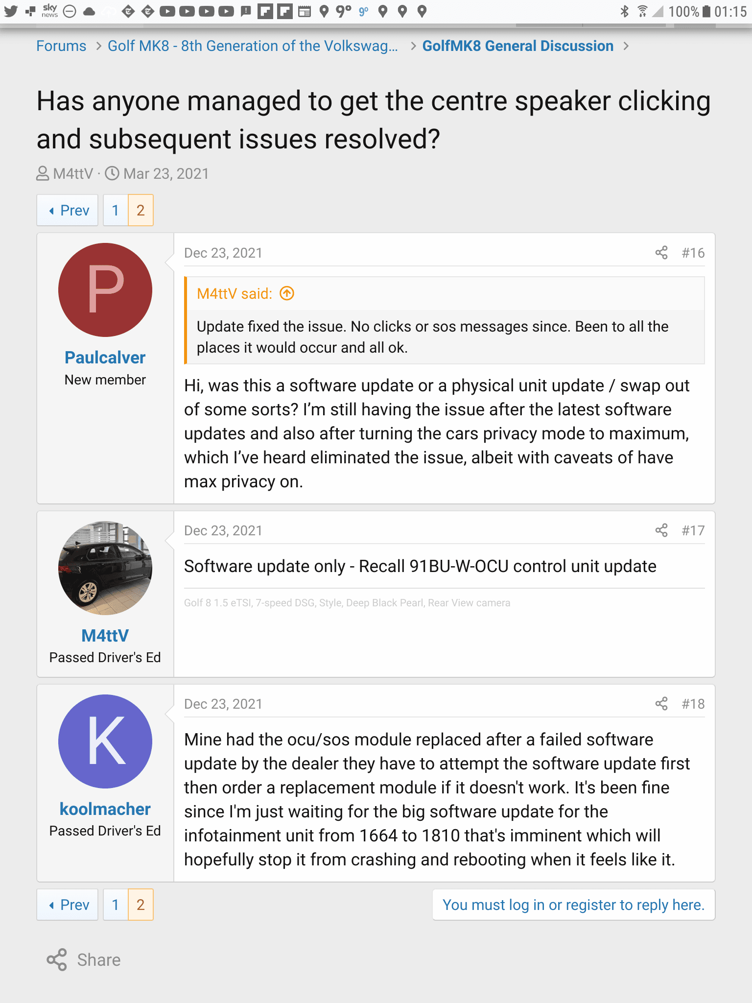

The SOS issue is outside of the infotainment firmware. I haven't relocated yet my post with a VW job sheet that said what they did to fix a VW.... fellow poster may find it ?. It's there somewhere.

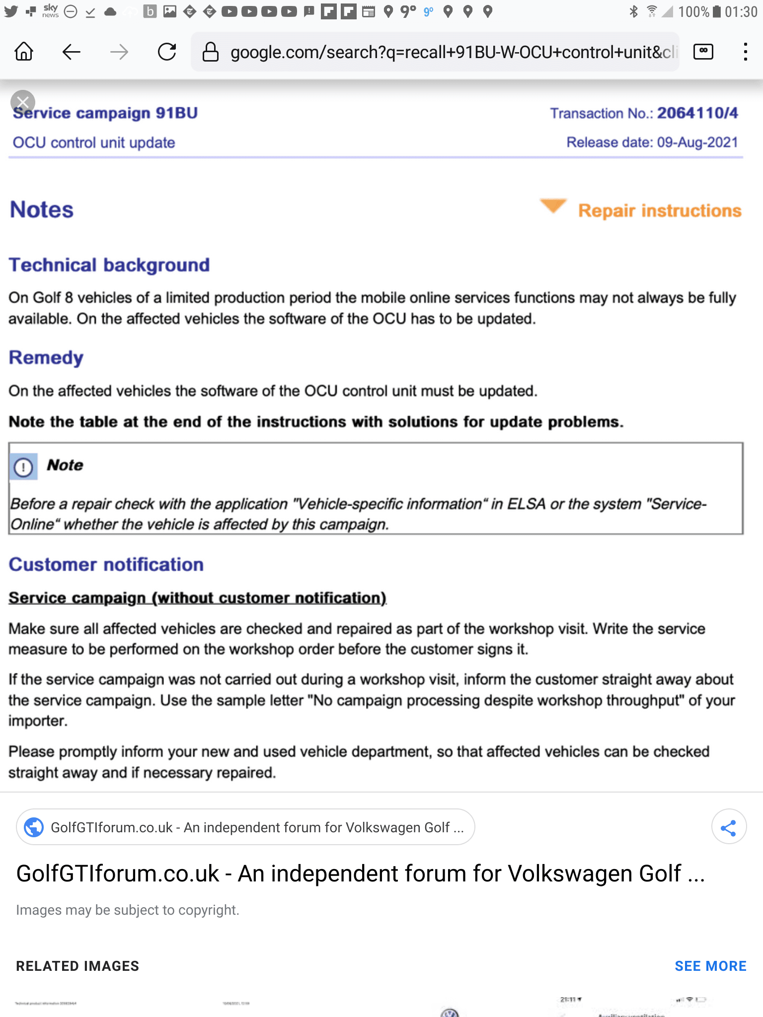

Still looking for my old post with the VW dealer fix but found this:
Further Google and lot of VW Golfs got called back in.
The OCU is the connected car chip. Reckon it's Seats version of that which is the issue which they are slow to sort out.

Well people thought that 1896 was going to fix all their woes but the pop that originates from the telematics software it doesn't touch so I would not apologies. I don't reckon too many Seat / Cupra people have had that fix but I could be wrong. That is the issue that has been plaguing VAG MQB Evo platform reported in the media and forums. E.g..
