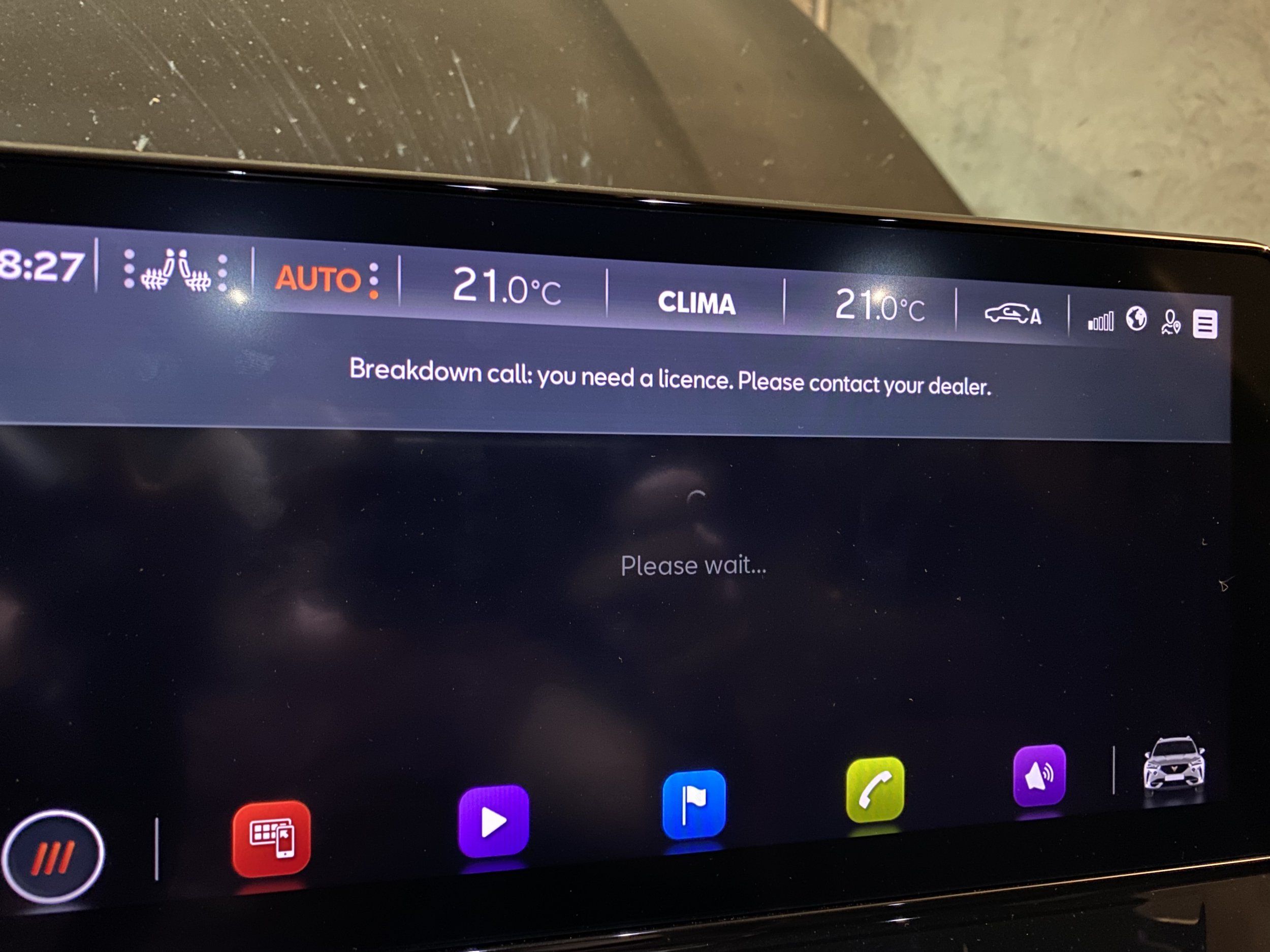

Do you have any issues afterwards registering as a primary user with two keys? After update I’m stuck as a guset and remote services are not working 😂 Visited dealer and as always “diss” :)

Nope, thats funny - globe is white, I can log in into my accpunt from car level BUT cannot register as primary and I get this message when tries to connect with support from car :) I resetted OCU but it didn’t change a thing….

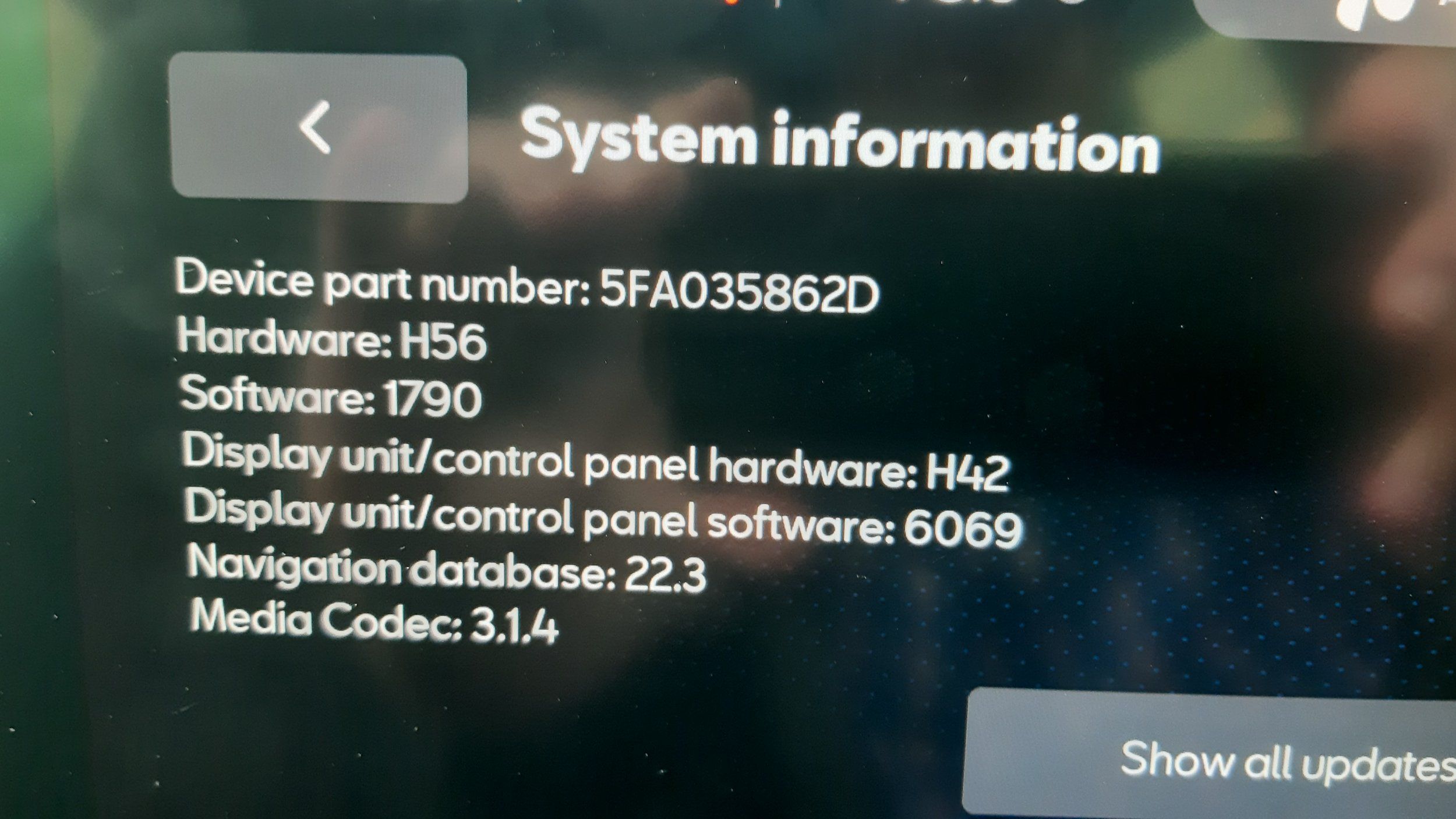

So firstly my apologies as I am a techno dinosaur and I am sure the answer is above somewhere but could one of you intelligent beings confirm what software I should have now? Below is a picture of my system information. It is a VZ2 2 litre 310 (a year old) and rhd (obviously although I still think the car thinks it is lhd). Based on what I may understand from the discussion... should the software show 1896 rather than 1790? The car was in for its first service yesterday and i was told that everything had been updated to the latest. If this isn't the right info, can you let me know where to look?
Again apologies for going over any previous discussions :oops::rolleyes:
Many thanks guys and gals:worship:
Yup 1790 on your car. My guess is that the garage didn't update it. Hopefully you may get the over the air update as others have been receiving or you may have to get it booked back in to the garage for them to apply 1896. I think they'll only do it if you complain about some of the issues the update should fix so you may have to be creative. :)
