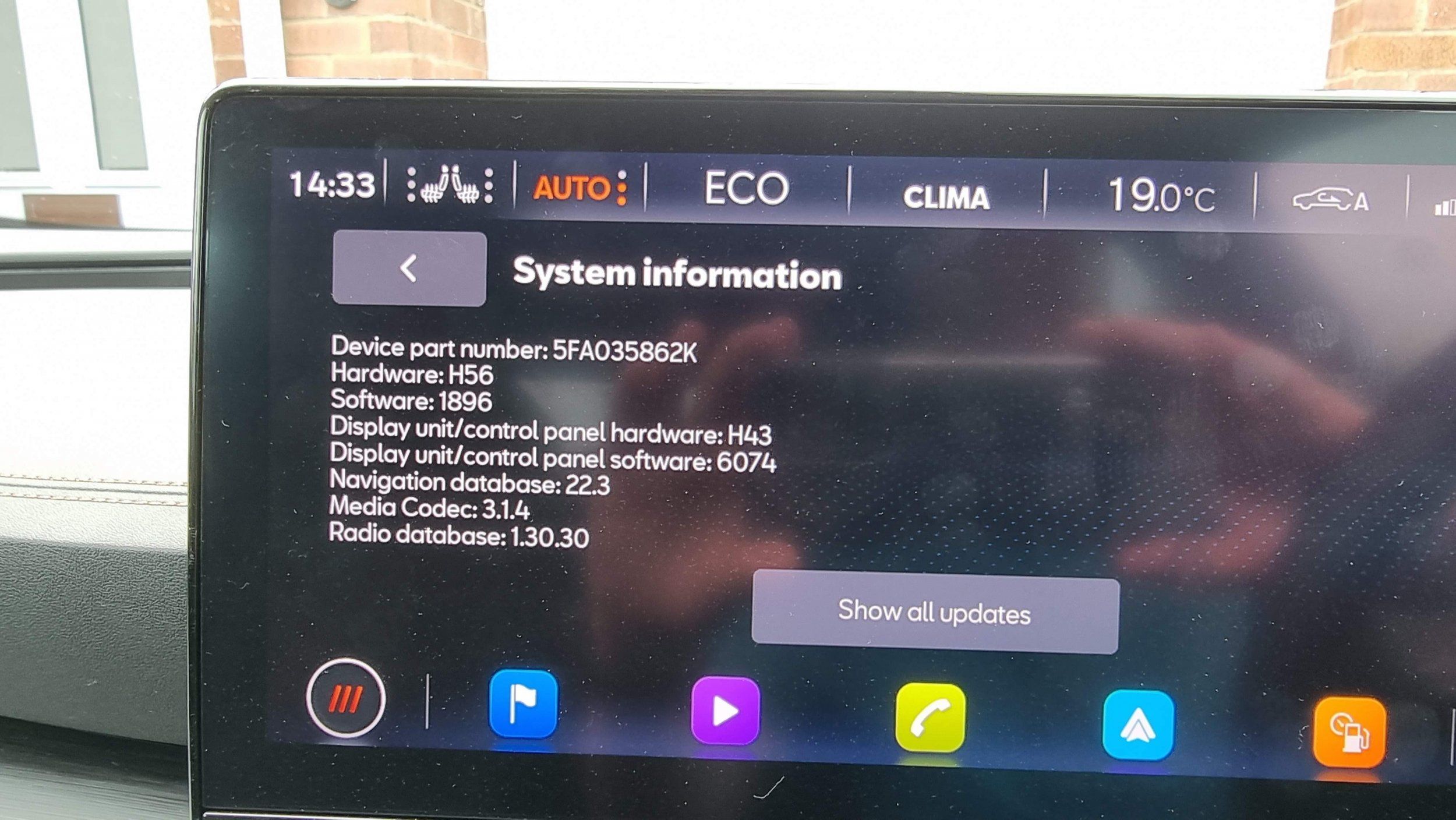

Sorry if this has been asked before, but how do I know which version of software my car has? I don't know my way round it yet! TIA :)
Hi, with the ignition on or car running, hit the circle in the bottom lefthand corner of the infotainment screen. Hit it again to show individual icons on the screen and then select the 'settings' icon. Scroll down to 'system information' click it and you software version will be shown like this:
