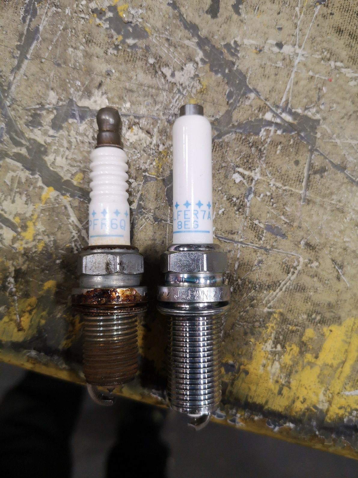

Today I was replacing spark plugs in my Leo everything was fine till I found out the spark plugs what I bought were totaly different. I thought that I bought wrong ones but I checked everywhere but turned out to be correct according to that what internet says.
New one is NGK ..FER7A8EG with thread 26,5mm
Spark plugs what I took out from engine is NGK PFR6Q with thread 19mm
So when I checked that I was totally confused o_O
Is any one had that situation before ? Or know exactly serial number of spark plugs for this engine ?

You defo want to make sure you are correct here or it could be bad news and you could kill your engine.
I suspect the plugs you removed are the correct ones and you should source these again

The short plugs you removed will more than likely be the correct ones for your engine.
If you put the longer plugs in then theres a chance you could end your engine, valves / pistons into the spark plugs. Could be curtains.

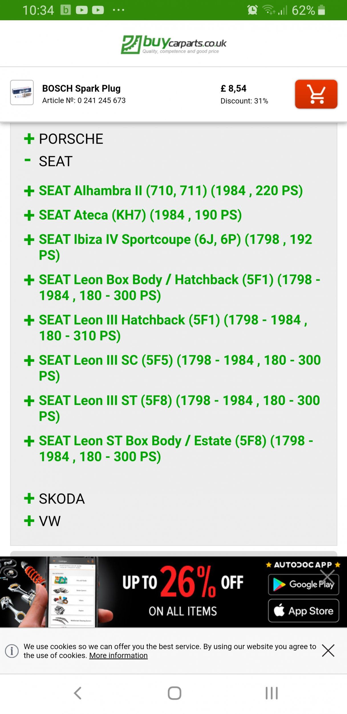

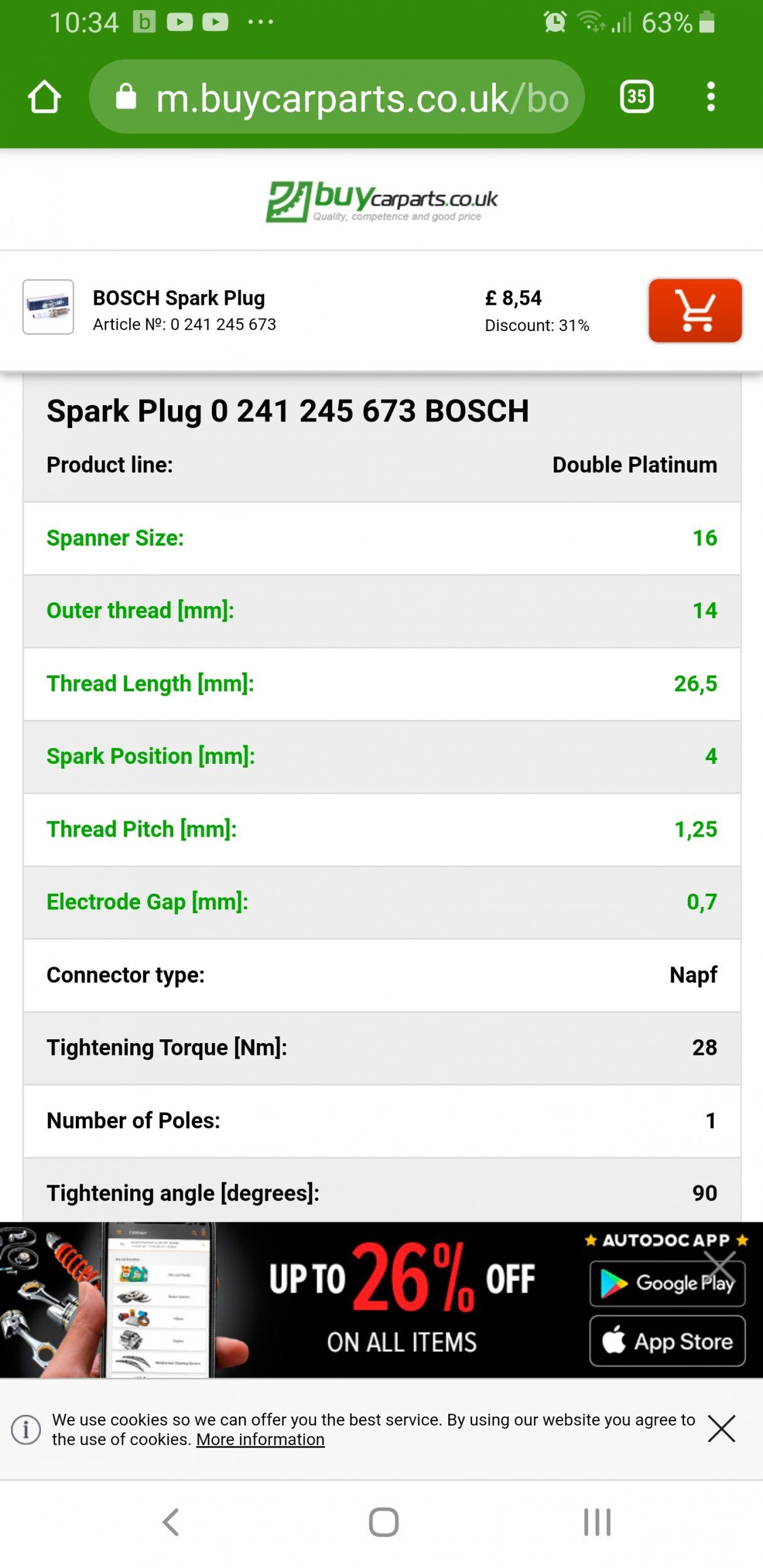

Just been online here are the specs

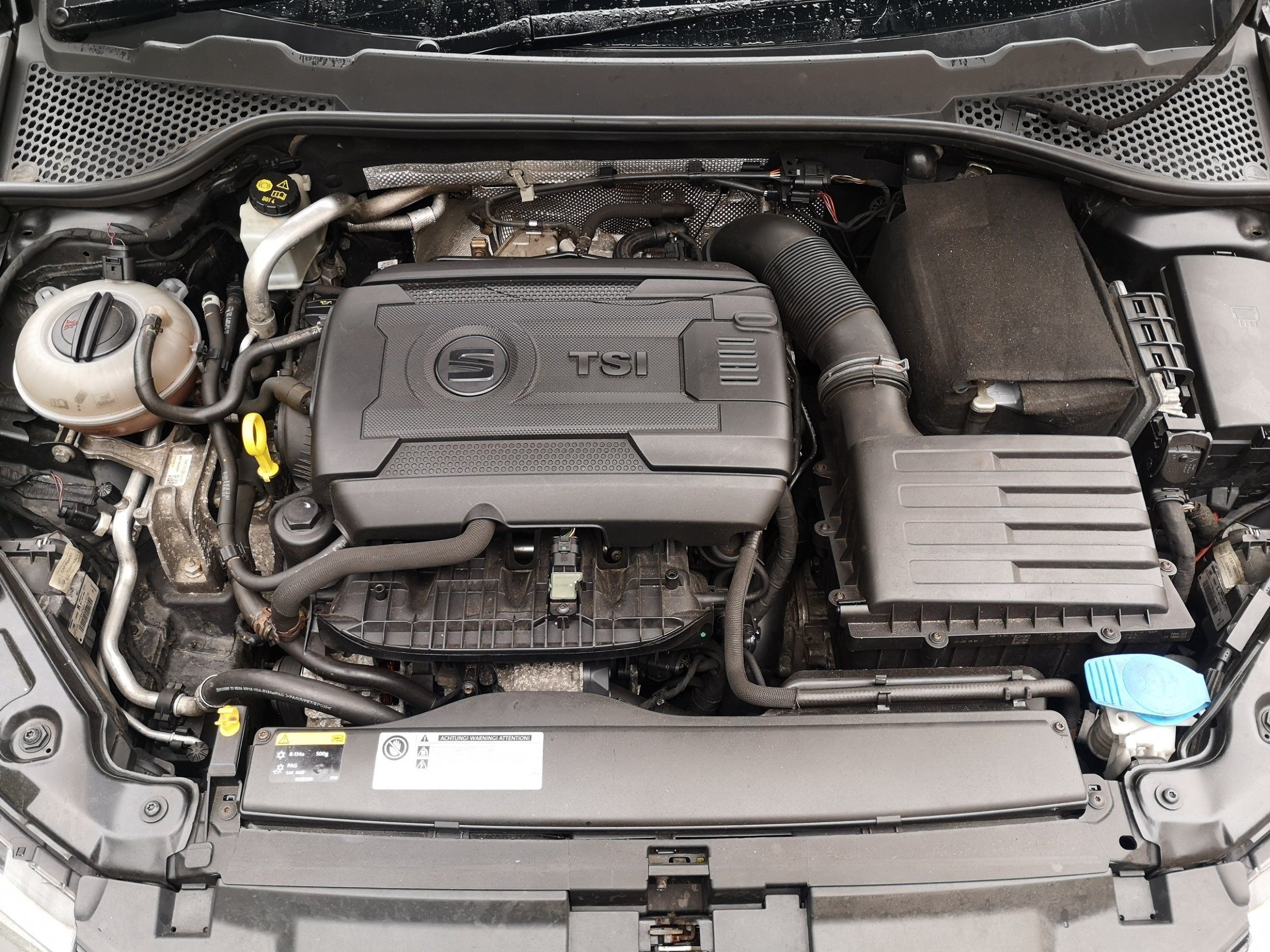

Ah ok i understand , would be helpfull if the op could put a picture of his engine up.

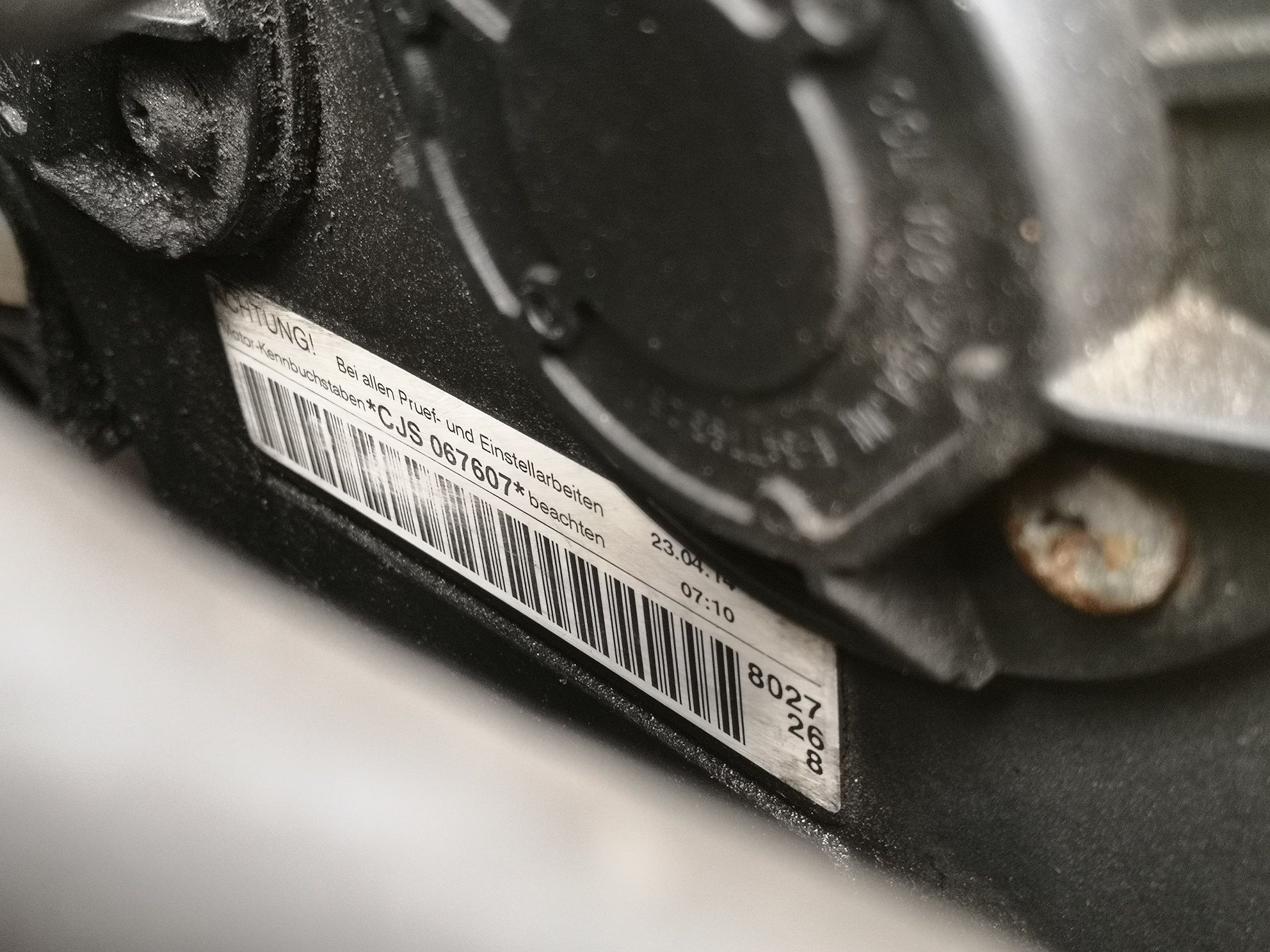

Engien numer is CJS 067607 (Read from V5 and nameplate on drivers post) with that mean should be a correct one for this model. So confused this is o_O
Where I can find engien numbers on engine ?
Strange defo ea888 1.8. Contact aso seat and ask them for parts invoice. So you can check what spark plugs they used. Go from there. I suppose it would work with the shorter plugs, even though they are incorrect.

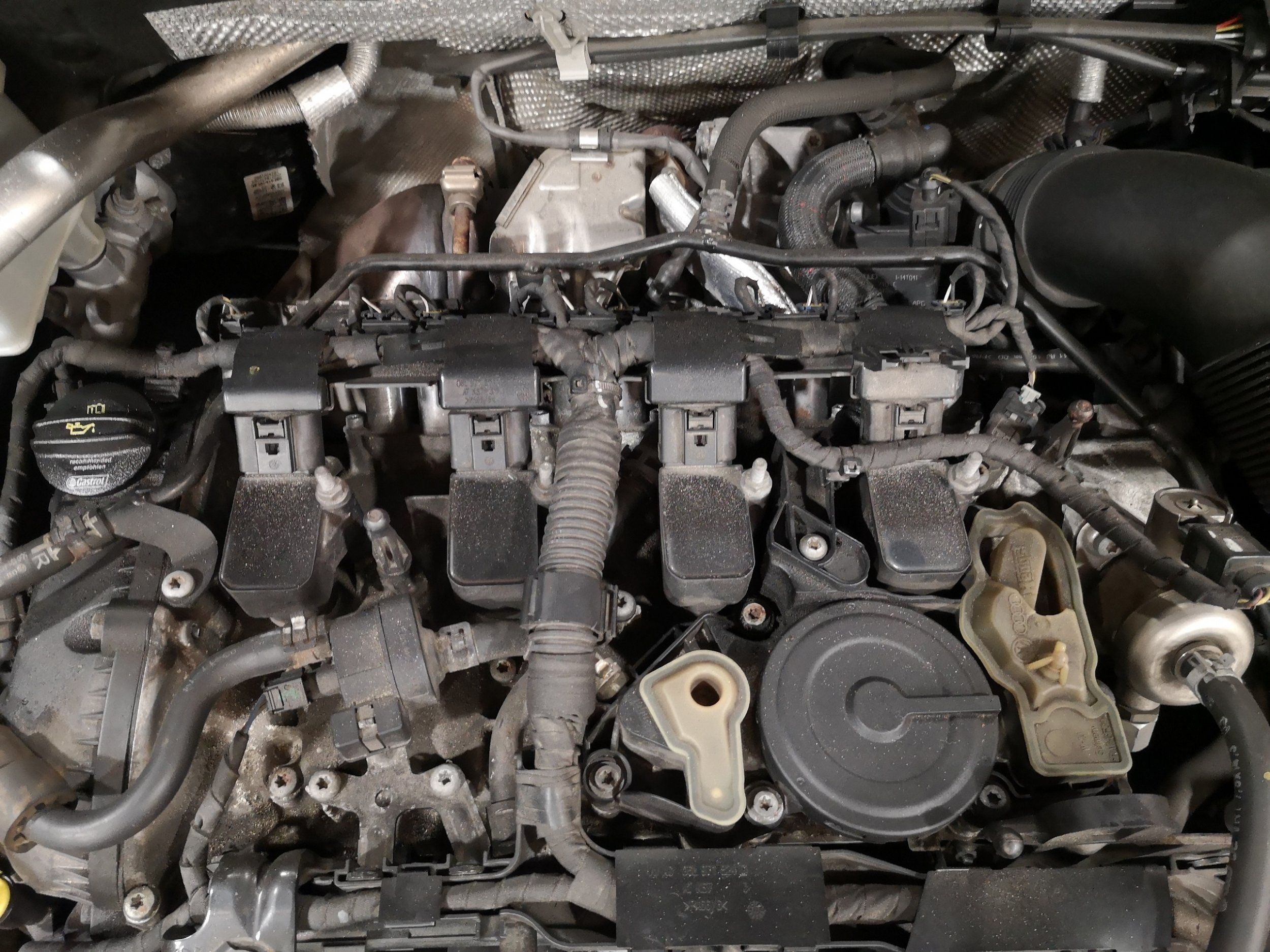

Can you also check for the engine code on the engine itself? I think it should be somewhere on the block, under the decorative engine cover. If it's the same as you previously wrote, you should contact ASO Seat and ask about the plugs. CJS* definitely uses the longer plugs.
Hi,
I've checked the number on a engine and they are same as on V5.
I bought same spark plugs what were in engine. Changed them today and they works fine.
Still makes me wonder what is going on with them different spark plugs o_O

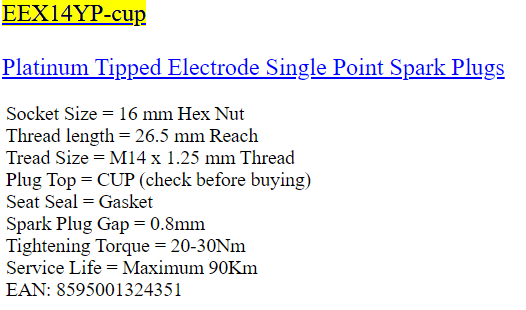

1.8 TFSi --- Quattro, Cabrio, Sportback2012 to 2020 4125-132kwCNSB, CJS, CJSA, CJSB, CUF --- 1798cc4x EEX14YP-cup Gap 0.8mm
