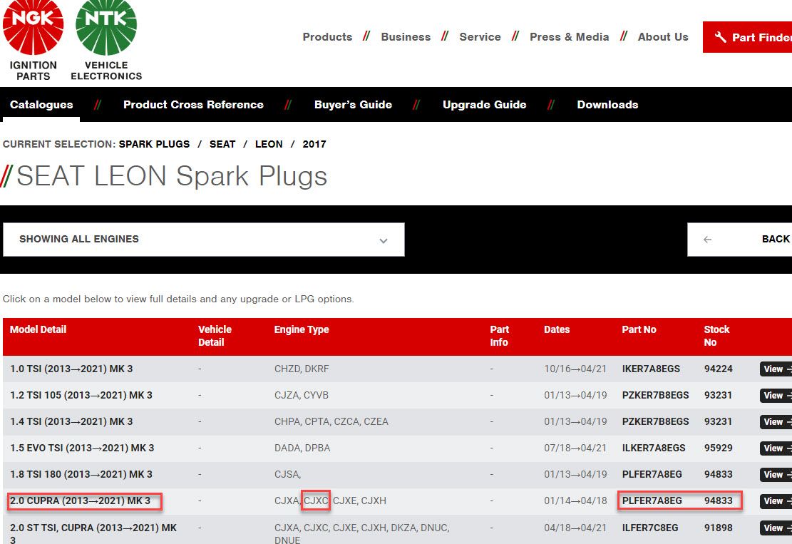

If you want NGK i gues it is NGK PLFER7A8EG /94833
All the cars below have the 4 cyl engine EA888
NGK PLFER7A8EG is the spark plug for:
My former Golf mk7 R 2.0 TSI 2014 300 hp.
My Cupra R mk3 2.0 TSI 2018 310 hp
My Golf mk7 Alltrack 1.8 TSI 2018 180 hp.
In all these 3 cars I have installed new NGK spark plugs during the years.
As you can see the same plugs despite 1.8 or 2.0 liter engine.
The vw dealer was very expensive, nothing for me ;).
PS Check your car to be safe. Most likely it is the NGK plugs i have used... if the car is made before 2018 April.

My guess is that the Leon Cupra 2017 in this tread have the engine code CJXC which is exactly the same as I had in my former Golf R 300 mk7 2014. I have used NGK PLFER7A8EG in the Golf R for many years without problem. Why pay 2 times more (at least in SE) for the same product when you know what to buy.
The final check is when you have them on your desk and compare treads, length and so on to the old ones.
Good luck!
https://www.ngkpartfinder.co.uk/catalogues/cars/search/spark-plugs/SEAT/LEON/2017/

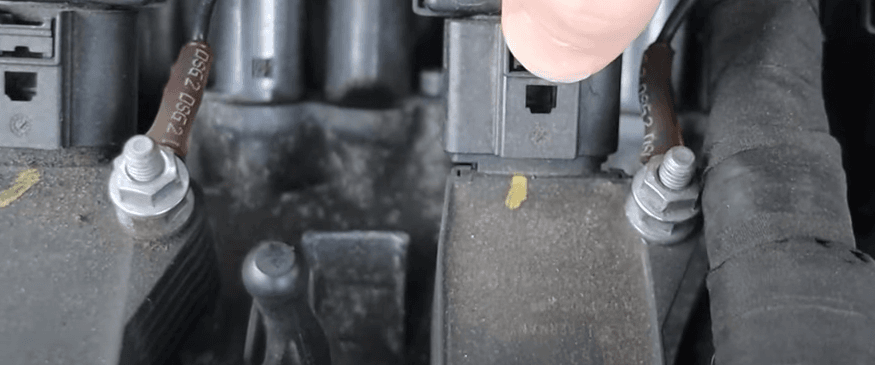

I cannot remember the ones I had but i did have a little issue in fitting them.
When removing the coil packs there is a wire that you need to unbolt first before undoing the next nut to remove the coil pack
Just make sure you have a spanner on the nut on top as well as the one below it. I actually had to take one of my spanners and grind it down a bit so it coulds slide onto the bottom nut
I went a bit ham fisted on the first one with just one spanner and the bolt I thought was captive in the head wasn't. It twisted and I actually snapped the wire by accident
Bit of soldering was needed and its all good now but best to know beforehand
