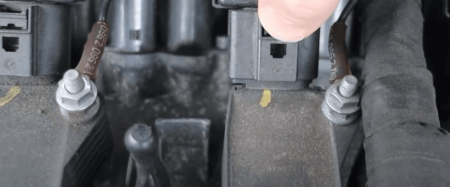

I cannot remember the ones I had but i did have a little issue in fitting them.
When removing the coil packs there is a wire that you need to unbolt first before undoing the next nut to remove the coil pack
Just make sure you have a spanner on the nut on top as well as the one below it. I actually had to take one of my spanners and grind it down a bit so it coulds slide onto the bottom nut
I went a bit ham fisted on the first one with just one spanner and the bolt I thought was captive in the head wasn't. It twisted and I actually snapped the wire by accident
Bit of soldering was needed and its all good now but best to know beforehand

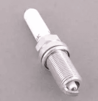

Can any one help please... When/miles you should change the plugs on a Leon EX LUX 190 2.0... Are the original 3 pronged/earth??
SuperV8
May 30, 2019
1,872
941
Spark plug for DKZA, DNUE, CJXC, CJXH, CJXE, CJXG, CJXH,DNUC, 2.0
= 06K905601L which is NGK
every 60,000 km/48 months
SuperV8
May 30, 2019
1,872
941
No,
Just searching on the part number I shared:
NGK part number version = NGK 91898
Trade number ILFER7C8EG

Re-visiting this thread.
Does anyone know when they changed from the PLFER7A8EG ( 94833 ) plugs to the ILFER7C8EG ( 91898 ) plugs on the CJXC engine in 2018
RUM4MO
Jun 4, 2008
8,106
1,120
South Scotland
For NGK online cats, only certain models and marques reflected the change, with internet chatter claiming that both the "A" and "B" were still being sold side by side, each having its own VW Group model/marques for the same engine - though maybe not in every engine/year.
Personally I'd follow whatever was listed on the VW Group parts listings.
By the way, the ILFER7C8EG stock number 91898, being an Iridium plug can have a longer service life, 6 years against 4 years for the PLFER7A8EG stock number 94833. My daughter's May 2019 Leon Cupra came new with the Iridium plugs and so a recommended "replace" time period of 6 years,
Do check the VW Group parts listing for your age of car, if there was an option or a choice or a secession(sp), it will get reflected there.
Okay, I've checked the VW Group online parts listing, for CJXC engines, car build dates up to 08/04/2018 use 06K 905 601 B, for car build dates 09/04/2018 and onwards use 06K 905 601 L which I'd think corresponds to NGK PLFER7A8EG and later cars ILFER7C8EG - but remember, that might just align with a change in maintenance strategy and nothing more.
That would probably put my engine on to the earlier platinum plug ( registered late April 2018 )
Allowing 2-3 weeks from factory to UK suggests it was built 1st week April
Guessing I will need to pull a plug and find out before ordering.
RUM4MO
Jun 4, 2008
8,106
1,120
South Scotland
The Iridium option is shown as an upgrade for you age of car, on the NGK applications listing, if I were you I'd just go for that one and maybe take advantage of the longer service life.
I'm guessing that you replace the spark plugs every 4 years as they are Platinum, changing to Iridium would offer a 6 year service life.
Edit:- the VW Group parts listing never offers "upgrades" only what was fitted at initial build, the only time that other part numbers are given is that when a part has been superseded for any number of reasons.
