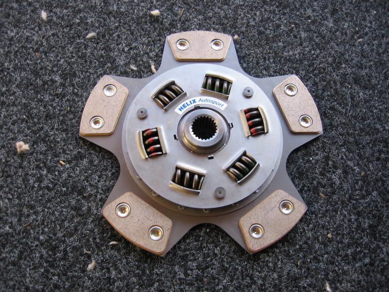

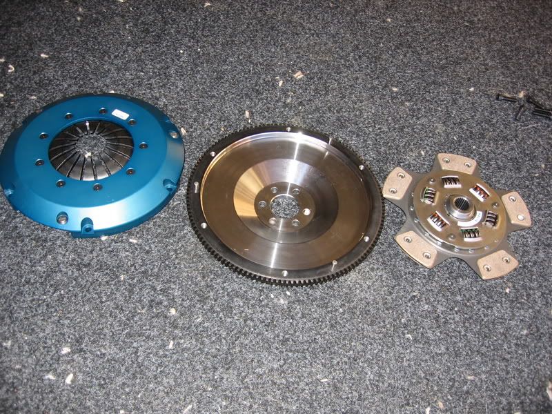

yep bloody expensive but is a good solid kit,this is the kit
Looks some kit caney!!!! But jesus at that price its amazing! Lol!
How would spec or Southbend compare to Helix? Is it a brand name thing that adds to the price? or is it actually MILLION times better would you say?
