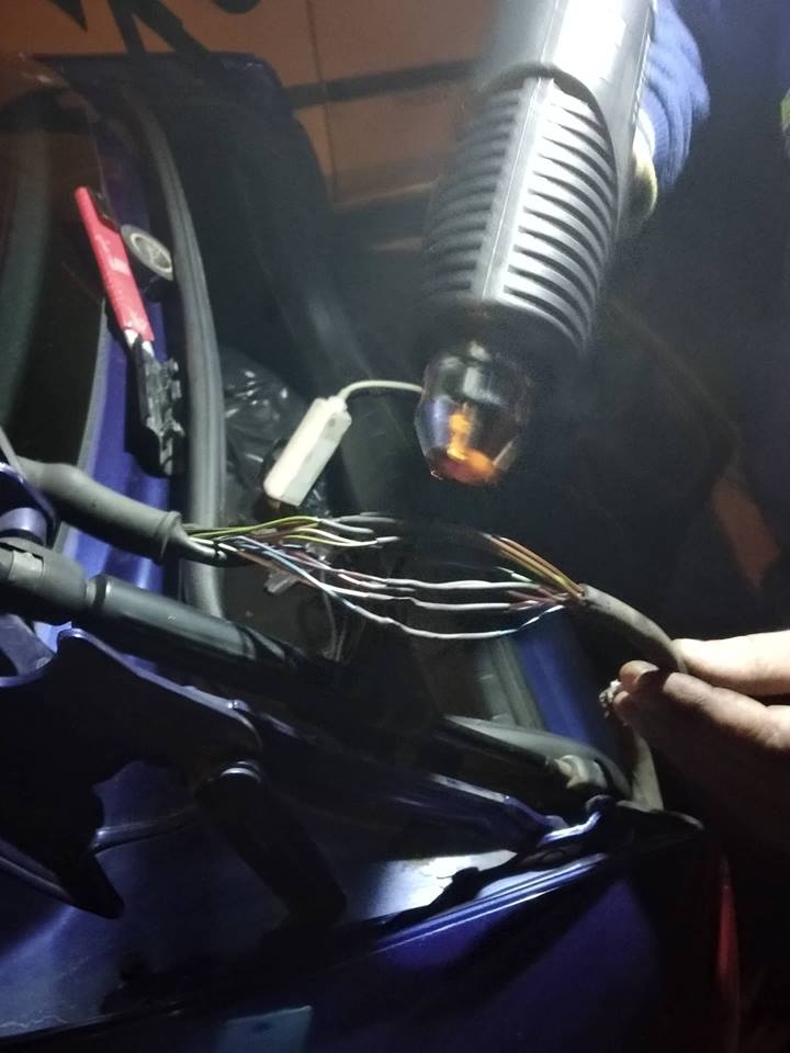

FIXED .Dont waste money on service!! On my Toledo 2003 problem was broken wires at trunk see photo .It has messed central locking,speedometer,reverse lights , and fuel gage 4 or 5 wires went off. When going in reverse fuse from speedo snapped (10A) messing fuel gauge 2.Central locking would lock but dont unlock or double unlock,reverse lights went off to also engine was stalling in 2nd gear.So hope it help
