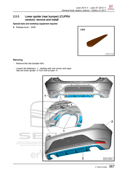

Hi guys I know there’s probably a thread for this that I can’t find....
Have a Maxton diffuser to fit understand removing the stock diffuser is supposed to be possible without removing the bumper.
Underneath it there are 2 hex screws either end of the diffuser I’ve found and removed.
Looking inside of the diffuser there a loads of clips holding it on.
How do I get these unclipped do
I need a special tool.
Any advice, video or thread link appreciated as didn’t want to take it to a garage really.
TIA
