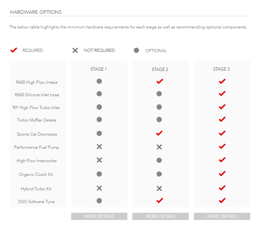

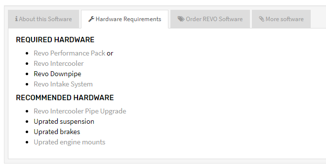

It may be worth listing what mods you already have first - stage one is usually just a map, but people tend to have upgraded air intakes at the same time.
Air intake and downpipe are the bare minimum required for stage 2, but some maps require an intercooler too. It is recommended for an intercooler even if the map doesn’t require it.
RacingLine doesn’t require a downpipe but it’s recommended. Some Revo stage 2 maps require intercoolers.
Sorry pal, Racingline does need the downpipe, just not the intercooler...
Where as like @theoldboy said Revo requires the intercooler too...
Pretty sure all Stage 2's require the downpipe...
