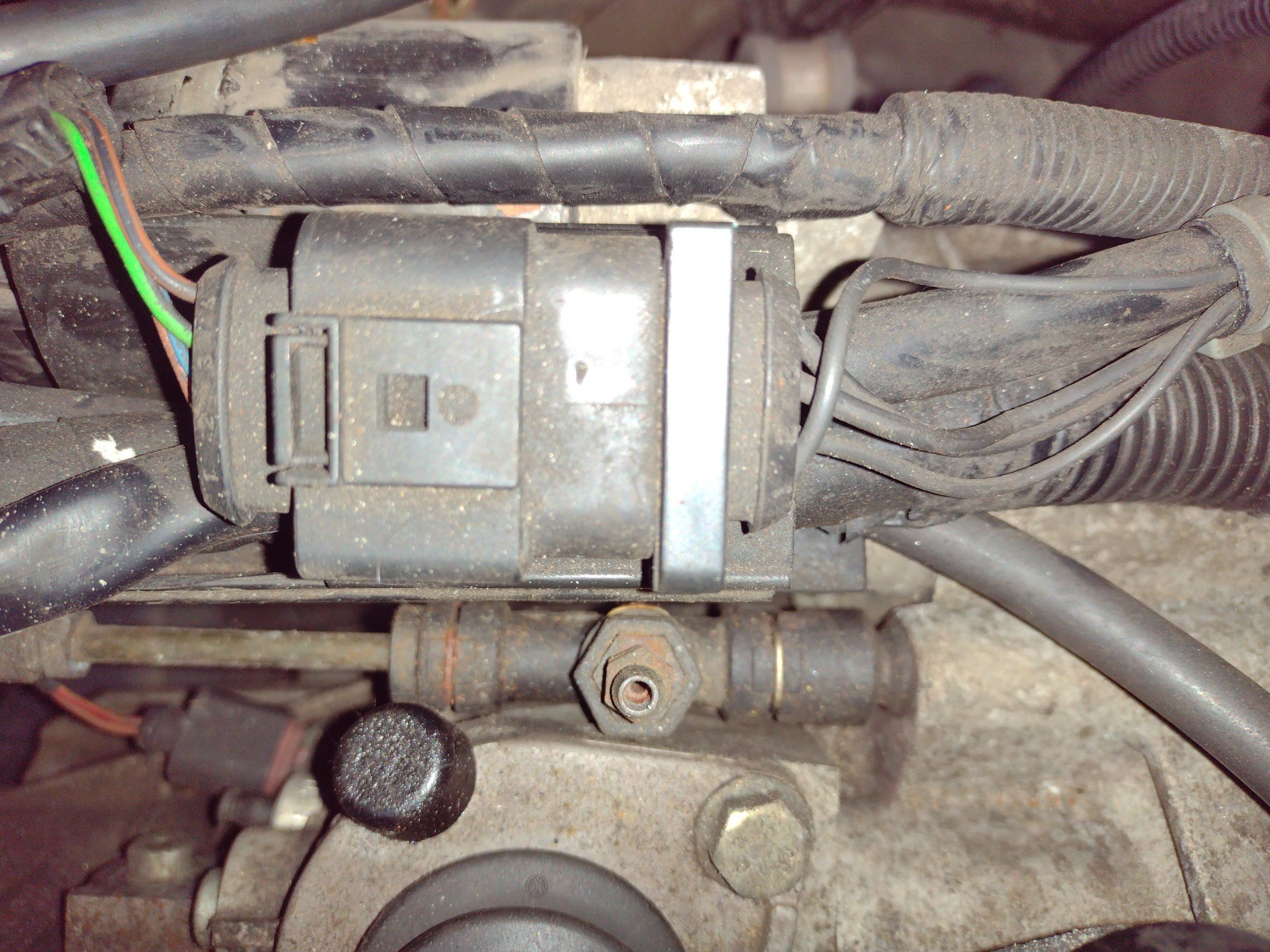

Could anyone tell me what that pipe running parallel with the electrical connector is for ?
From pictures I've looked at regards the bolt hole positions on the starter, one of them is directly below this pipe.

Ok thanks......best leave it alone then when trying to undo the starter motor bolt underneath it.
That pic by the way is looking directly down towards the starter motor, which you can't see because of that electrical connector.
