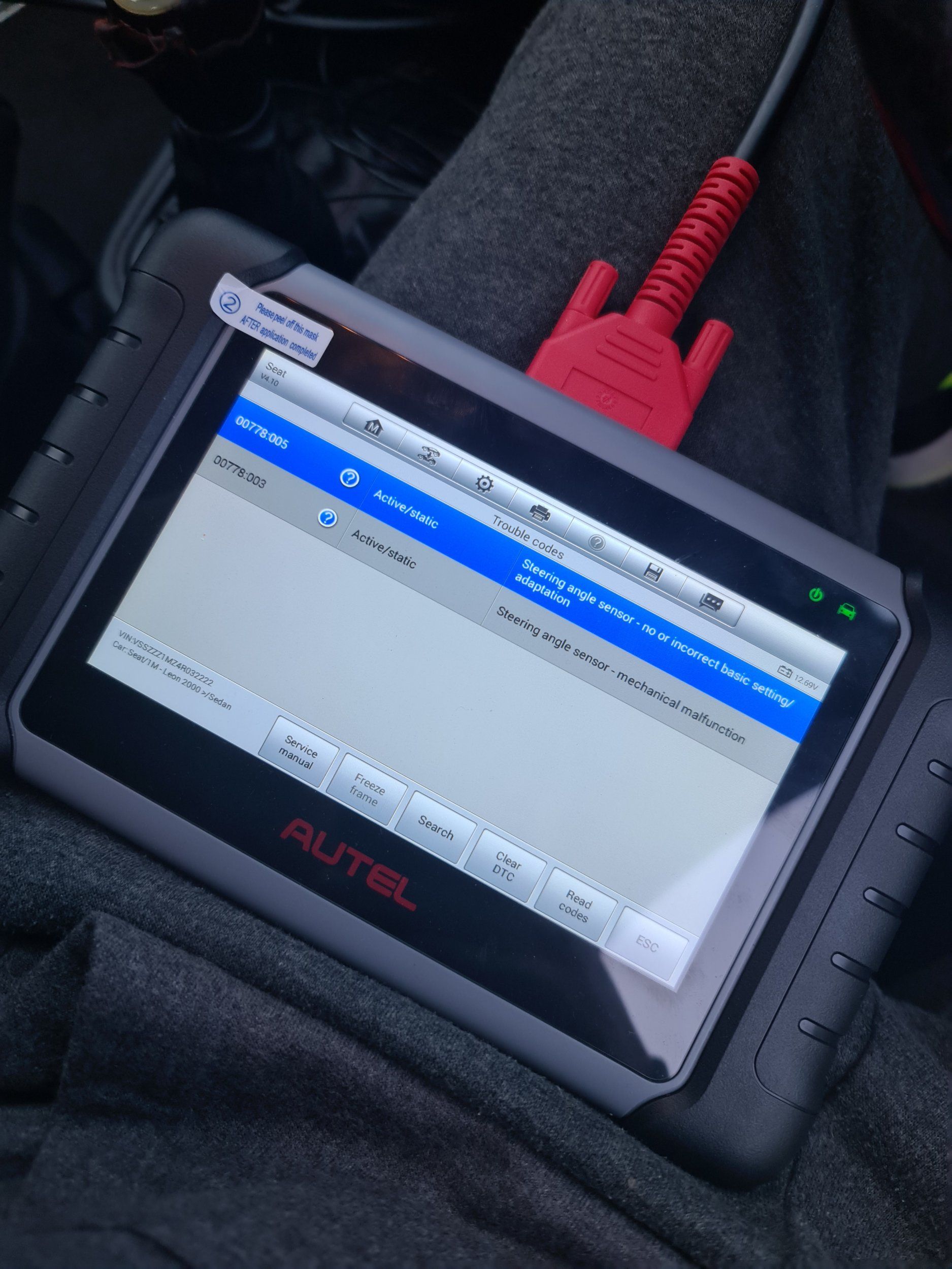

I've replaced the down pipe on my LCR, which obviously involved dropping the subframe, disconnecting the steering rack, etc etc. However as soon as it was all back together and I started it for the first time, the ESP light was on the dash, and I have the fault: 00778:005 when I scan it. There was a malfunction fault as well which was 00778:003, but I cleared that and it hasn't come back since.

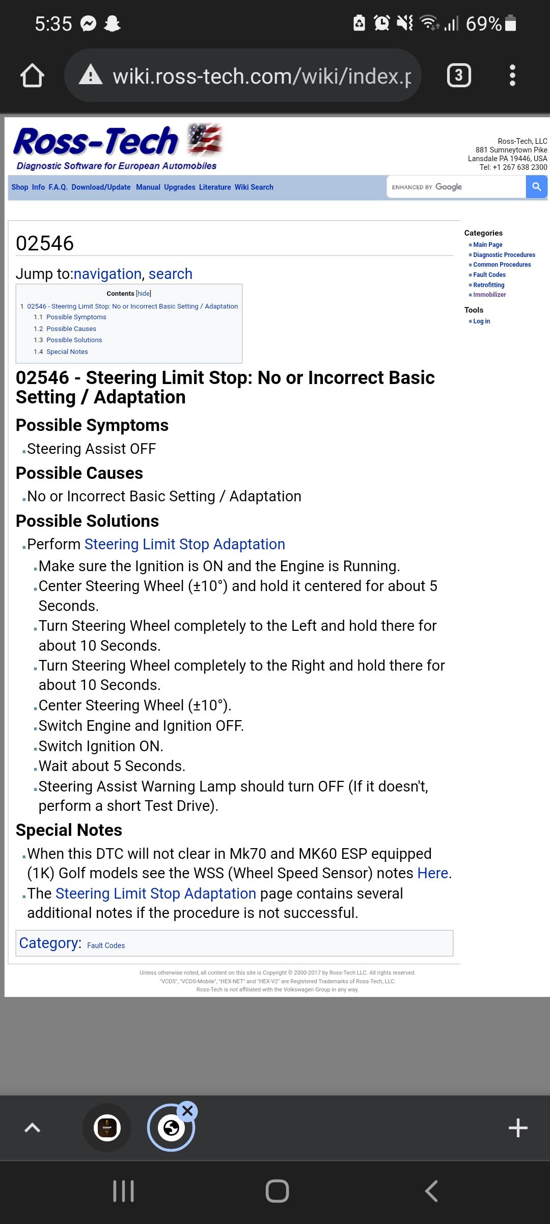

I have checked live data and I'm getting a reading from the sensor, so I assume it's working? It's also reading 0° when the steering wheel is straight. But my scanner is unable to do an electronic calibration on Seat's and I don't have VAGcom or anything like that, so I tried following the instructions on Ross-Tech and that hasn't worked either. Would it just be a case of replacing the sensor/clock spring? Or what else could I try? TIA

If so, then VCDS is the only way if the Ross-tech solution won't work. You definitely won't be able to calibrate it without it.

Unfortunately a new steering angle sensor hasn't fixed the problem...So I may need to invest in VCDS, or take it to a VAG specialist garage who already have the software to recalibrate it.
I was able to leave live data on, and screen record on my scanner while I went for a drive, so I checked and confirmed that all the wheel speed sensors are working. I assume all the ABS sensors will be fine as well, because the ABS light isn't on (the light does work)? The only light that's on is the ESP one. But I'm fitting coilovers tomorrow, so I'll check all the sensors any way while it's up in the air.
