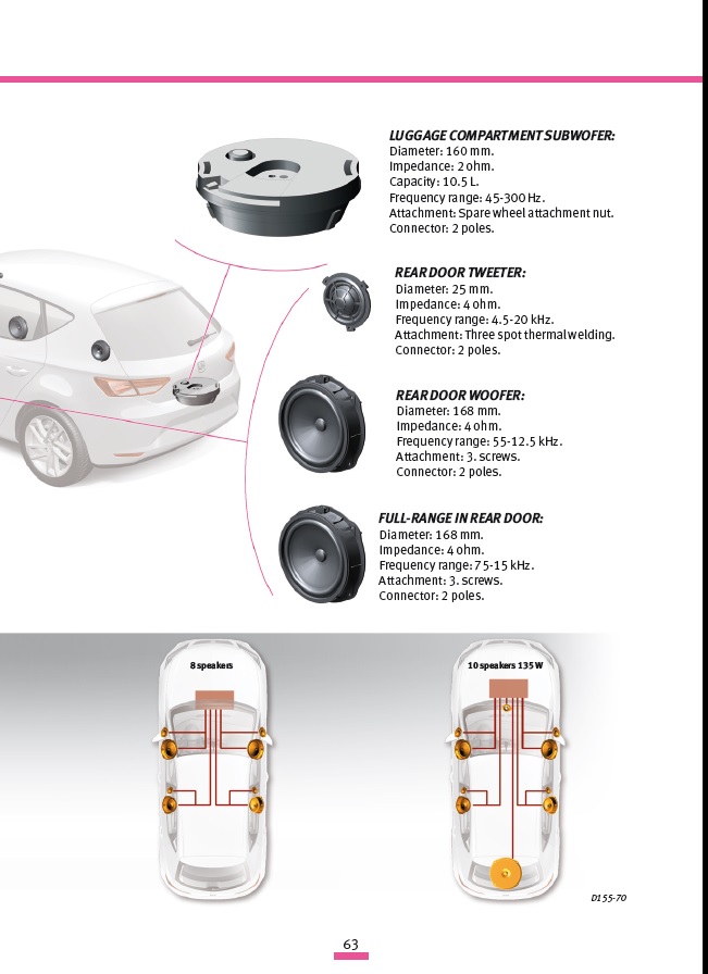

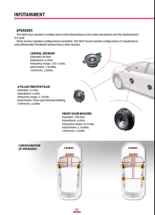

This are the speaker combinations:
If you have a six speaker system the rear door speakers ARE different to the ones on an 8 speaker system.This is good as it suggests the speaker units are the same across the range. So if my SE sounds worse than the FR then it has to be either that the head unit is better or there is a fault.

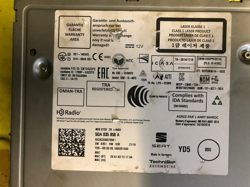

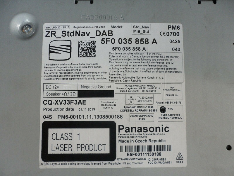

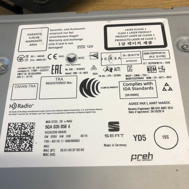

Had a quick look on eBay and saw some glovebox units that were taken out of a 14 plate TDI SE were made by Panasonic and then other units out of most of the other cars were made by TechniSat.
No, there is no cable fitted, on cars that have the Sub and Centre speaker (Seat Sound) the wiring is connected to different terminals on the back of the glovebox unit than on a unit without Seat Sound.Anyone know if the centre speaker cable is routed on cars that down have it? So it can just be fitted and connected?
