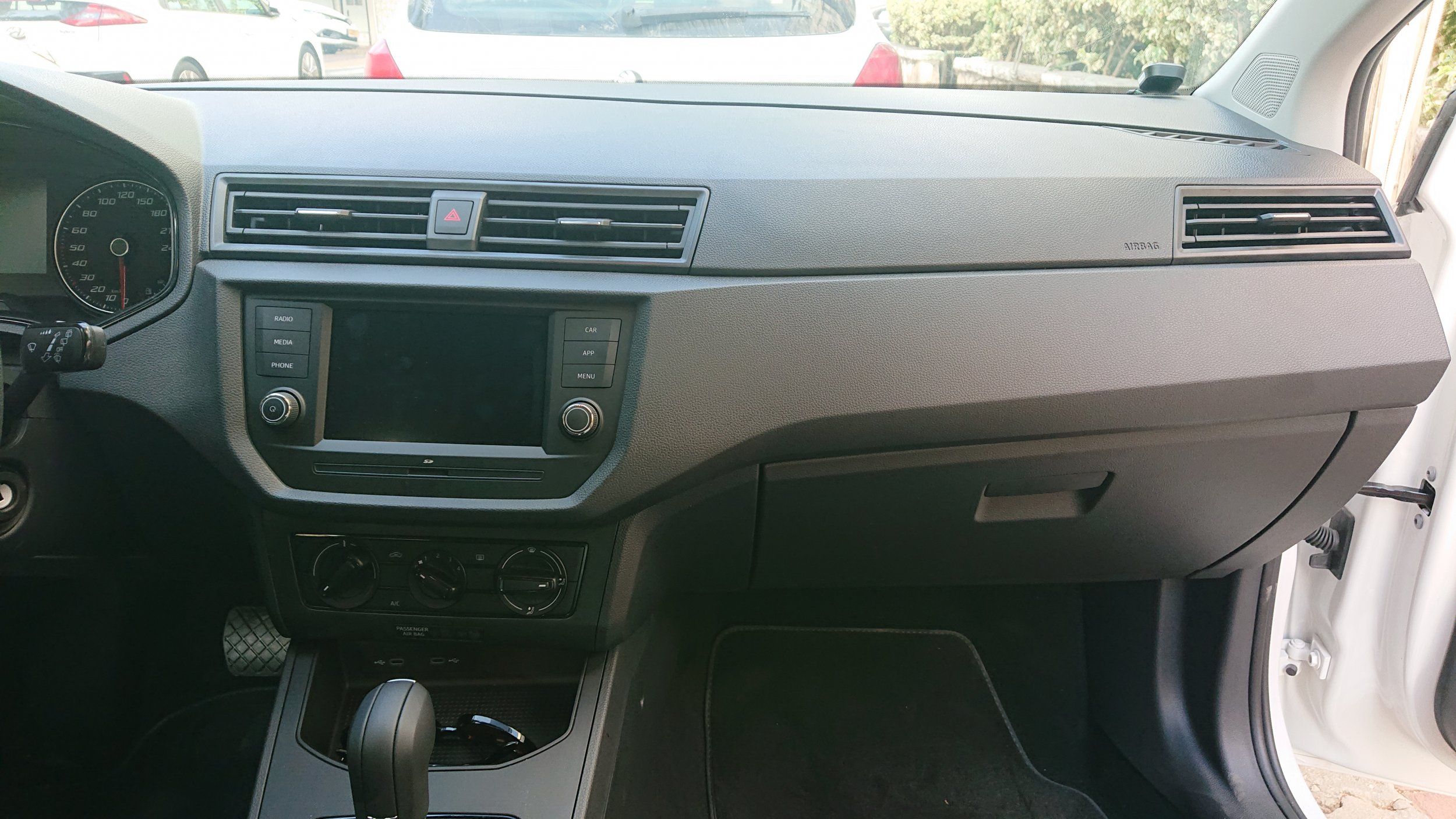

I want to install an aftermarket DSP and amplifier.
Where do I get a stereo signal from the stock system?
I was told that the radio unit is behind the glove box, but all I found there was the a\c filter.
If possible - preamp \ digital signal would be the best.
Hi-level (speaker) signal is second best, but far better than running stock..
Thanks!
Max.
What head Unit do you have?
If you have a module in glovebox, then thats wherr the is connector is for like a hi/low converter or hi output...
Verstuurd vanaf mijn SM-G985F met Tapatalk
This is what it looks like:
