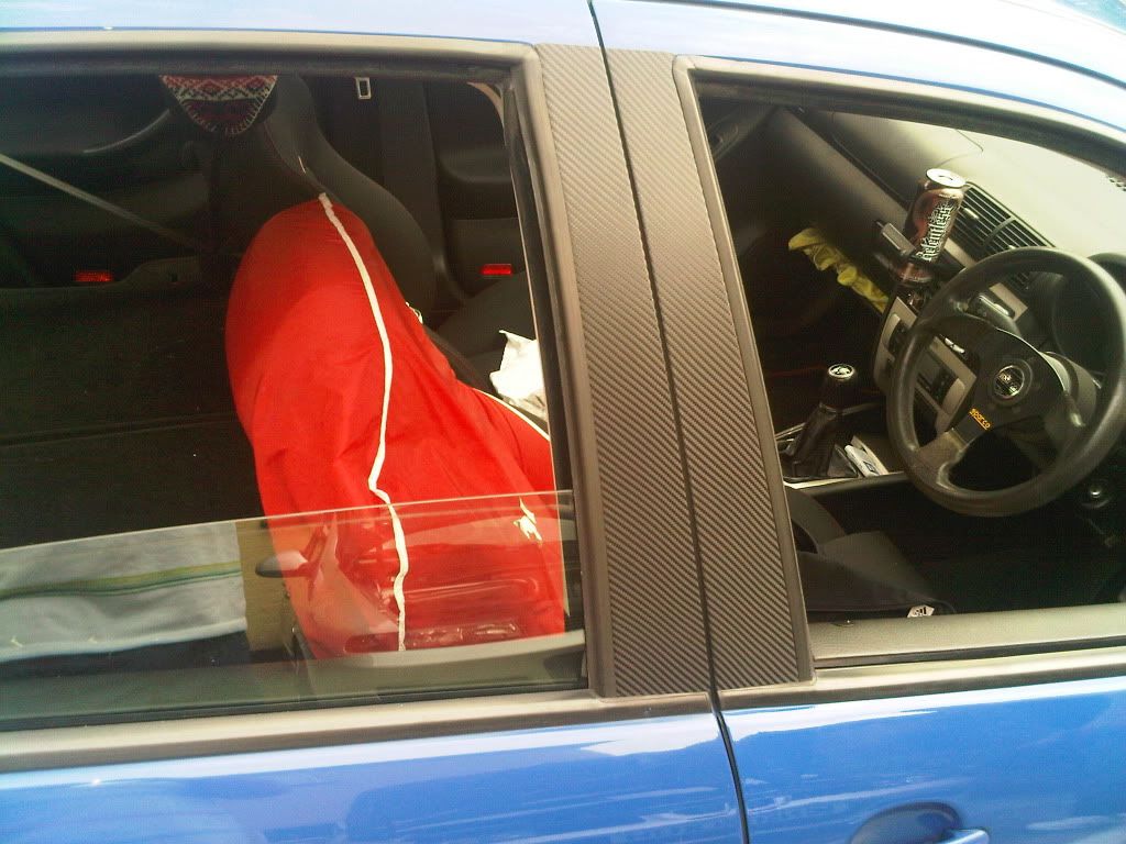

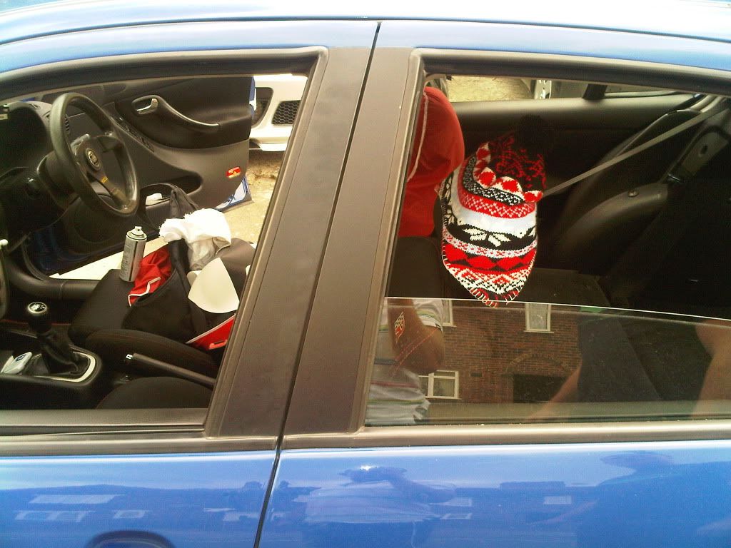

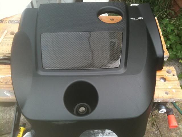

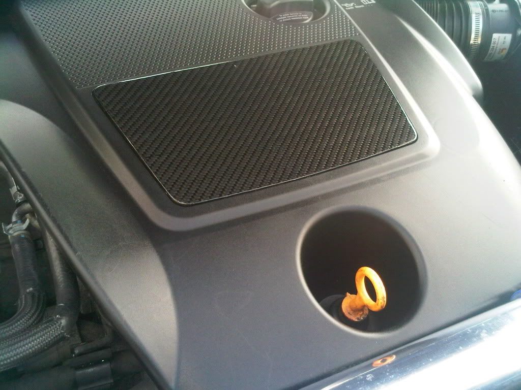

ok i had a little trip to DK's house yesterday to have some little bits carboned up so here they are
before
after

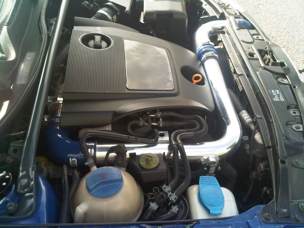

also dk is doing a special little bit of carbon for me under the bonnet, but there will be piccies when this is done...my car is also booked in for limo black window tints next friday:)

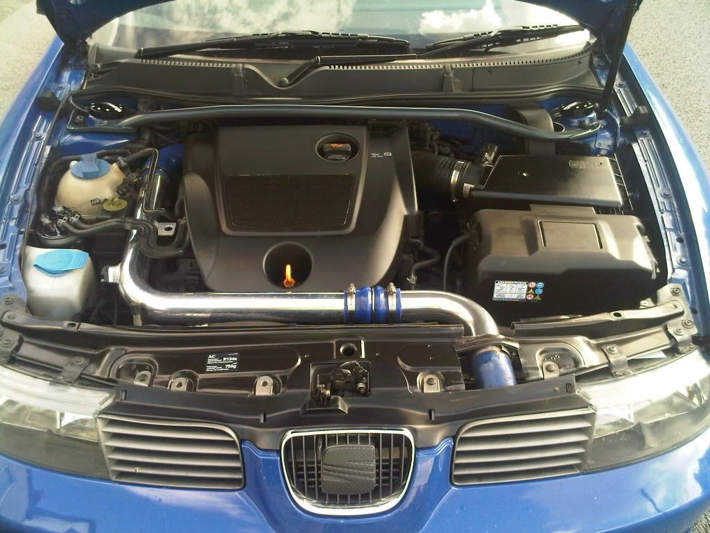

a few more subtle bits done since i last come on here, car goes back to amd next wednesday for an actuator adjust and a new map
