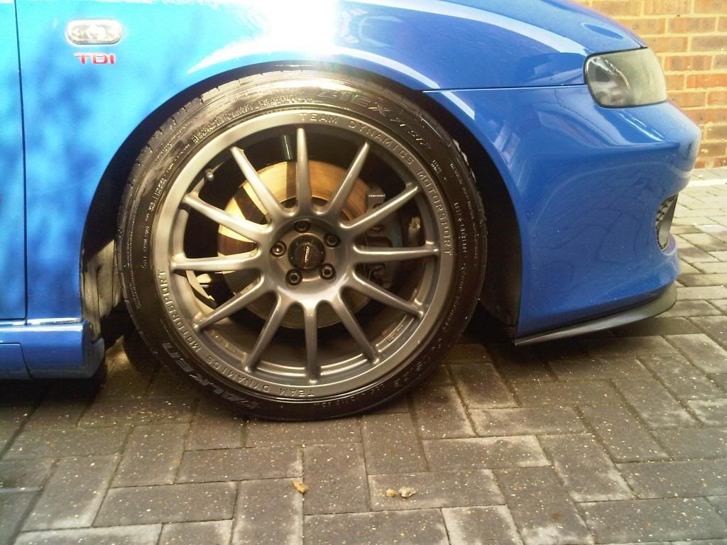

Funny that, when lowering to about 55-60mm you have only left 1-1.5cm between driveshaft and subframe which is essentially neccesary to keep the suspension working...
Go lower and the driveshaft will have contact with the frame at the first street bump you drive over, unless you weld some halfpipes into the frame.

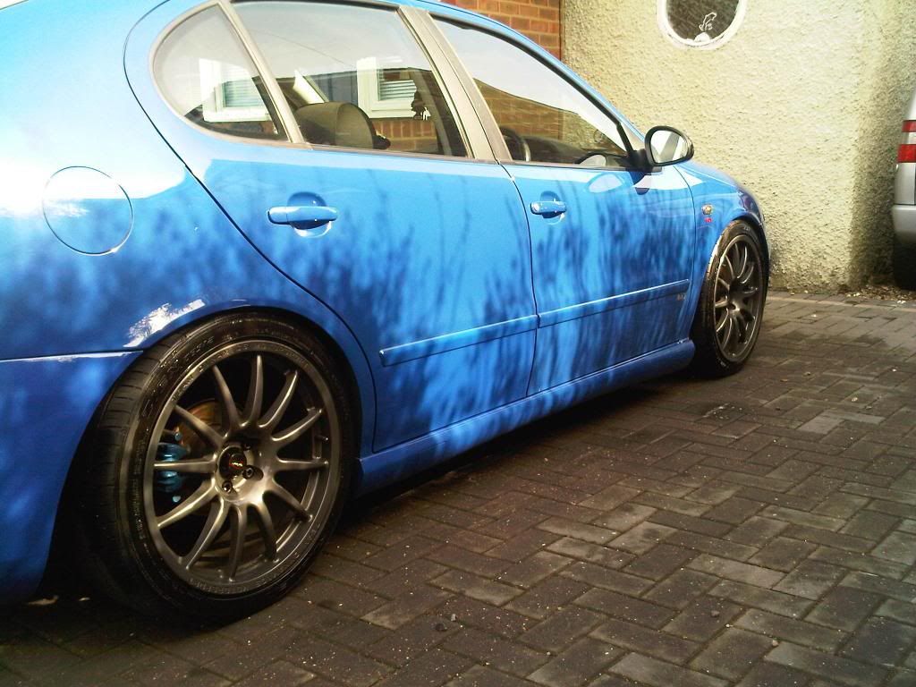

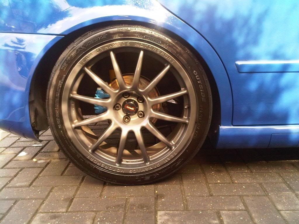

ok after fitting my front coilies and me being lazzy it took another week for me to lower the back here is the rear ride height before coilies
and the gentleman helping me
then brad decided to self harm with a ratchet in te side of the head
after me patching him up these are the results after a clean too
i am happy with the resukts and the car drives well....

Thats as low as I had mine initially and I bet you that you raise it because even the smallest road hump will ruin the front splitter. It also makes the handling worse as the driveshafts are pointing in wrong direction.
