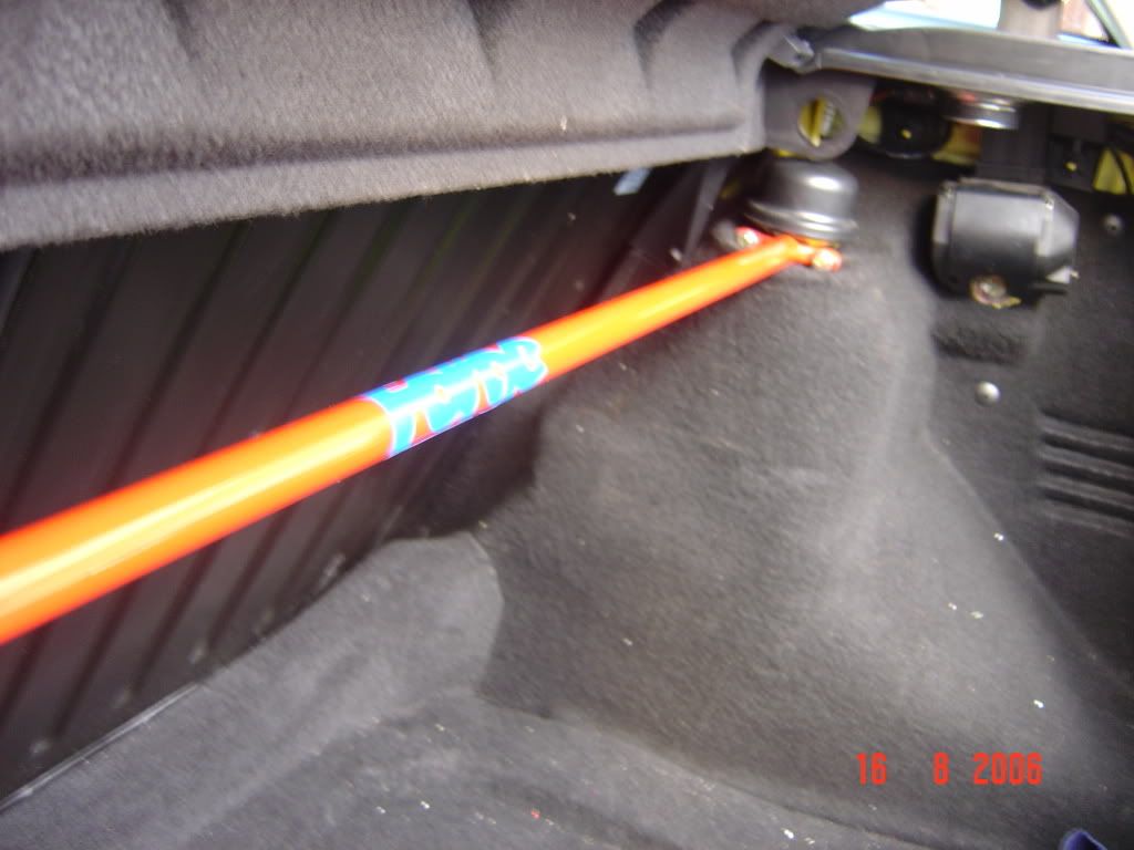

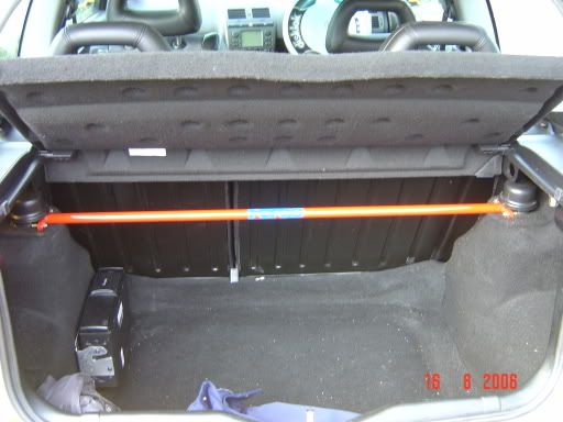

CatB1 said:
Made my own with heavy duty exhaust hangers & a piece of electrical conduit.Cost £2.48.
Pete
where did you get the parts from mate going to make my own the same way you have:D
Heavy duty exhaust hanger's and a piece of electrical conduit.Just welded the hanger's to either end of the conduit.It was trial & error getting the dimension correct.Applied heat shrink sleeving around the hanger.Don't tighten too much when assembling as it can pull the towers in(the parcel shelf will sit proud if too tight).Good luck.Much more fun than buying one.
Pete
