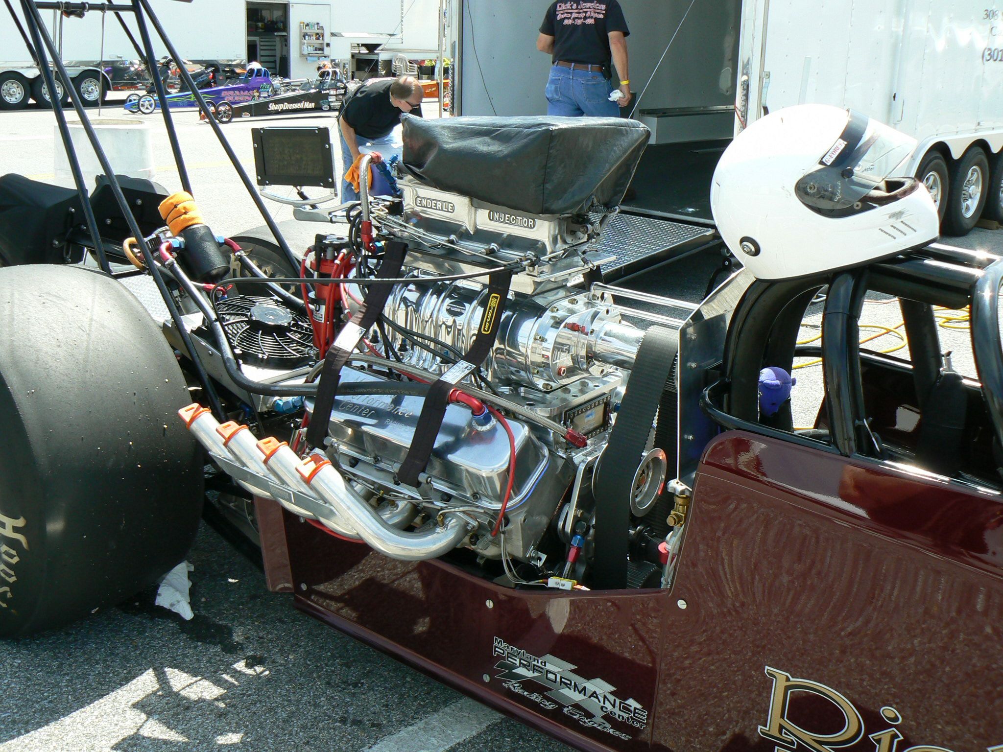

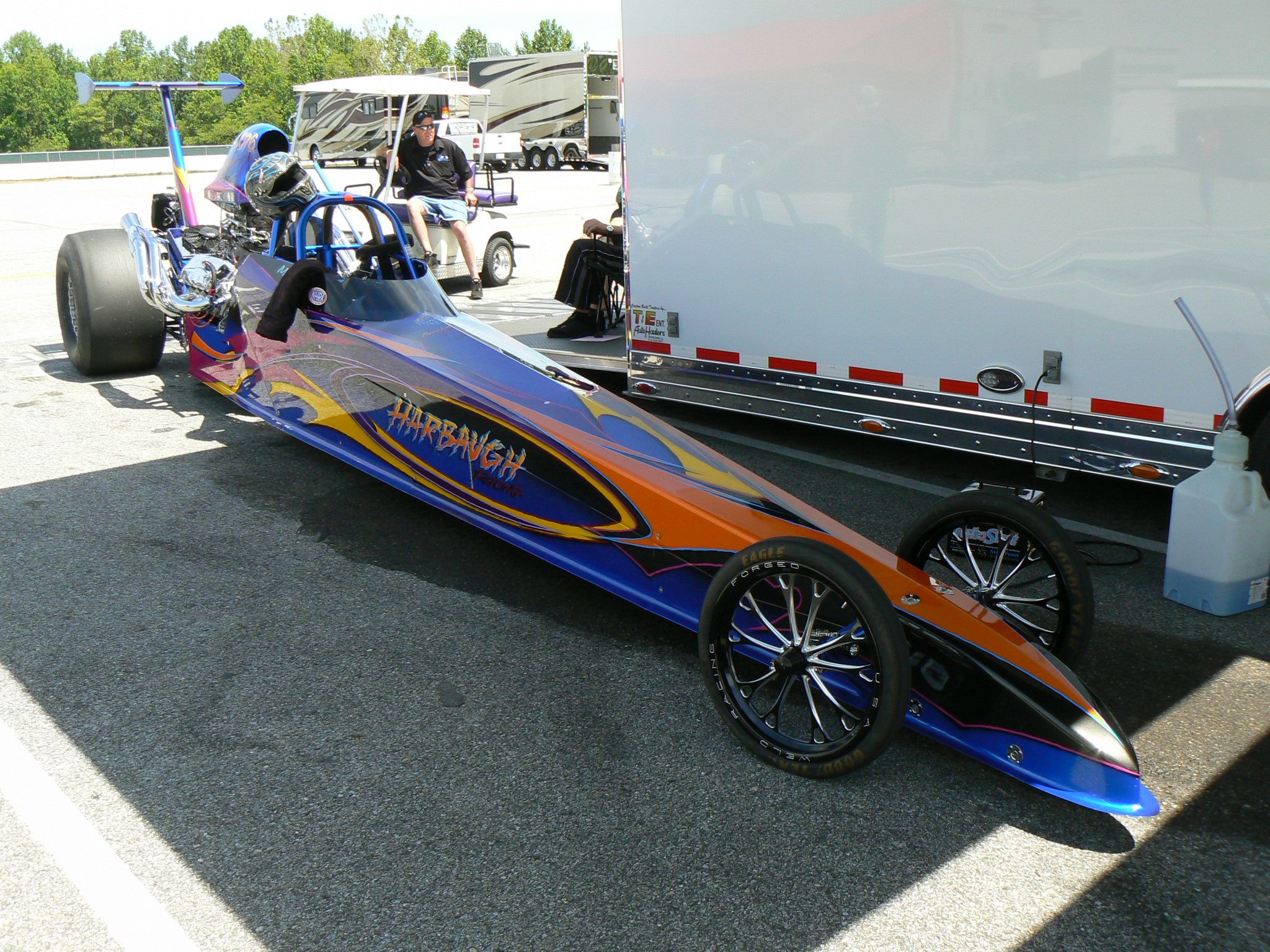

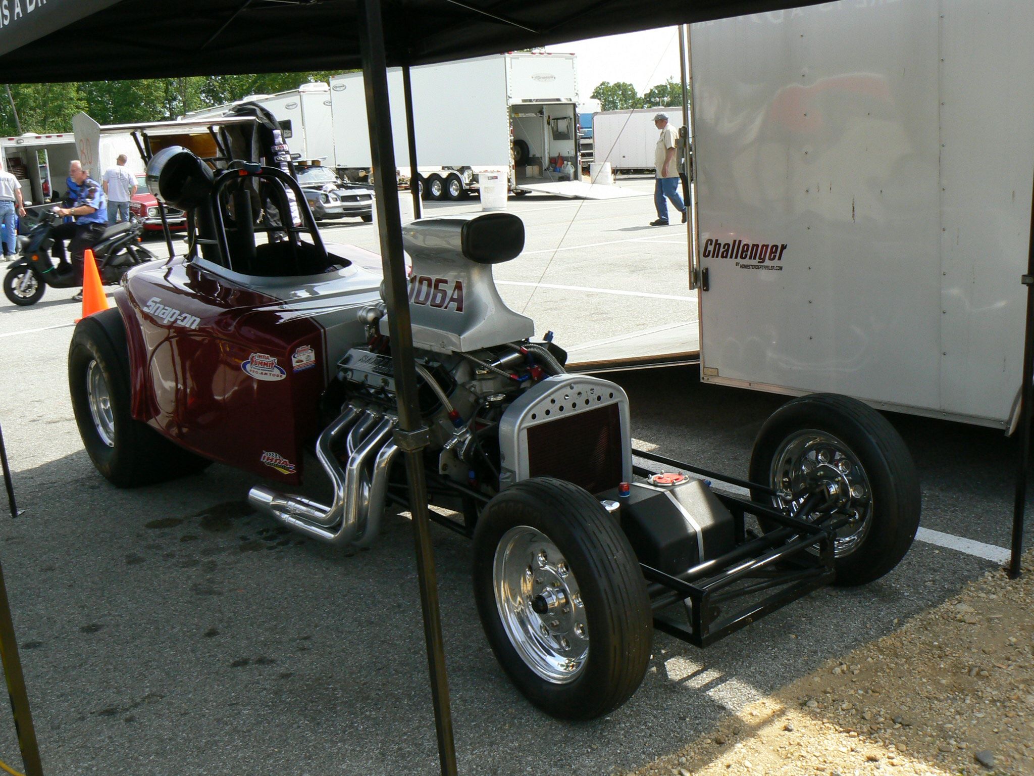

Absolutely, No free lunch here! About 10 years ago I was over visiting my daughter and her family in Southern Maryland and my son in law, knowing I am interested in any form of motor sport - he didn't know I was interested in Drag Racing at that time - Asked if I'd like to spend the day at Budds Creek watching some Drag Racing. https://ism3.infinityprosports.com/...ebuilder/sites/201601/www/en/track/map-facts/ It was a moderate sized meeting with a variety of very different machines racing and I got into conversation with a mechanic from one of the "Funny Cars" running that day. They had just switched from running a big "jimmy" (GMC blower) mechanically driven from the crankshaft - much like the one in that video I posted - to running twin turbos (one on each bank of cylinders. Their engine was making quite a bit more power once it got up on the turbos but they were having problems launching off the line. Trouble with a turbo is it doesn't really start to blow until the engine is under load so you can sit and rev it all you like but when you drop the clutch and try to make it take off it just bogs down. We had an absolutely fascinating conversation about all the strategies they were trying, over fueling to try to spin the turbo up was spectacular with lots of backfires and flames. Here's a few pictures taken on the day. One of the really great things about most meetings is you can wander around the pits and speak to the people involved with the cars, very like speed hilclimbing and I've always found everyone very friendly and willing to talk about their cars - as long as they are not giving away any "secrets"!
Maryland spring 2012 05-05-2012 15-28-07 2048x1536 12-05-2012 16-35-30 2048x1536.JPG
Maryland spring 2012 05-05-2012 15-28-07 2048x1536 12-05-2012 16-47-07 2048x1536.JPG
Maryland spring 2012 05-05-2012 15-28-07 2048x1536 12-05-2012 19-03-44 2048x1536.JPG
Maryland spring 2012 05-05-2012 15-28-07 2048x1536 12-05-2012 20-13-13 2048x1536.JPG

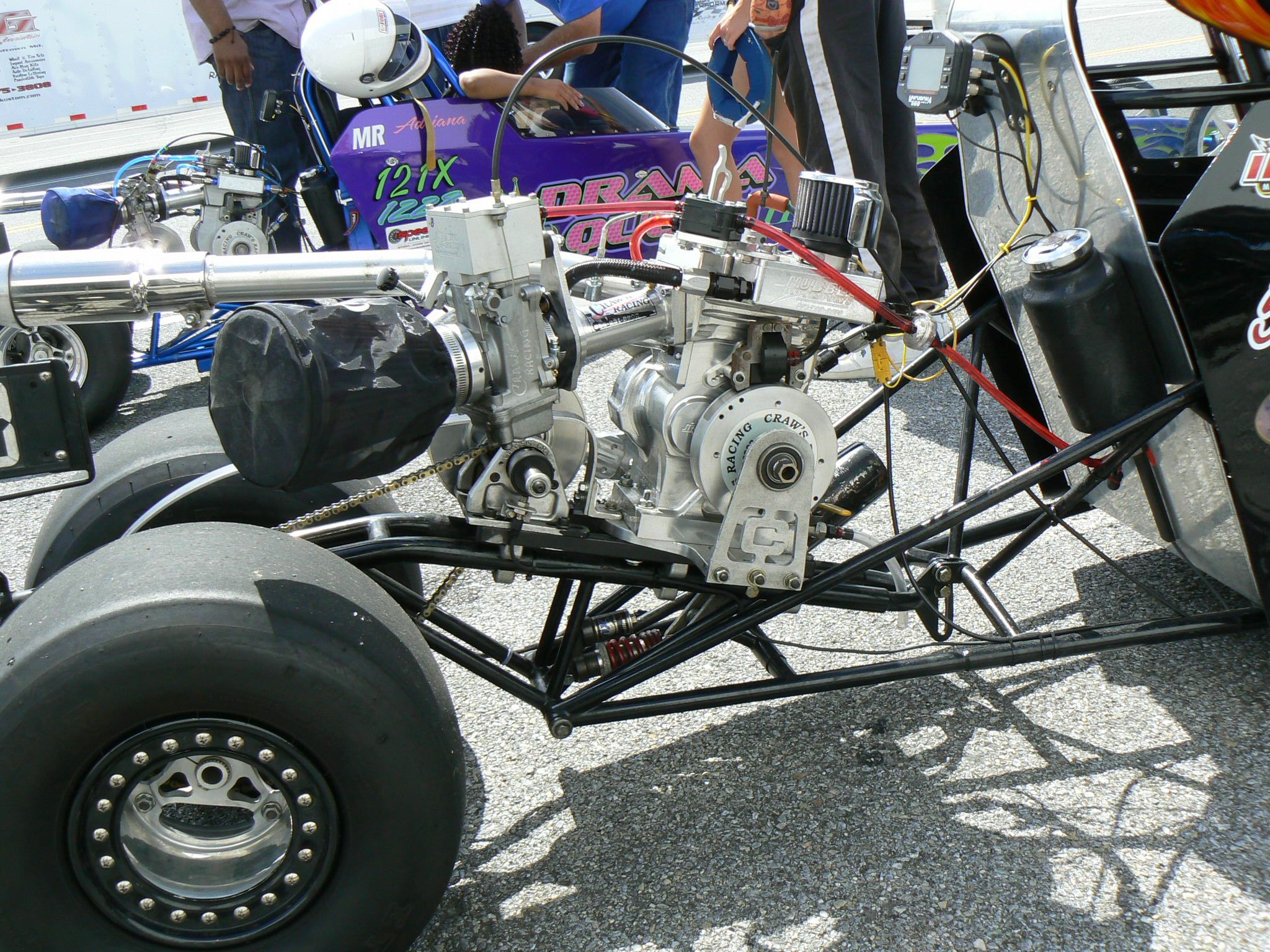

They also have a "Junior Dragster" class for the kids. This is very serious stuff if a liitle underwhelming to watch after the "Big Boys" have been out to play but engineering wise it's fascinating. Here's the power unit in one:
Maryland spring 2012 05-05-2012 15-28-07 2048x1536 12-05-2012 19-51-59 2048x1536.JPG
Based I believe on Briggs and Stratton designs the engines are absolute works of art and, from the way these little cars go, obviously produce a lot more power than any lawnmower engine I've ever seen. I found them especially interesting because I worked with horticultural machines for the last 15 years of my working life and I couldn't tell you how many of these wee side valve (or "Flathead" or "L head" as our cousins across the pond call them) engines I've had in pieces.
