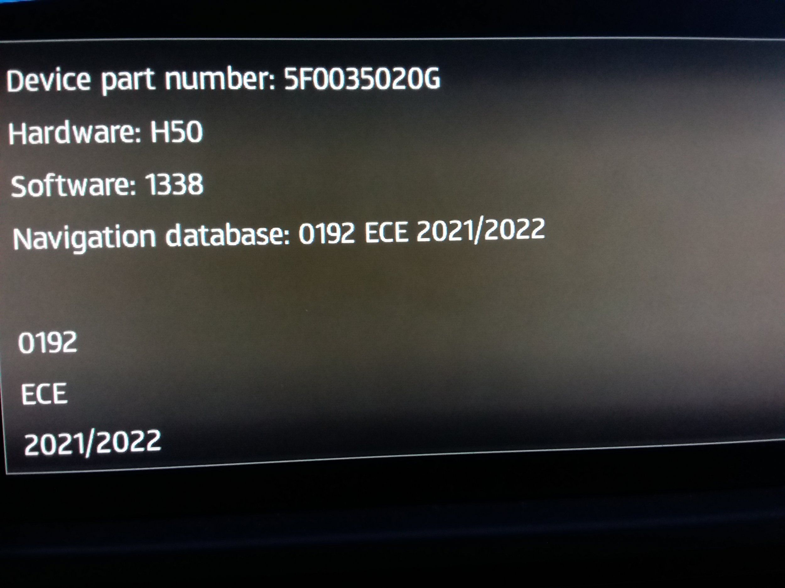

Well the prize goes to @jpmedia who created a dummy patch module for me that I put in the patch folder, then ran the addFeC from the module he created - no ambiguity there :footysup:. So I'm still at 1338, kept my radio presets, graphics etc etc.

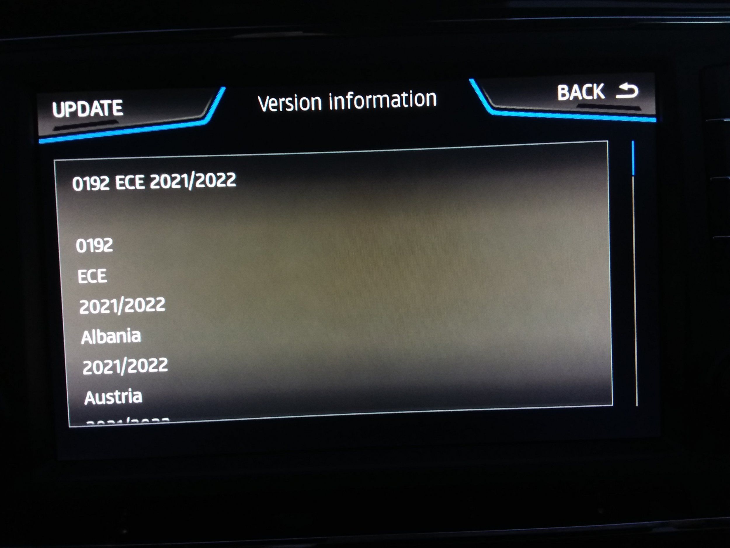

That went in without an issue, FeCs appeared. I can see the map 192 download now in SWDL marked up with Y for updates now :love:. Have Seat and Skoda navigation FeCs.
Just got to take it for a spin tomorrow to make sure it reads traffic signs OK (TSR) then I'll do the map update.... & TSR is fine.
Thanks all.

Well
I feel sad that we put so much time into writing down stuff here, only to hear "I'm ignoring you"... But it's a free country, and i guess some people make a good living because of stuff like this

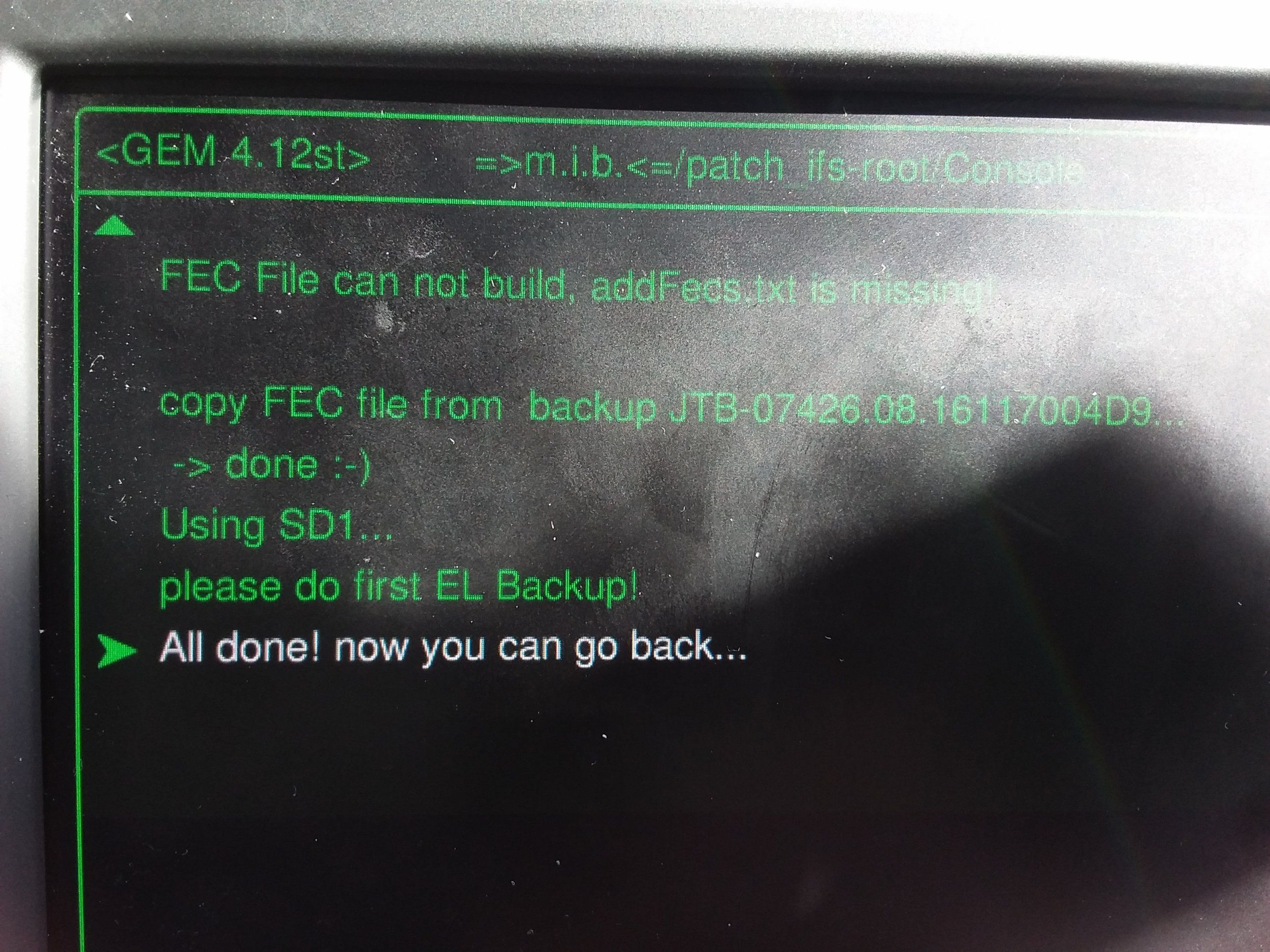

Well Mib-wiki's didn't work... came back in having found it didn't work and had JPMedia post that did work.

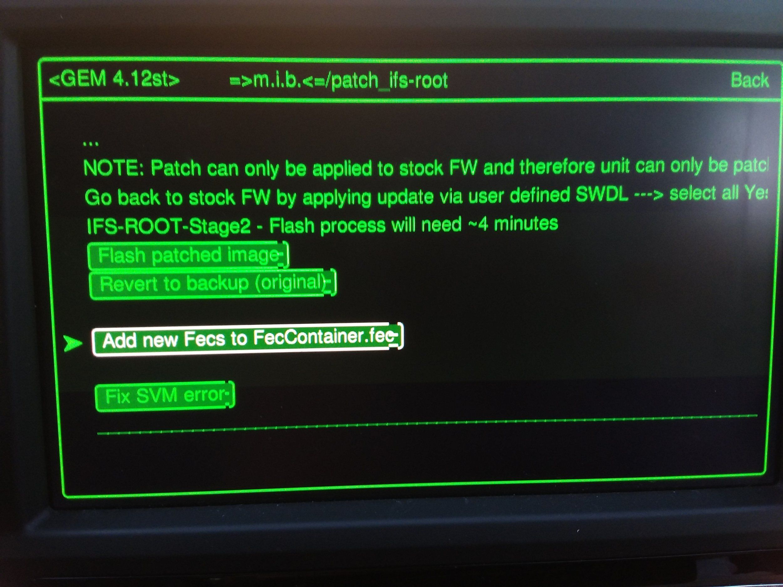

Mib-wiki wasn't clear whether it needed just the Skoda FeC or what. Tried the Skoda FeC but couldn't find it. Went on about back up. I had backed it up... wanted to take it from there but where.
I had an agreement with JPMedia that he was going to do the bits for me yesterday, so once something is agreed you do it. Put me in an odd situation when parties were chopping and changing about whether I should go for 1447. Chillout at one point indicating since it was a retrofit then I could run into an issues. M.I.B. documentation written as if you couldn't run it if you were not on the firmware release. Wrong. Just needs GEM above 4.1 then you can back up and start thinking about doing things.
The navigation FeC update command not clear about where the FeCs should be and whether to include the old or whether it was an update.
The problem is DEB is all in German. The 1447 release isn't documented too well since it's got live forum chatter that's superseded in the files. So you read issues... but they have been fixed.
I know two others here that want to update but having read the DEB and Mib Tools before I said anything decided not to touch it. Too complicated. I suspected they would be happy with the JPMedia approach of keeping their current release but just extending the FeCs but then I'm not sure that it is universal. Needs documenting rather than barking AddFeCs but to where etc etc etc.
I feel sad we have good software but needs to be better documented. Less use of spoilers in posts and just clear documentation with diagrams etc.
As for the statement of trying to push people to commercial retro-fitters by worrying them. Few things going on here. Poor documentation of the product and you know what.
I'm not sure whether @jpmedia want to be deluged by people wanting just the FeC upgrade to an unlisted firmware release in M.I.B. or whether the solution I got was because the retrofitter had left it not locked down to mod.
Btw just got to test TSR tomorrow.

NEW - FEC Generator:
M.I.B is now generating custom FecContainer.fec files based on existing FecContainer.fec and addfec.txt in patch folder.
addfec.txt can be edited with any ASCII editor (Notepad++). Only not yet existing FECs will be added to container during the process.
No need to change FECContainer.fec with WhatTheFec tool. Original FECs in container will continue to work even without patch on unit.
It is recommended to switch to this method and replace existing ExceptionList.txt with original (empty) versions.
Just run "Add new Fecs to FecContainer.fec" script in M.I.B -> PATCH.

The basics, even how to create a "dummy folder" for your FW is in there, also a discription about how to work with addfec.txt
+ all the already included patches it does not take rocket science to get this
+ you could have asked directly
Google Translation of DEB is also very readable...
1st post contains all the information required to update to 1447.
Also this thread has them all further up.

THis error is related to a technisat conversion? meanin install 05xx software on 02 xx 03xx 04xx hW revision units?
If Technisat can be NAV CID CFG file, or conversion .if patched over sd update with right prepared files and later rerun fw update error gone away...
It's not a Technisat unit, it's a Harman MIB2, HW42, originally SW0319 then updated in stages, 0674, 0818, 0897, 1219 then I had the FEC's 'modded' and it then showed that 1556 error. When the FEC 'expired' I had new maps installed by a 'retrofitter' and SW1409 installed.
MIB-Wiki
Oct 8, 2020
70
56
Try installing M.I.B and create an advanced backup, share this with me (PN).
You want to stay on the current FW and just fix your FECs? Or also update?
1556 indicates, that you have Mixed FW versions installed on your unit. A full SWDL FW Update should fix it.
Gesendet von iPhone mit Tapatalk

As MIB-Wiki said its to do a full swdl install selecting all, enable develeper mode, enter servicemenu tap on swdl then start manual download select all.
Had to do 3 Times on a upflashed H41 sw0123 to 1447.
Reactions: Walone
Tell
Full Member
Mib Tools installed fine for me but unlike a map upload via SWDL.... The bar moves quickly, the reboots are slow during Mib Tool installation, main thing is to keep the power on, engine running or power charger if a weak battery, but only a 5 minute activity in reality.
Now loading up 192 maps.
The FeC update screen:
Note the clear SVM hangs off that screen (haven't tried that yet).
Wow success:
Thanks again.
Reactions: Walone
