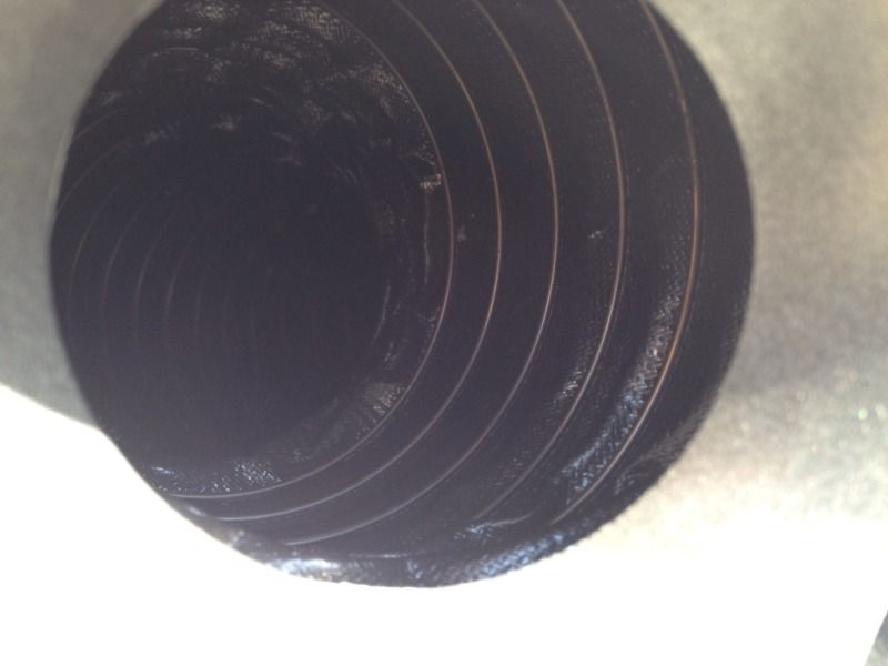

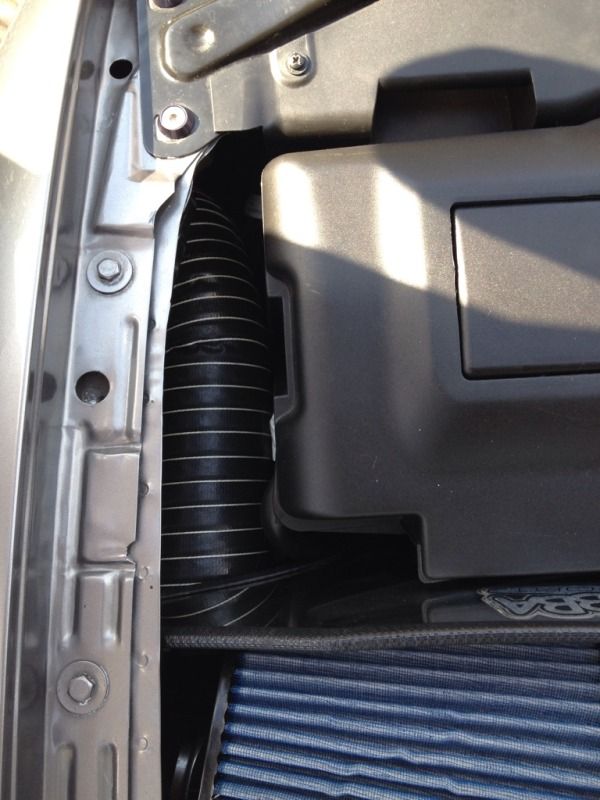

Got my 3" Neoprene cold air feed fitted today thanks to the help from my friend Martin.
We had to remove part of the original cold feed which runs to the standard airboxes, the small bit of plastic that sits in the corner and is mounted below the passenger headlight. Very annoying piece to remove but by jacking the car up and looseing the inner wheel arch lining on the passenger side, we were able to get access up to the clip which very tightly secures in this part of the oem cold air feed. So with that out of the way we inserted the ducting from the front passenger fog cover area and fed it up all the way to the jabba shield, just as I had hoped for :)
Worked out perfectly by buying 1 meter of the stuff and it now looks like this.
Mounted where the fog used to be for good air intake :)
Top down view, very snug fit! Anything more than 3" ducting and it will be too tight IMO.
With that installed I wanted to see how it drove on the way home, and I have noticed a slight improvement low down tbh. I couldn't really open it up but should be able to a bit tomorrow morning. Certainly feels better though.
