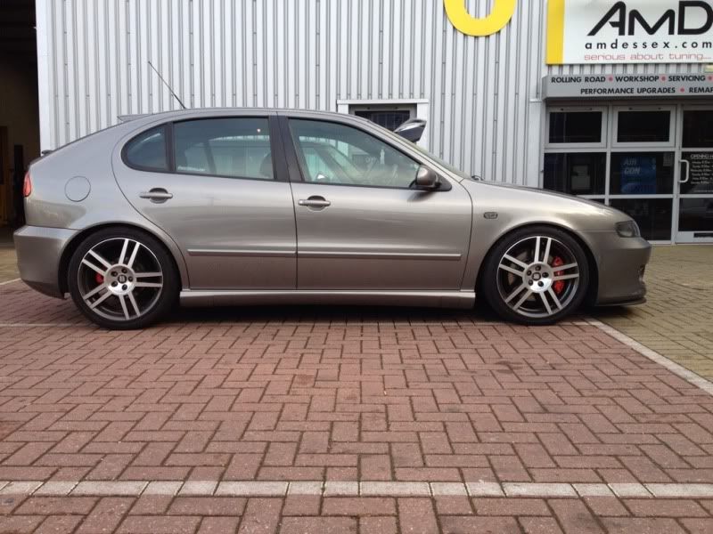

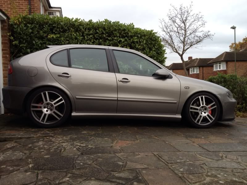

Erm yes I have mate.. Not much though! It's not crazy low. I'll put a pic up in a moment.
I get over bumps just fine at the moment, as there aren't really many in my area! :happy:
Nick wanted to re-fit the B5 TIP to see if it'd be any better but I've held off and just ordered an SFS 3" one while I was down there for a good price.. :)

Thanks to AmD for the above work! Top service as usual from the guys there. Nick was really helpful today and gave me some great advice for the car.
