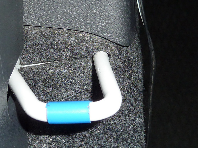

Try wrapping a few layers of electrical tape round the rear seat locks, had this on my GTD and was a known issue with Golfs - sounds like someone is knocking from outside the car.
Hopefully it is something as easy as that!
I had this issue on my 2017 FR, dealer said it was a common issue with Leons and they adjusted the alignment of the boot which sorted it straight away. May not be the same issue but might be worth checking if you have warranty. Otherwise taping up the rear seat latches may work as I know this can also cause rattles.
My rear boot rattle came from this..
So I just wrapped a couple of layers of electrical tape on there and no more rattle.. Doesn't wear or tear either. Been on there for ages now....

Didn't tell me exactly what it was but did tell me a bunch of things it wasn't. Wrapped a few turns of electrical tape around the striker pin, went for a drive and... no rattles! Happy days.

its the striker pin on the boot latch , use electrical tape around it and the rattle is gone . the pin is on the edge of the boot trim which the upper latch locks in. i had the same problem . drove me mad.
