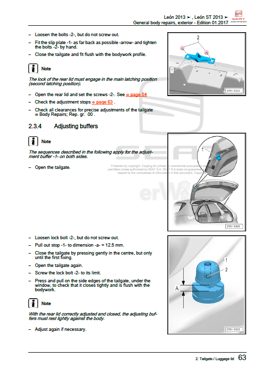

Can anyone please explain how to adjust bump stops and this:
I read somewhere that i can adjust this thing, meaning get it to lower or higher position by adjusting some screws which are probably below this plastic ?
As for the bump stops, they wont move a bit.
Thank you very much but i have so much problems to understand those Seat manuals. Yes, i am not from english speech area but they seem to be understandable only for those who wrote it. :mad:
Fit the plate "as far back as possible" , what does that mean ? I don't see how can i adjust its up/down position .
How do i remove the plastic trip which is above the plate ?
Regarding the buffers, it's even more incomprehensible. It sais "loosen lock bolt 2" , but i don't see bolt 2 at all. After that i should pull something out !? I think im gonna give up on this on my own. :)
EDIT: I just went out to the car to take a look, didn't realise that there there is a tiny whole within the buffer with the little screw below. I should probably unscrew a bit and pull the plastic holder for one "tooth" .Regarding the striker pin, i got it, it goes up/down not by the depth but width.
I managed to unscrew them but i dont know how to move them, can u help ? Almost screew them out. I wanted to push them a bit more so that the boot have better grip when closed but they wont budge.

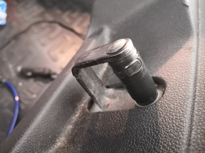

Anyway, i think i found the source of the rattle, i think its the boot lock, percisely the pliers that lock the boot against the striker pin. They rattle i think, the have a slack and they play and make exactly the noise i am experiencing.
I don't know what to do with it, i can buy a new one but the problem is that in that case i need to remove the boot trim which is probably imposible without severe damage (been there, done that, already bought a new one once) . Or, i can try adjusting the striker pin but it also needs trim removal which i dont know how to do and i am sooo anxious with those clip trims.

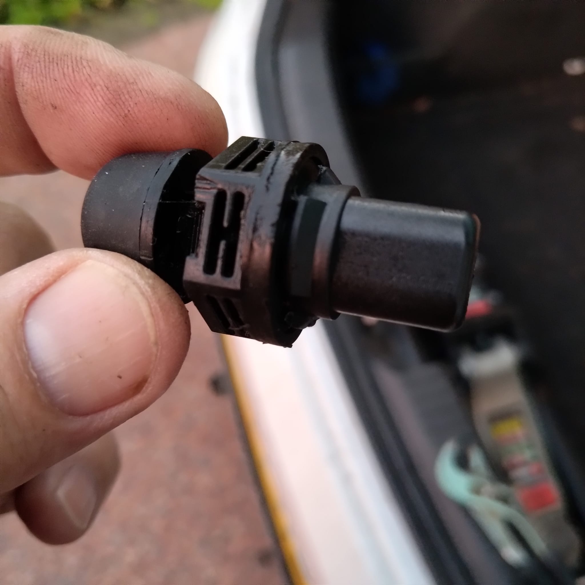

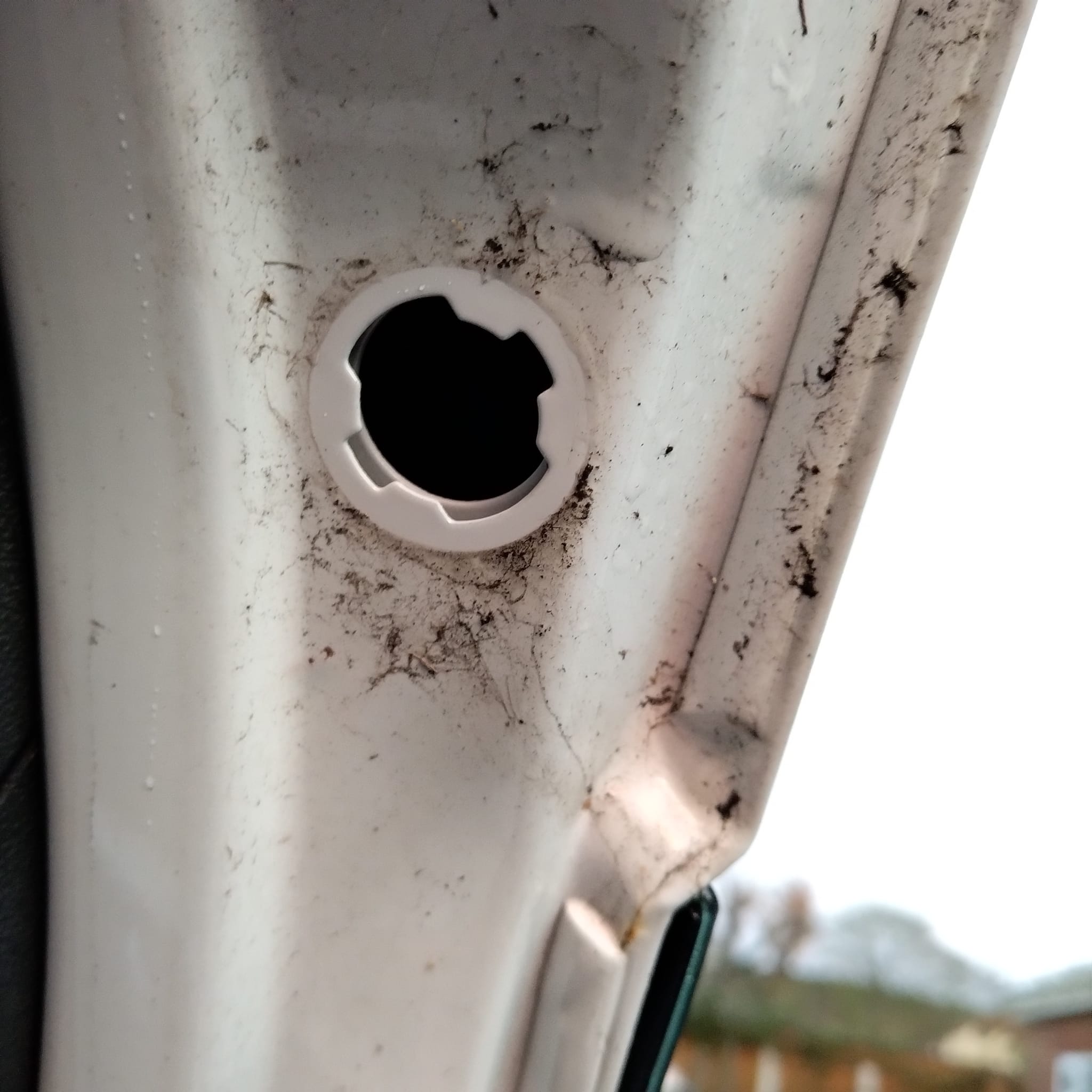

ok firstly let me share two pictures I took just now.
As you can see the stopper using the bottom park locks into the boot lid, I can see there is a thread on the top section but according to the instructions there is a lock nut (I am guessing its under the rubber bit) that you can undo and adjust the gap.

Never needed to adjust the lock part but based on the pictures in my original post you will have to remove the trim (If you need those pages let me know) and then undo the two nuts and pull the unit down as far as it can go. Or (and this is a pure guess) if you put some tape around the locking part this will allow the boot to be tighter.
The other thought is to put something on the rubber grommet to make it longer or something on the car body to increase the gap (hope that makes sense)
