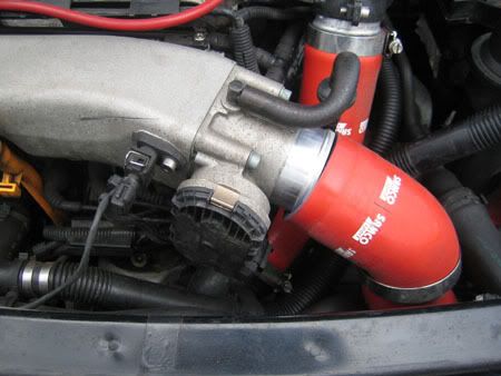

the maf is shown below right?
with the 4 blue wires and one red coming out
also whats the connection straight after the throttlebody, to the left

Put that pipe back on and buy a new maf if the TCS light stays on.

yea should have said, that pipe is only off in the picture as I was checking the throttlebody butterfly

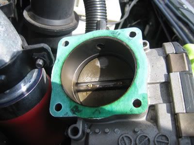

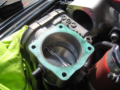

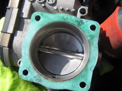

UPDATE
Still really stuck
Today, I have checked the maf isn't the problem, jabbasport thought thats what it might be, it isnt that maf
I took off and cleaned the throttle body fully
checked the ECU area and it's got a nice cover to protect it from getting wet by the looks of it
disconnected the battery for 20-30 mins while doing the work
Did a throttle body allignment and then started the car
TCS and EPC permanently on, car was idling fine at 1200 revs
Then after 30 seconds it suddenly missed and went from 1200 down to 1000 revs, then it shot back up again to 1200, and did that a few times
then it decided to struggle really badly and was struggling and running rough at about 1000 revs
holding revs to 2000 and then letting them drop and it didnt settle or help
the only fault came up last time with vag com was
17953 - Throttle Valve Controller: Malfunction
P1545 - 35-10 - - - Intermittent
Might hook it up to vag com again later, someone local has it, but what shall we run, last time we just ran a general fault test I think and then cleared the faults
Is it looking like maybe the throttle body needs to be replaced, 2nd hand or new one
I'm stuck and not far off booking it in with Seat

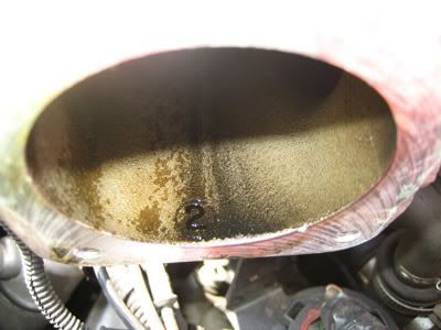

dirty throttle body, not really that bad though is it
cleaned up

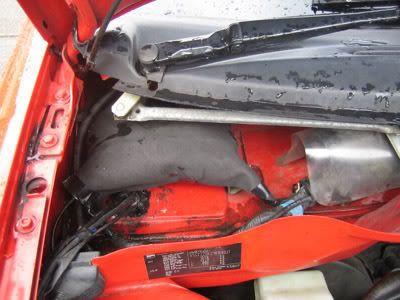

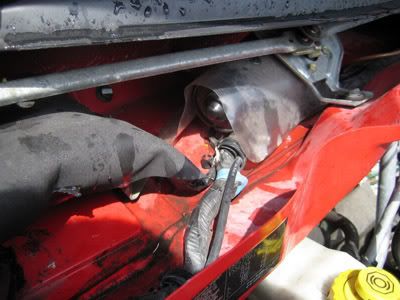

the ECU, in the top pic, it would be under that grey covering wouldnt it?
I saw the cover there and didnt take it off as it looked like it would be safe under there

All I can think of is
throttle body has had it
or ecu is wet, but it looks safe if i think its where it is

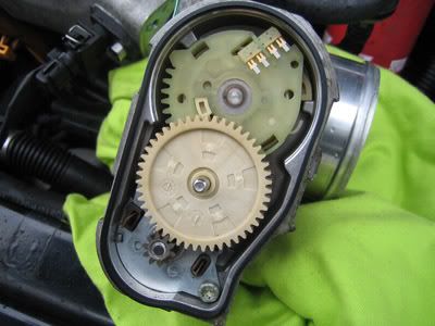

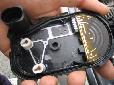

UPDATE from today
went back again, this time I took of the throttle body plastic side part and cleaned the electrics with electrical cleaner, didnt look coroded inside anyway
reconnected battery, did throttle body allignment, started the car
started better than before
Traction control TCS and EPC lights still on, but it was idling fine at 1200 revs, sitting steady, then after 2 minutes it all went wrong
revs just died to 1000, didnt lower gently like it should down to 900, just stuttered and then ran rough at 1000 revs
turned off and hooked to vagcom
faults at the throttle body, clear them and it comes straight back
and also an abs fault which explains the EPC and TCS lights

as you can see the ecu is safe under here, water proof cover
inside the throttle body
pdcupra
Ibiza-less
Aug 11, 2006
743
King's Lynn
id be a bit worried why that has a cover over the ecu in the first place? has it had problems with water in the ecu before you had it?
dave_6
Apr 26, 2005
193
Essex
its been remapped by jabbasport so at a guess its been put there either by them or the previous owner for safety as its a crap place for the ecu to be
