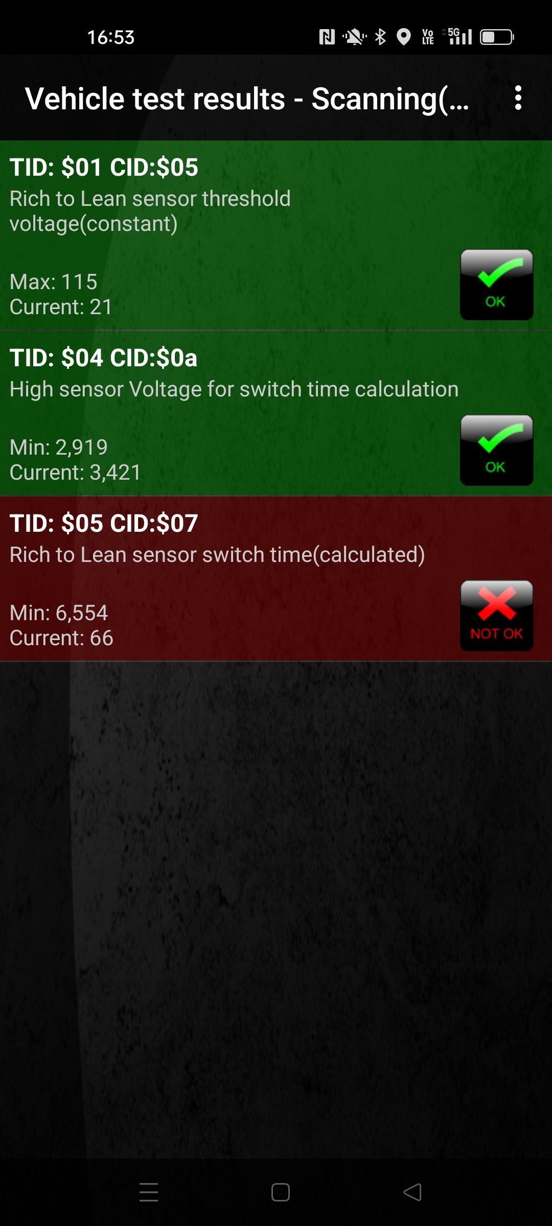

Changed that sensor and it made no difference, I've since done a live data drive and the below is showing up, it's rinsing fuel as well
I'm guessing that code is for one of the lambda sensors, but it's in a weird format. I can't see how that would effect the temp though.

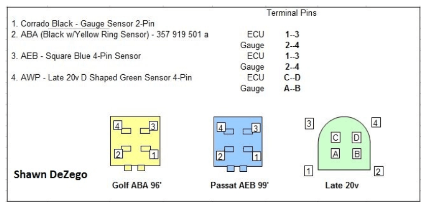

Here are the pin outs for the CTS. 2 pins feed the ECU, 2 pins feed the dash. If you put a 300ohm resistor across the gauge pins in the plug, that shoukl give you roughly 90C on the gauge for testing your wiring
