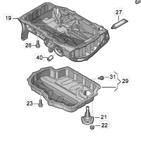

Edit:- it looks like your steel sump part is just the "lower sump" ie really just a closure to the bottom of your engine, if that is correct then it should be slightly cheaper, p/n for CPTA version of that engine which claims to be the same as CHPA, is 04E 103 602 B and the sealant is listed as being D 176 501 A1. Now, at the age of your car, maybe it makes more sense to source an aftermarket equivalent for both these parts, I've never needed to look for aftermarket steel sumps so I can't help there - but a good local motor factor should be able to find one for you, though maybe phone your local VW Group dealership parts department for a price and to confirm these part numbers.
Agree on those part numbers for the lower sump pan from a 1.4 CHPA
Additionally just in case - the bolts are:
N 107 480 01 Hexagon socket head collaredbolt, thread forming
6X16
qty
19
Looks straight forward to swap - though you'll need to also swap over your oil lever sensor - which you should probably use a new seal - 038103196B
