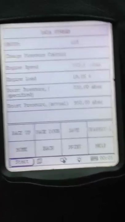

It will give you direct fault codes.
But there is no eml light on surely I would have codes appear on any diagnostics kit
