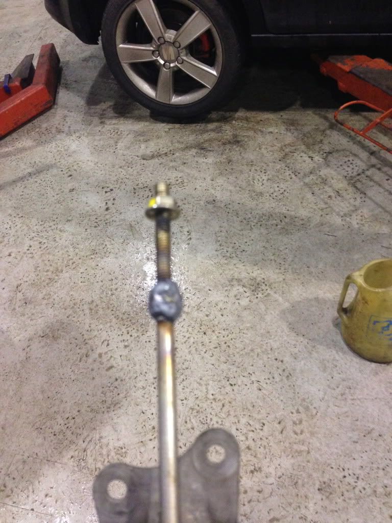

Ok car is not fixed but finally come to what is wrong with it, turns out the actuator rod/arm on the turbo has broke.

It may sound like a bodge but I think my plan is to remove the actuator and attempt to weld it back up and maybe strengthen it in some way.

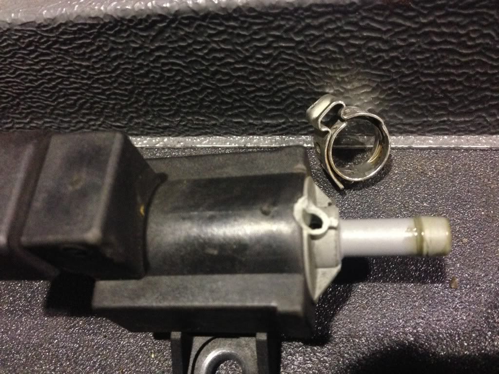

problem sorted finally, had some time today to look at it, i decided to weld the rod up as i couldn't justify spending 800quid on a new turbo, I also wasn't sure about the actacuators that were for sale on Ebay.
I broke the boost control valve in the process unfortunately so got a new one of those
actuator in place
after serval adjustment of the rod, the car is now running as it was!!
