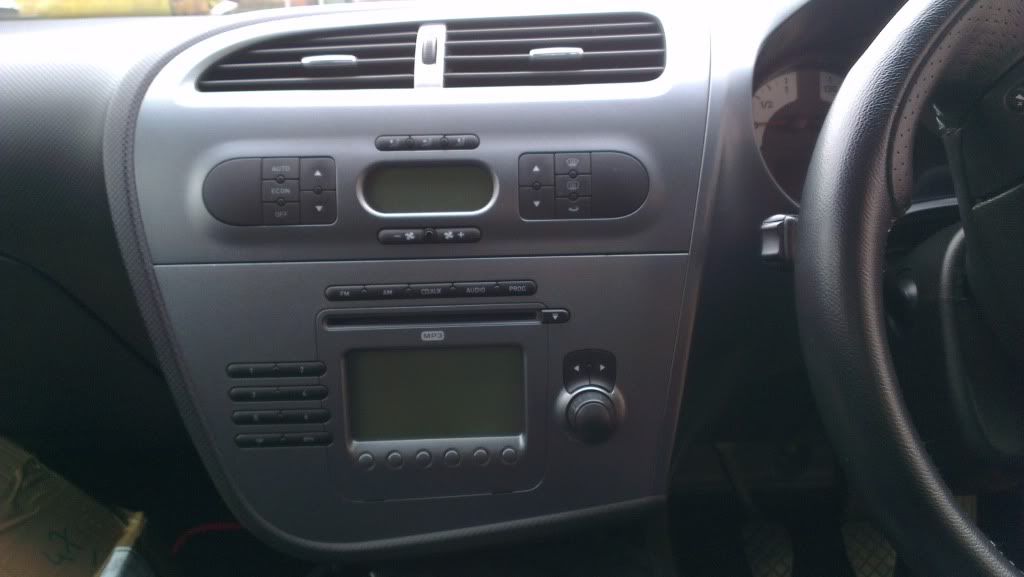

Well today, I went from this:

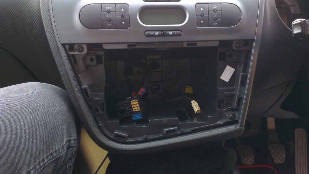

To this after a while trying to find the top left clip!!!

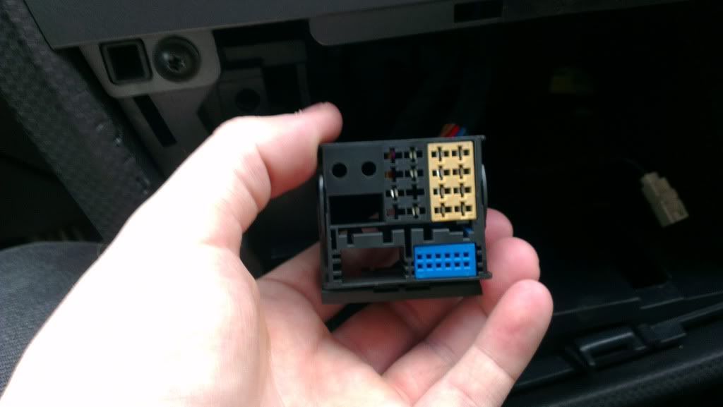

This is the connector just for reference

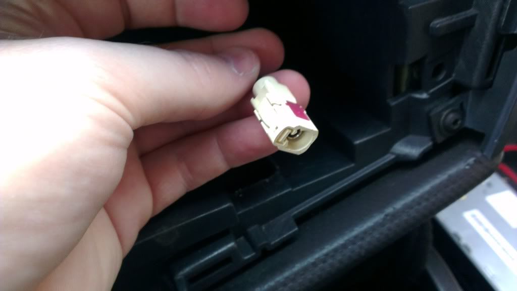

This is the aerial:

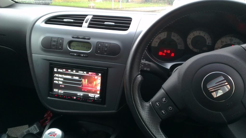

This is the new gadget! ;)
For the fascia, it was order numbers:
1P2858063N87 - Which will give a perfect match in an FR
and
3B0867190 - 9 of these are needed to keep the fascia in place.
Direct from Seat that bill (fascia and clips) came to £22.88.
Well chuffed for the minute. Haven't even scratched the surface of the options..YET.
I think I need to ground the Handbrake cable as I powered it after reading another thread. Either way, the screen stays on, just cant look at pictures or view movies on the go.
Pioneer is back up and running. Been having a few problems with the canbus block in the wiring loom. I keep getting sent busted ones :censored:
I have audio but no steering wheel controls currently.

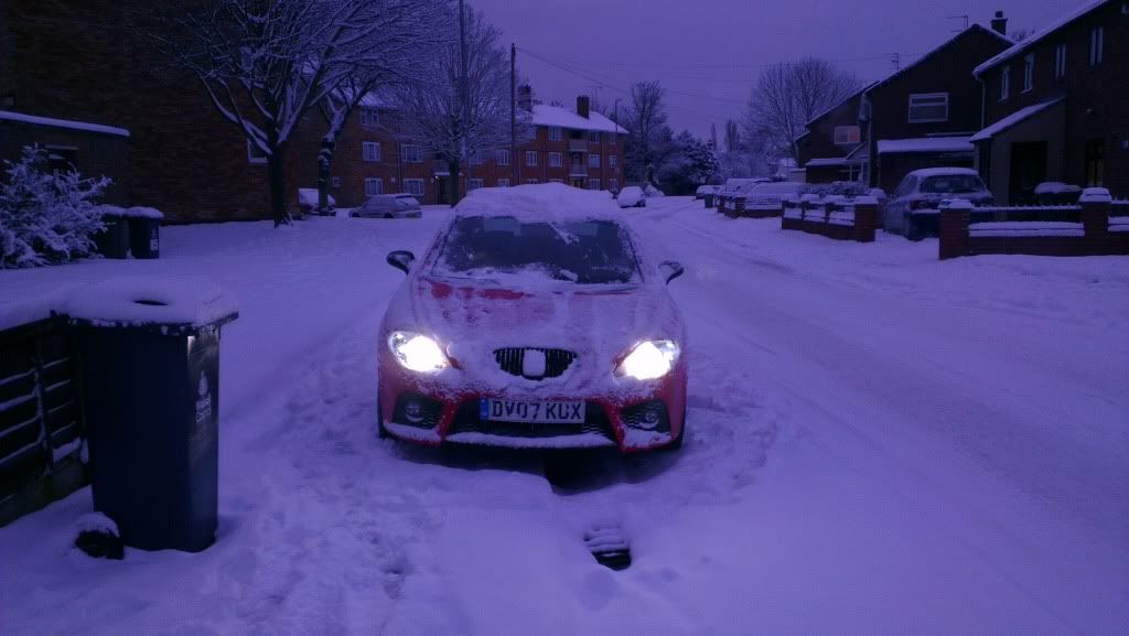

Took a picture this morning of the HIDs
They are 6000k. Crisp white. No blue once warm (this was about 30 seconds after I switched them on)
H7r bulbs which is why the camera wasn't blinded!
did you buy any adapters for the wiring or aeriel looking at this unit so this threads good to see
Adam that looks great. Been looking at getting a parrot hands free kit but after seeing this definately going to stretch to this double din unit! Youve had some time to play with now - you still happy? I see it says sat nav ready.. how do you go about setting that up?
Cheers man. The unit I have has Parrot built into it. The g/f said is sounds just like I'm on the phone to her and not as if I'm in a bubble like most. The Nav is a seperate unit. It just plugs into the rear of the headunit I have. Its about £120ish for the Nav box but I have Sat-Nav on my one X so it isn't needed.
As for still being happy, yes. I'm still chuffed to bits with it. I've just bought a sub for it all today. I have uprated Pioneer speakers in my front doors, so now that I have this head unit; it filters everything to where it should be. The sound levels are now perfect (although need a little tweaking once the Sub has bedded in).
