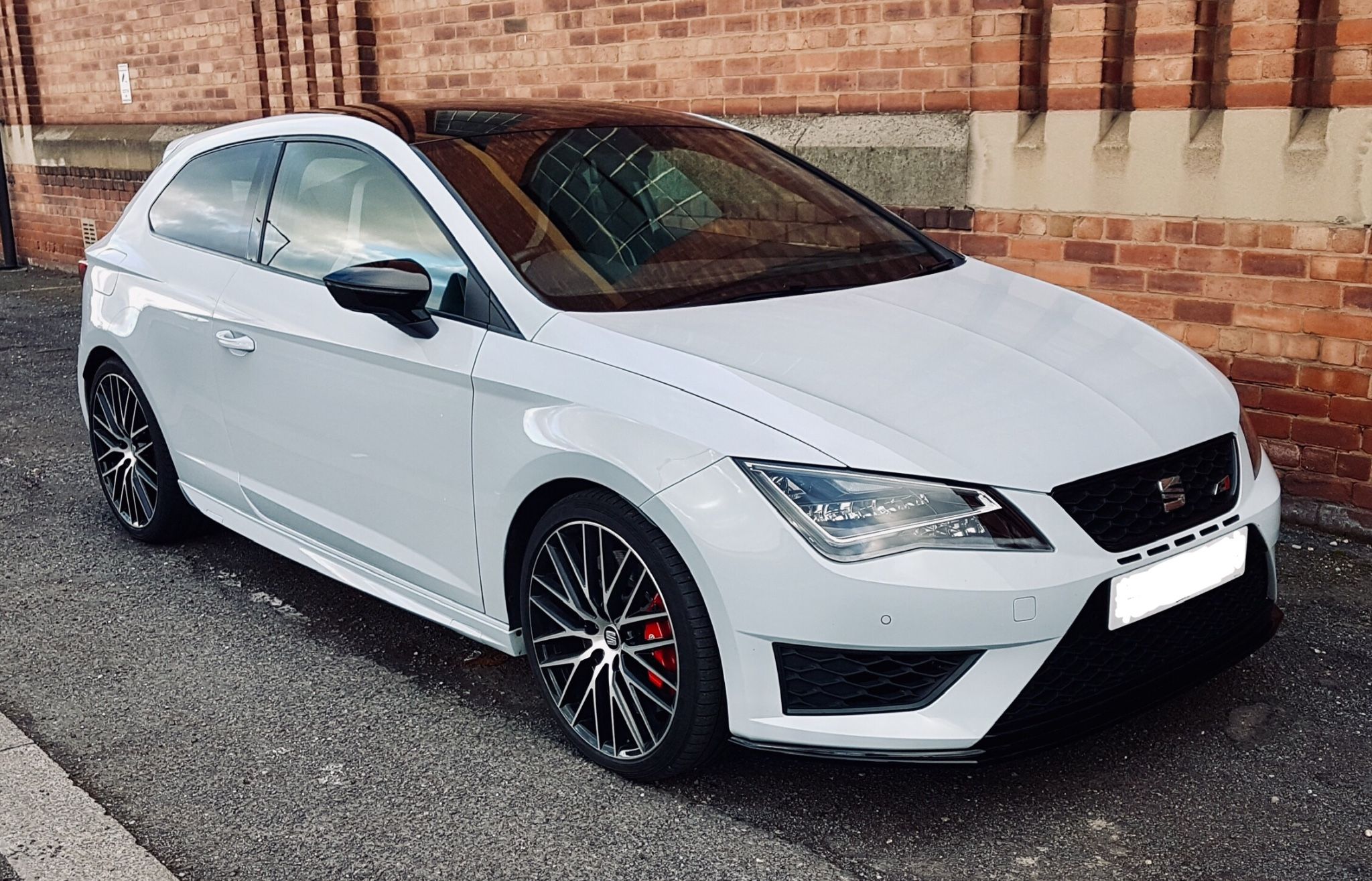

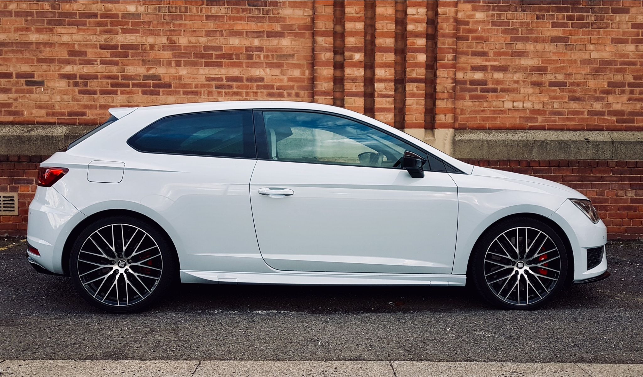

They’re all susceptible to impact damage. Personally of the 2 I’d say go Reigar, but if you plan to gonsode skirts not blades, I’d suggest painting it. Your right it extends or lowers the front of the car, but with side skirts from a distance it still looks like the front should be lower as the splitter disappears being black. It’s the reason I wrapped my 280’s splitter and had planned to paint it.
Yes. I thought about painting the TRP splitter on my 280 Monsoon Grey match the rest of the car, but ended up trading it in for the 300 4D. Haven't seen any images of a colour matched Rieger splitter on a car, so might try some photoshop magic.

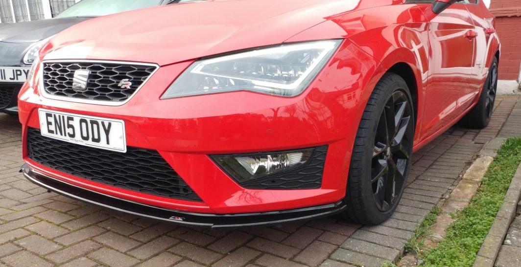

Rieger front & rear on a pre facelift

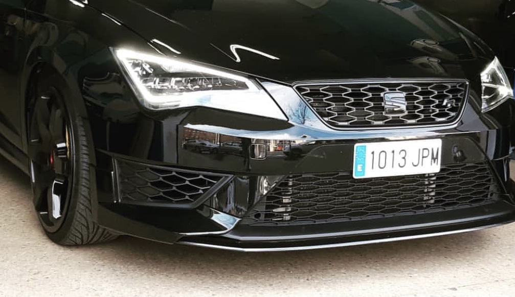

Anybody on here know where this splitter is from and where to buy? i personally think this one looks awesome, particularly the extensions to the bodywork left and right of the main grill, makes the front end so much more aggressive.
cheers

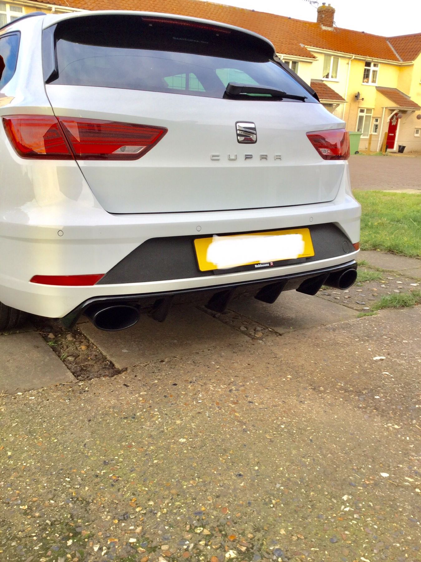

I got my Rieger diffuser and splitter - installed the diffuser yesterday and it gave me much more fighting than I expected... either way, it is now in, minus 2 screws that for the light of me I could not figure where they went from the instructions - somewhere right over the exhaust pipe, but how??
The splitter, I took a look... it did not immediately fit easily and I thought "This is easier with 2 persons" so I will head to my friend who has a lift and get him to help me out.
From the Rieger instructions, it seems that you need to remove some front bottom part before you start to fit it, but do you guys have any tips?
Maypack
Apr 20, 2014
3,175
2,331
Gods Country - West Cumbria
Hold the splitter up to the car and you will see 4 holes line up with self tappers already on your car. Remove these.
You may wish to add some sealant to the car underside or splitter topside to seal between the two.
Offer the splitter up to the car and reinsert the 4 self tappers you took out. Bear in mind these 4 self tappers go through overlapping panels under the splitter so you need to align those too. Once the 4 are back in place, using a 3mm drill piece, drill through the remaining 18 holes to create a pilot hole. Then add 18 self tappers and bingo.
That’s what I did with mine and it’s rock solid months later.

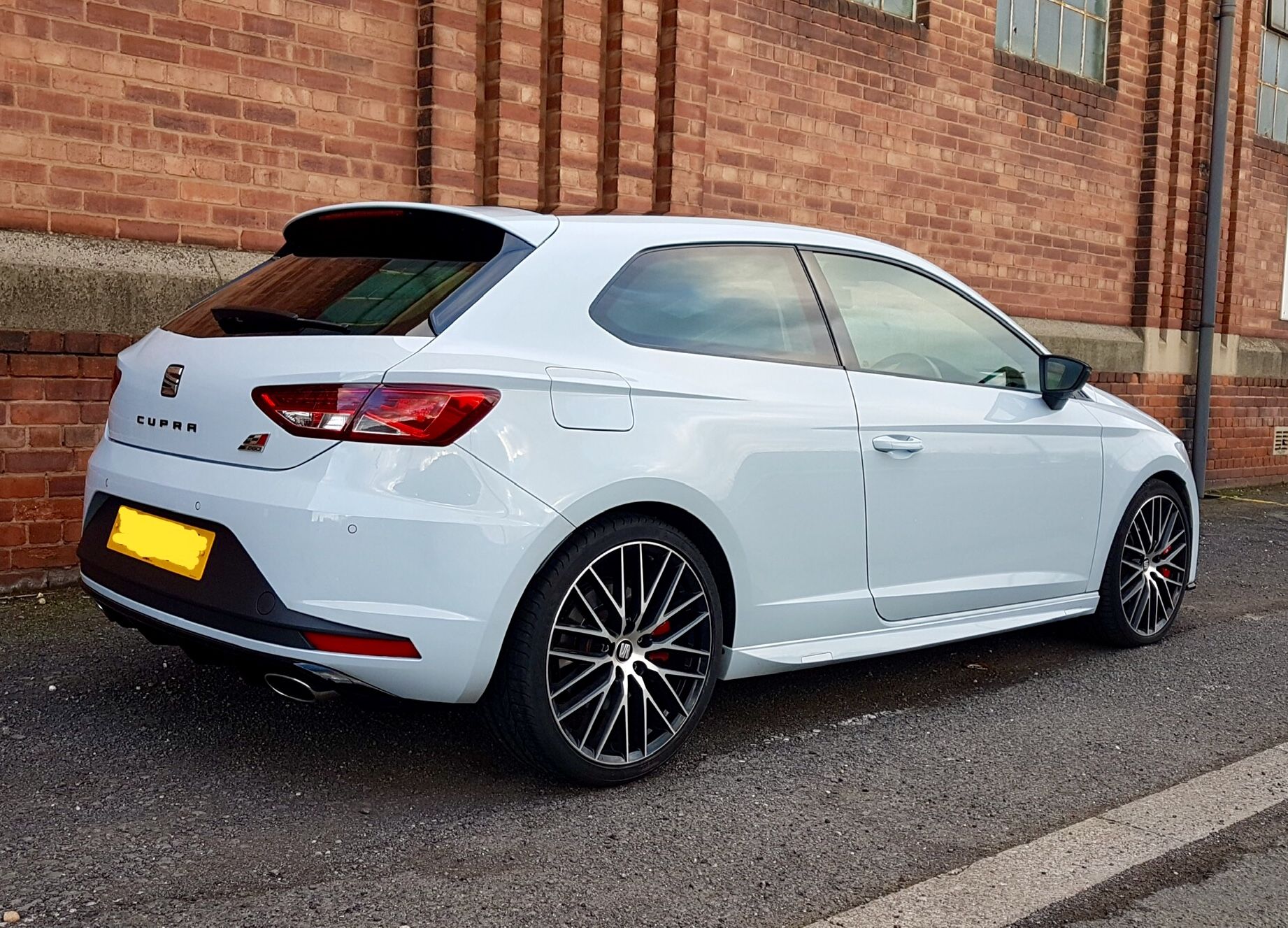

Yeah I found the rear diffuser a pain in the ass to install especially as I done it myself, the instructions are a waste of time. But I have to say the final finish is awesome. View attachment 4634
Now have a black Cupra and boot badge.
