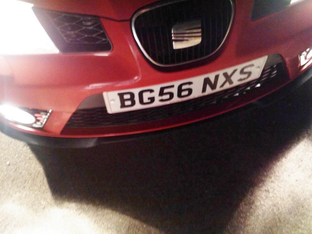

Ok its on, and i think it looks alot better now than i thought it was, just need a bit of black sealent which will fill the gap which i'll get on friday and its 100% done,

was it hard to fit??
looks really good btw!!:D
cheers mate,
not especially, just time consuming for me as it was the first time i had attempted anything like this.
You need:
  • 12-15 self tappers (i used 25mm 8g, but if done again i would use 20mm 8g)
  • hack saw (easier to cut the splitter)
  • masking tape
  • screwdriver :p
  • small hand drill
  • and power sander (completely optional)
Then:
  • Chop down the centre V's so they are in line with the rest of the splitter, i personally sanded down the little tabs where you fix the screws to so it fits flusher to the bumper
  • ran a long strip of masking tape from the badge downwards and stuck it to the middle of the splitter to ensure it was a central as i could get it
  • held it in place with a load more tape
  • used a small hand drill to prep the holes through the splitter and bumper (ensure its smaller than the screws used)
  • screwed everything in place
  • chopped off the ends
  • now i want to seal it with a bit of black sealent to fill the gaps in between the splitter and bumper
theres a very good guide in the FAQ's which i used for referance
