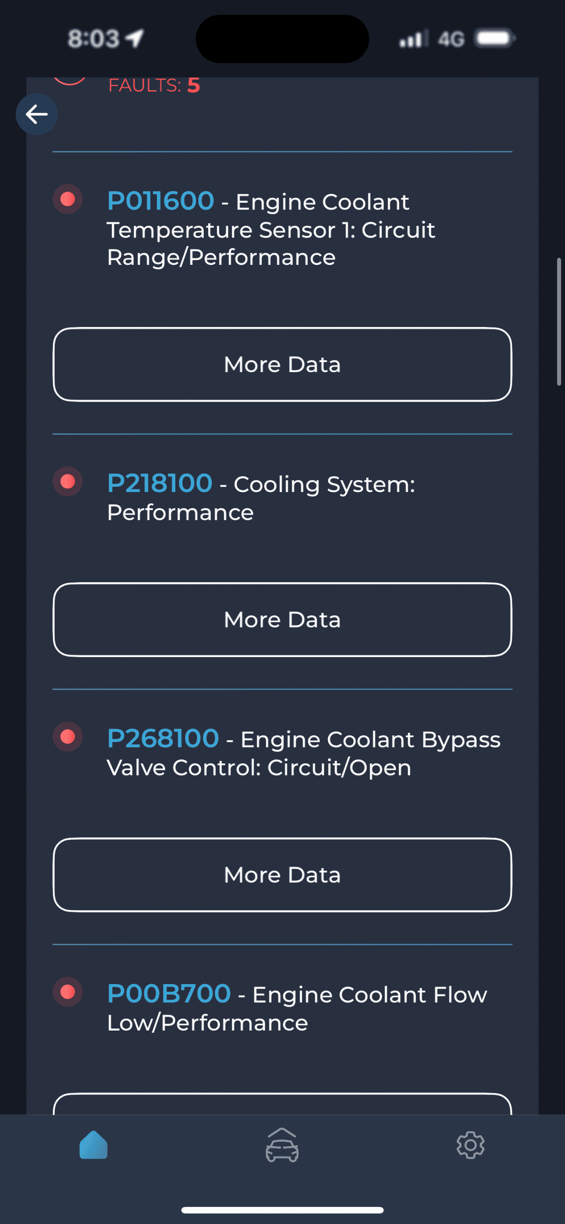

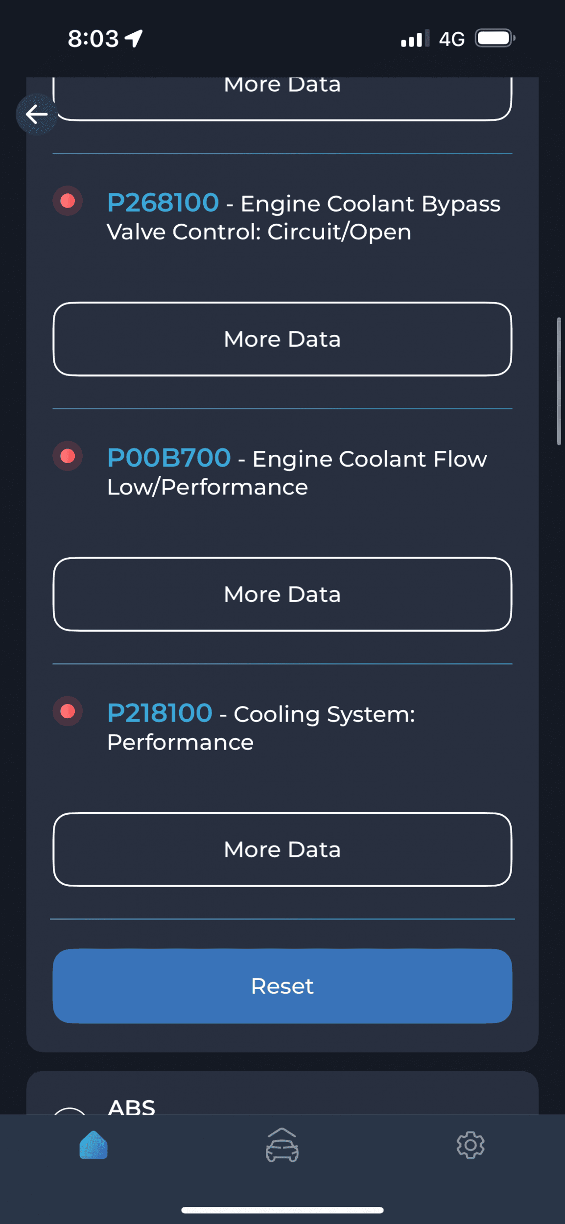

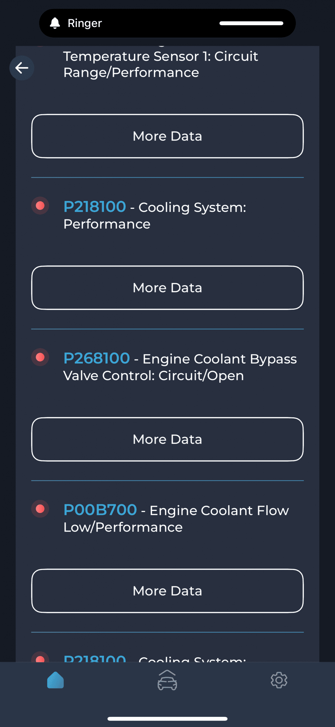

Hi guys, I recently had a fault with my car ( 2014 leon cupra 280) which was a P261800 coolant bypass fault which decided to disappear one day but as I was driving to work I’ve noticed the EML light has came on and the coolant temp isn’t moving I’m guessing the thermostats gone? I’ve attached the codes

Right so I’ve had the water pump and thermostat replaced as it wasn’t too bad for me being in the parts trade and all faults have cleared, coolant temps are showing again and running perfectly I’ve stripped the old pump and the pcb that controls the thermostat was soaked in coolant however interstingly it seems to be the original unit as the water pump was plastic too not metal so I’m surprised it’s lasted this long as the cars on 97k miles
